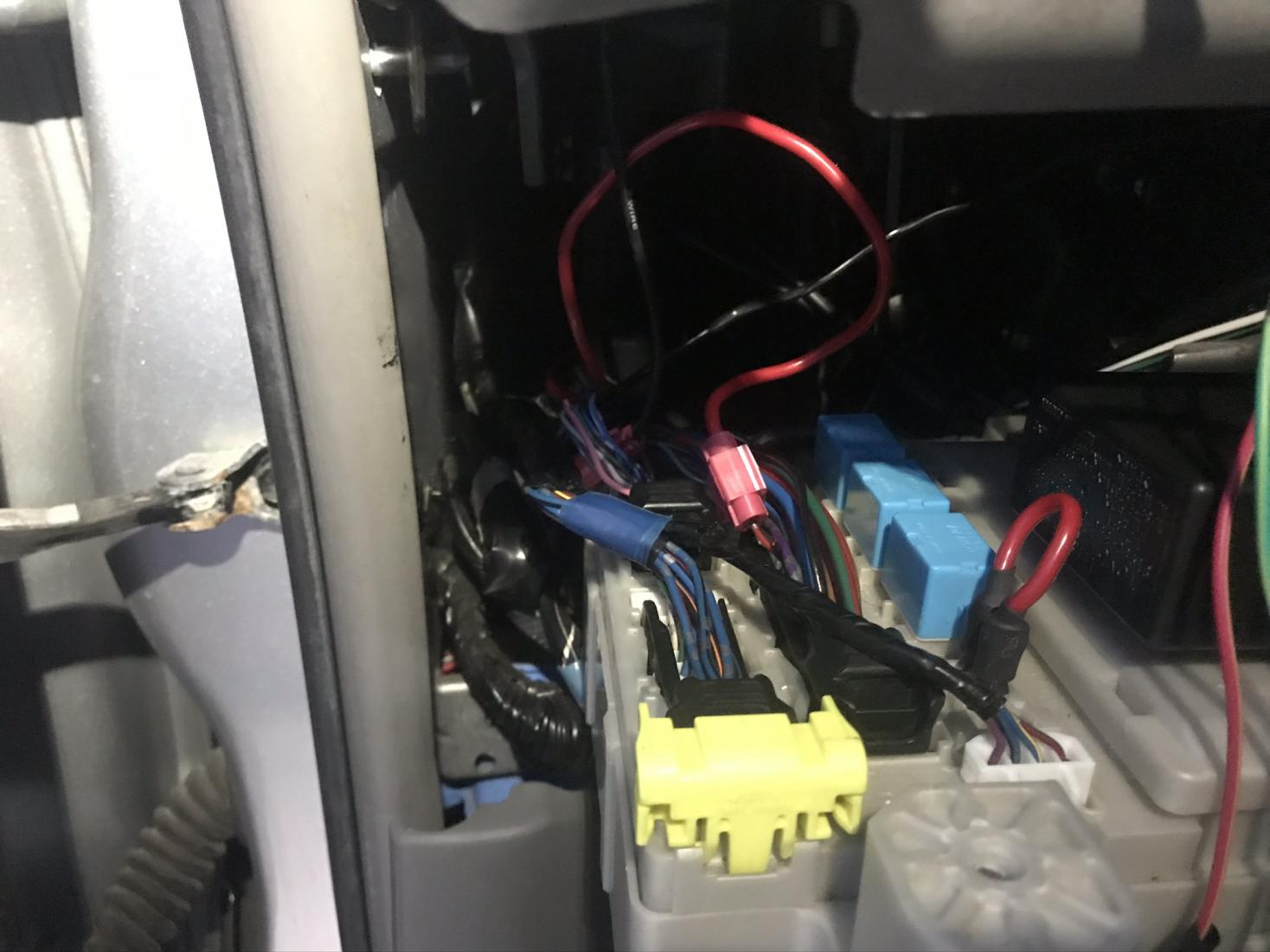

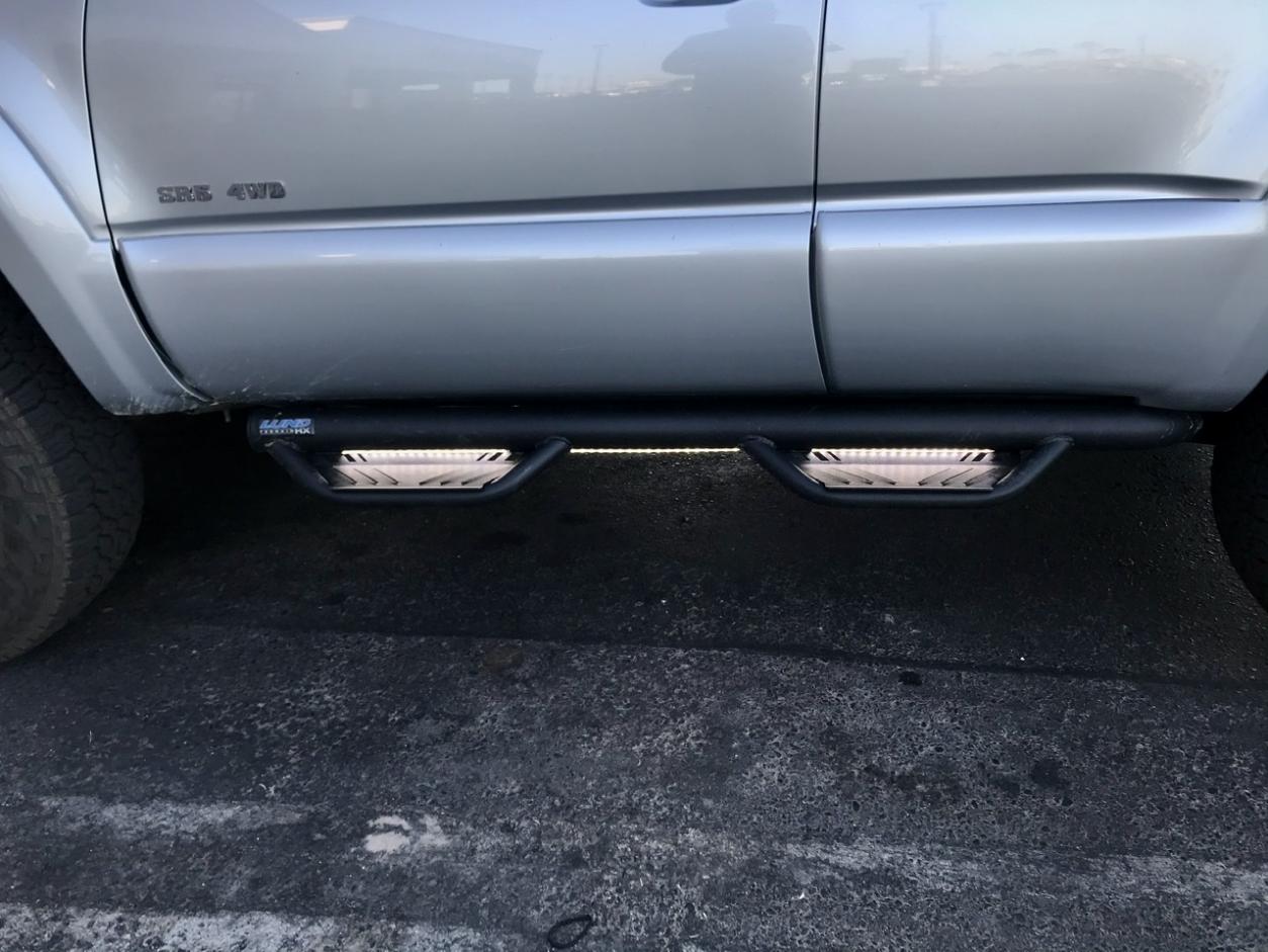

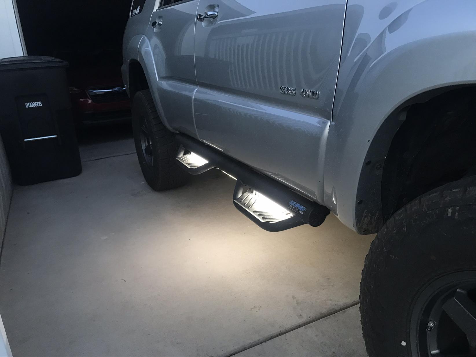

-Finished up my courtesy step lighting. I added led strip lighting to my tube steps and one underneath that I tied in to go on/off with the door or keyless remote (same as the inside lights do). I used the footwell mod. Instructions and ran the wires from there. I plan on doing the footwell mod. addition at some point. I didn’t add a 3 way switch as I didn’t think I’d want them, but think I may add some soon, just need to figure out where to put them as I’m out of space.
I just did all these in one shot since they all require the disassembly. Super happy with it. Just a note..... don’t listen to your Neighbor when he tell you to just ground the ground to the frame ground. Otherwise you’ll realize after it’s all back together that the trigger must actually be the ground as the lights won’t turn off unless you push lock..... AND then you’ll have to do it twice :wow:
Those step lights are bright. What did you use for them?

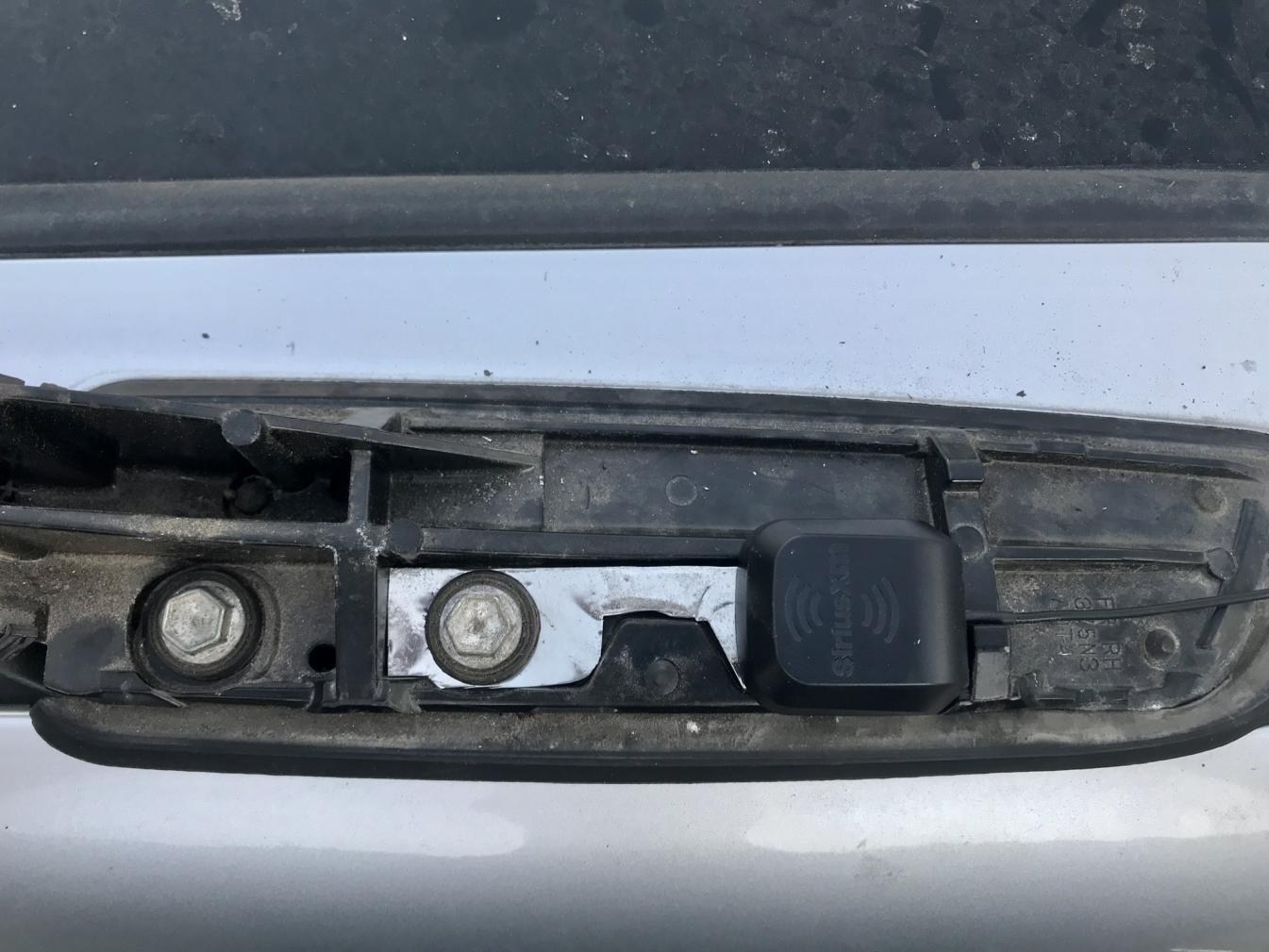

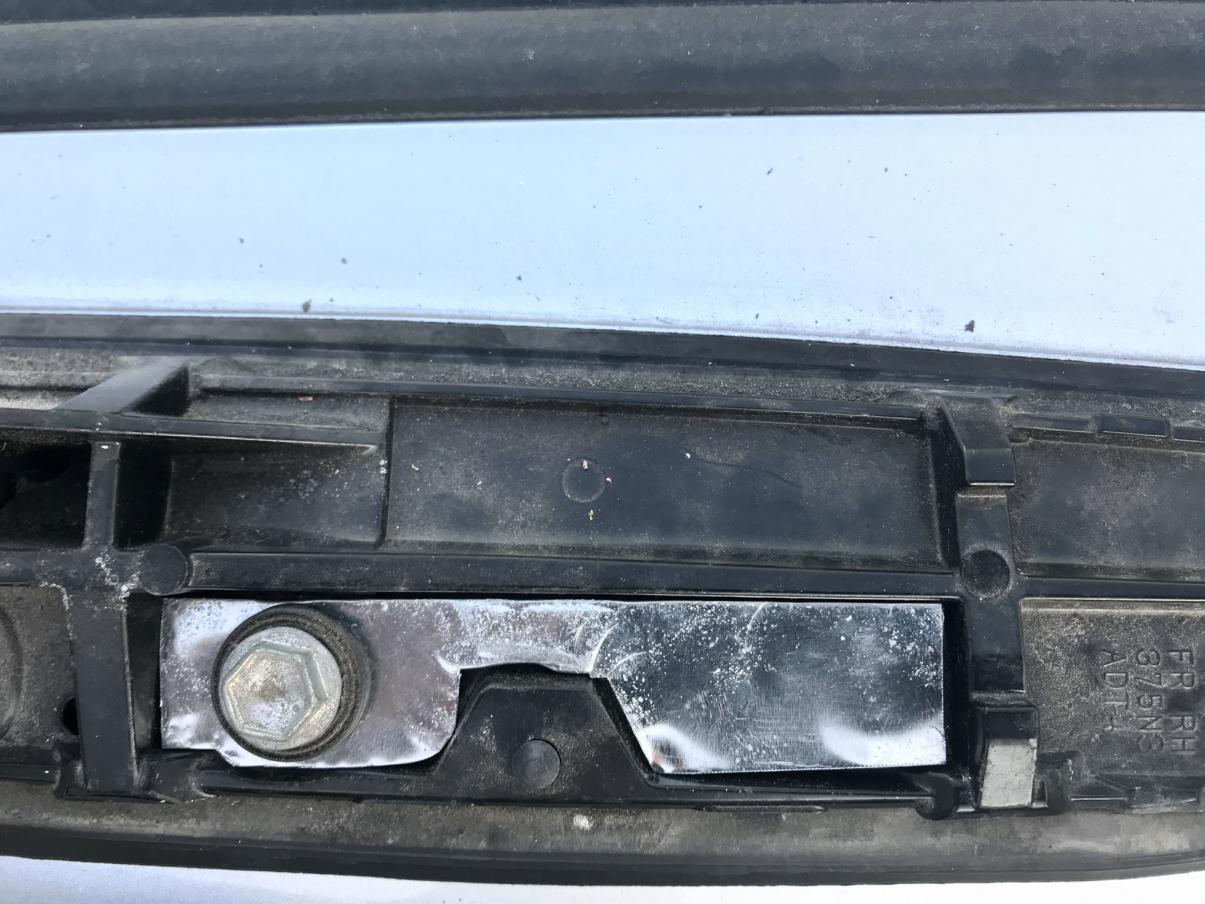

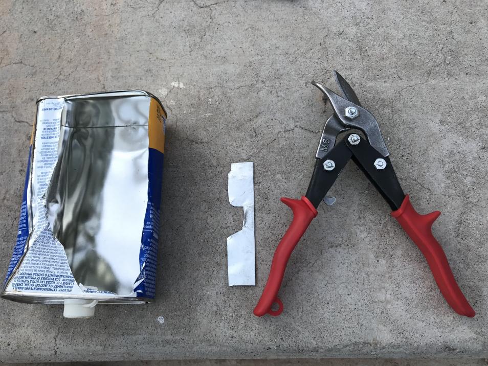

Installed my Sirius XM hidden antenna. Could have drilled a hole and dropped it down through the bottom and made it completely hidden but barely noticeable as is so I guess it will do. Only listened for a couple hours but reception seems great so far.
Tore into it and couldn’t find my piece of thin sheet metal so had to get a little creative lol. Magnet sticks just fine.
