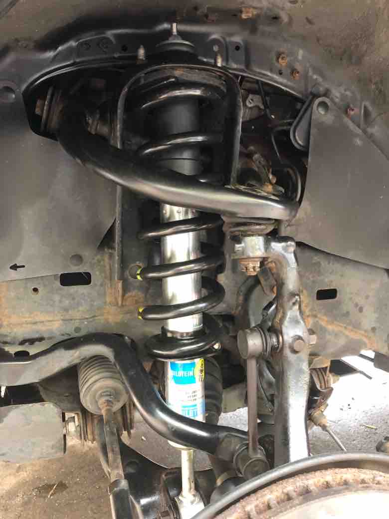

Deleted the XREAS and put in some 5100s with FJ coils in the front to help level the stance a bit. IMG_3766.jpg

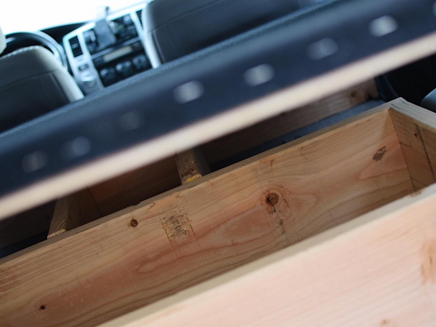

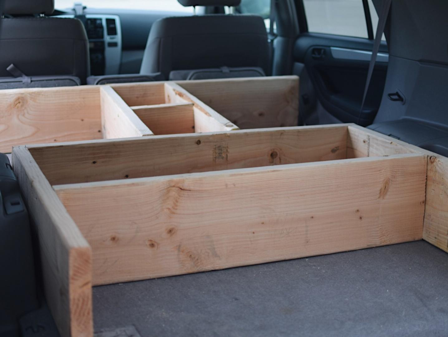

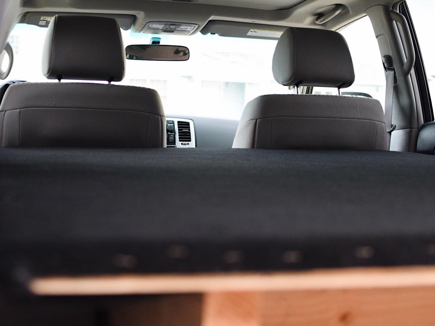

Buddy of mine and I built a barebones sleeping platform for the 4runner this morning. Took around an hour and some change because I had to make a trip to the store for extra screws and spray adhesive. 3 parts total, (2 lower structures and 1 top piece) I originally had planned for the top piece to come together by hinges that way removal would be easier but I figured this will do just fine for an upcoming weekend camping trip with my wife. All that’s left is to sand and stain the lower members.

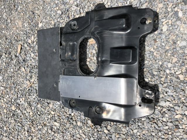

Day two of maintenance-O-rama. Finished up the install of the new Whiteline lca bushings and lower ball joints with a quick drive around the block and a re-torque of everything. Rotated the tires. Checked all the fluids in the diffs and t-case. Greased both drive shafts.. Re-tapped the skid plate bolt holes and replaced the hardware. Re-enforced the mid skid where it was hit hard right under the front diff last time out wheeling. This repair will have to do because new skid plates aren’t in the budget right now. Alignment scheduled for tomorrow morning. Enjoy what’s left of you weekend folks.
3/16” Aluminium plate reinforcement.
