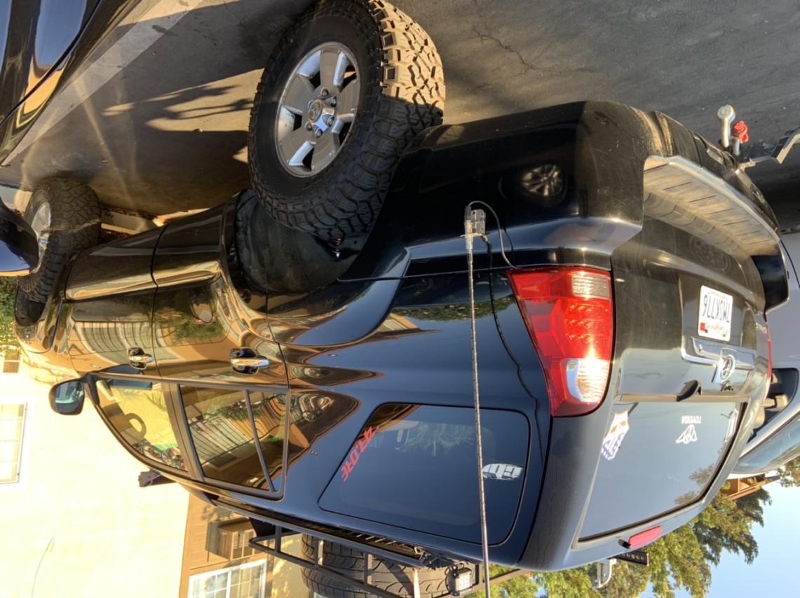

Replaced my rear sway bar links
Sorry for the pic I can’t seem to get it right

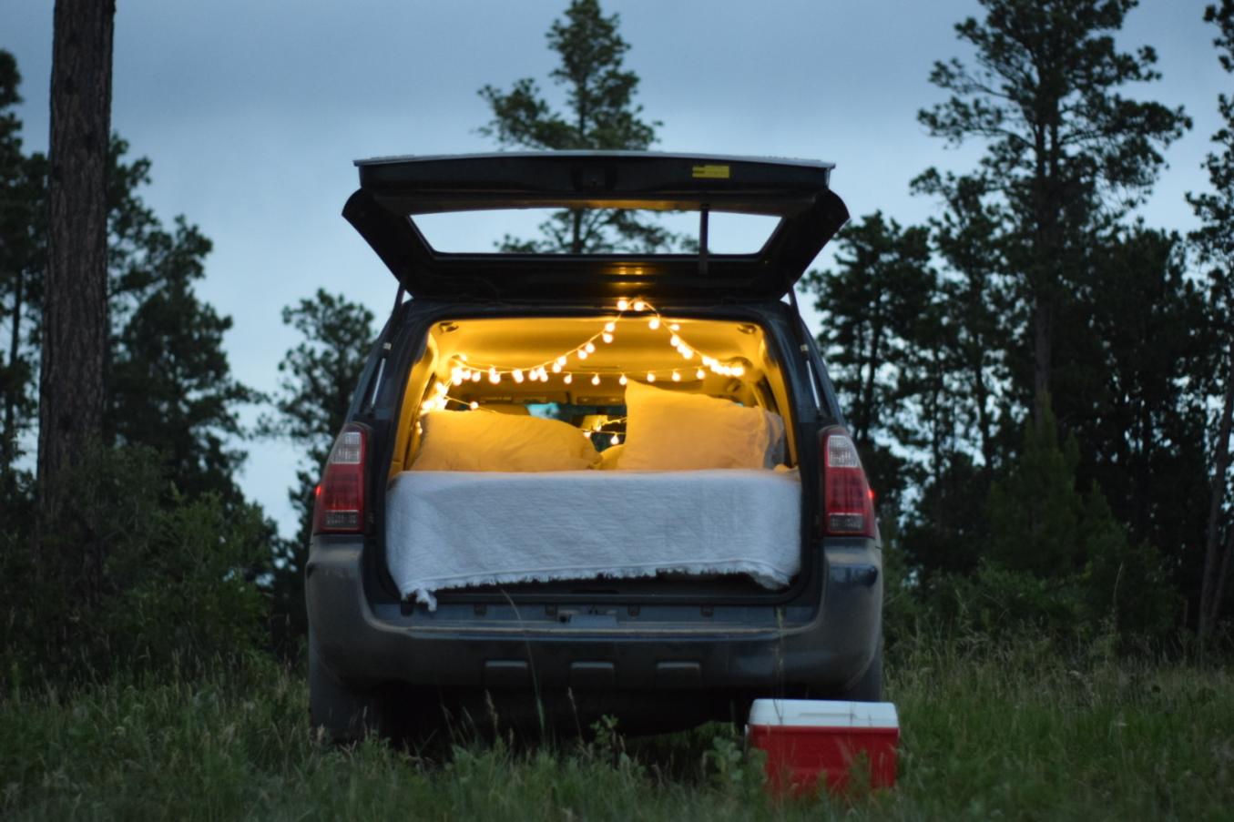

Camping
Tested out the simple sleeping platform I built last week in Teddy Roosevelt National Park (South Unit) & Black Hills National Forest via dispersed camping. Got to visit Devil’s Tower in Wyoming and swim at Keyhole State Park.

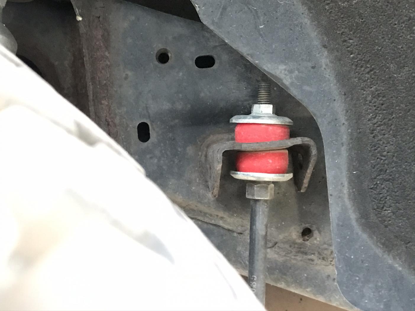

Are you sure there isn’t a stop or the threads hanging up on the through hole not letting the bottom bushing compress? That’s a pretty good rearward angle it’s at and doesn’t look centered. I can’t imagine them not compressing close to evenly. Do both driver and passenger sides look the same?
Here’s mine, I tightened them and both compressed evenly. These are the polyurethane energy bushings which look shorter than yours’. I only used the 2 washers mine came with. Moog 2nd gen rear links. I had to cut mine off as well, we actually pulled the whole sway bar out to cut on a table, much easier. I was replacing my sway bar bushings with energy poly anyways so two birds there.
