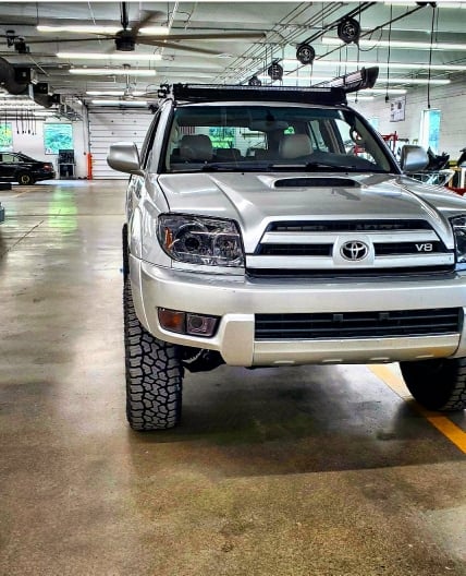

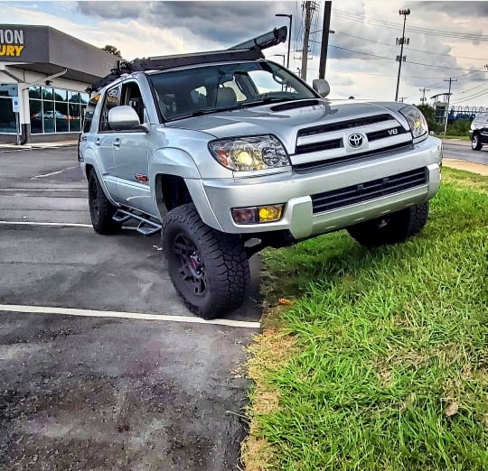

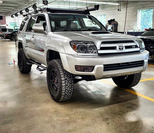

Finally got it aligned after the lift,, installed spidetrax, installed the awning and did the acme h1 super projector retrofit

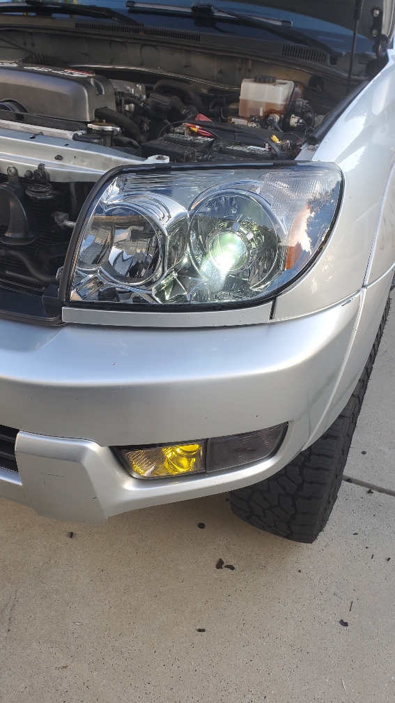

I like that retrofit! Is there a thread detailing it somewhere?
Thanks man, good looking car! What spots lights are you running?
Also, for the 295 I can't believe you were able to even drive it without cutting down the mudflaps a bit. I went ahead and trimmed my entire back arch into a uniform radius just to make sure I dont have any issues. The only downside is that now I am having to come up with a way to reattach a portion of the flap to cover the opening inside the wheel well. I would leave it, but don't want it getting packed with mud and all.
As far as the retrofit, it was fairly easy to do and I kind of followed this that I found, which is how I learned about the cheaper ACME kit vs some of the more expensive ones:
HID Projector Retrofit: 2003 Toyota 4Runner (Part 1) - The Track Ahead
HID Projector Retrofit: 2003 Toyota 4Runner (Part 2) - The Track Ahead
Me being me, I didn't quite read through the entire thing and decided I would jump right in. Long story short, instead of enlarging the hole to sit the projector deeper in (giving you enough thread on the back side to tighten the nut down, I cut down the flange on the back of the housing because my threads didn't come up far enough to get the nut started. This also gave me the appearance of the projector floating out a bit more in the housing which I kind of liked.
I also did not JB weld the shroud to the projector. The shroud that came with the kit had holes that lined up with the projector so what I did was thread them with an M3 thread and used some small screws I had laying around to fasten it. Figured if I wanted to take it apart later for whatever reason I would have the ability to. The wiring was really straight forward.
If I wasn't in a rush to get it done quick and get the lights back in (bc I can be super impatient) I could have done the whole process start to finish in 3-4 hours. I had to bake one light open again because my projector twisted during installation and I didn't realize it and was off by a good 35 degrees.
I am still working on getting them aimed correctly but for 2 hours of work and around 200 bucks it was definitely worth it for me.
