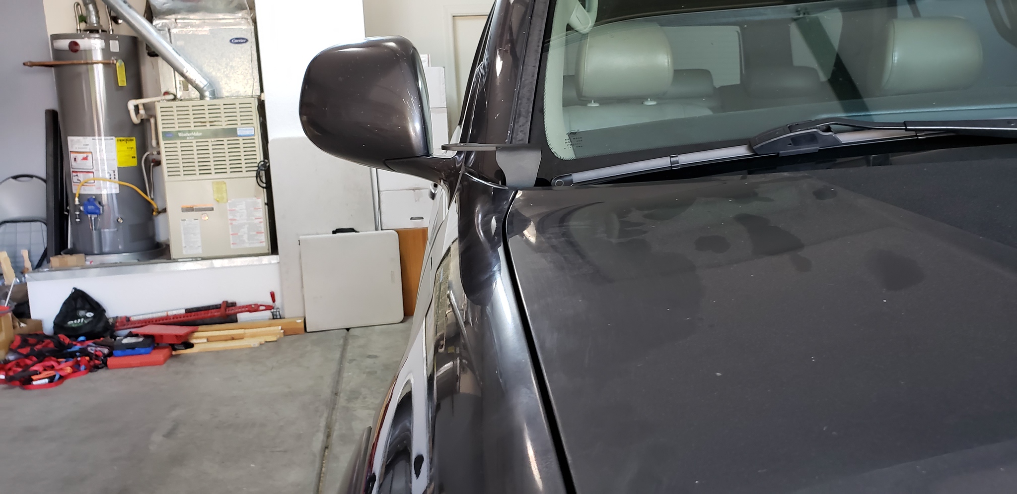

Also yesterday. Installed the CBI passenger side ditch light bracket that I'm going to use for my CB antenna.

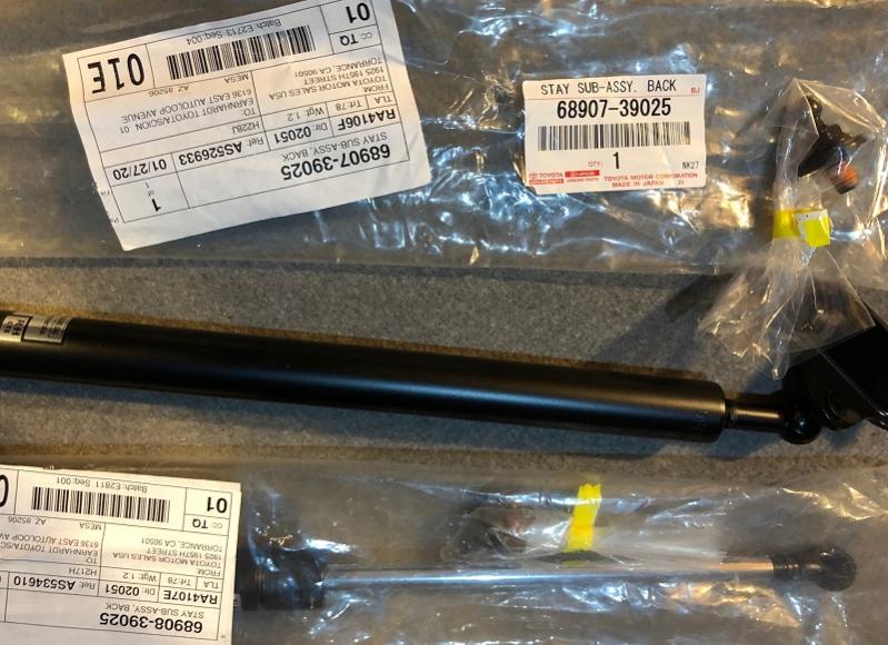

Installed new OEM rear hatch lift supports, they're the cold spec but they seem to work fine in the heat we're having.
Edit: 100 bucks to my door all the way from Earnhardt Toyota in Mesa; the local dealer here is a joke.

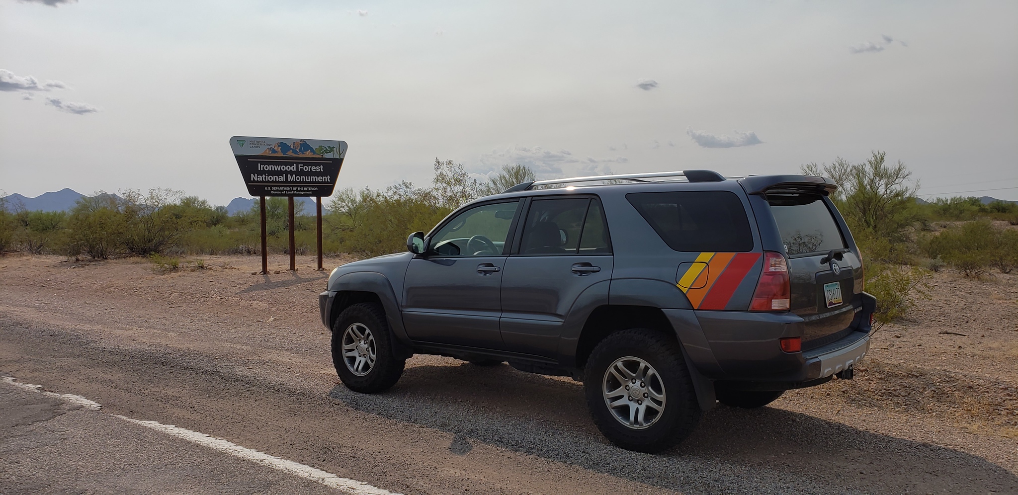

Put some vintage style TRD stickers on it, removed the lettering from the doors and went for a casual drive down some dirt roads.
