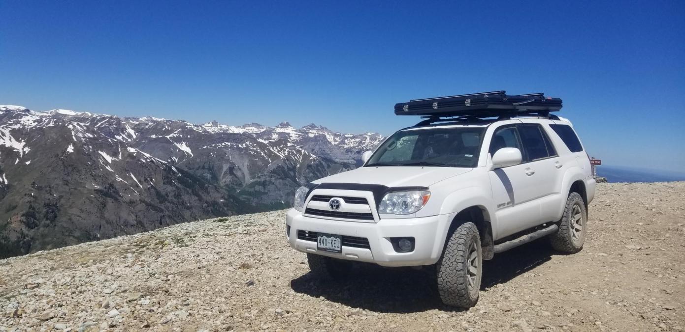

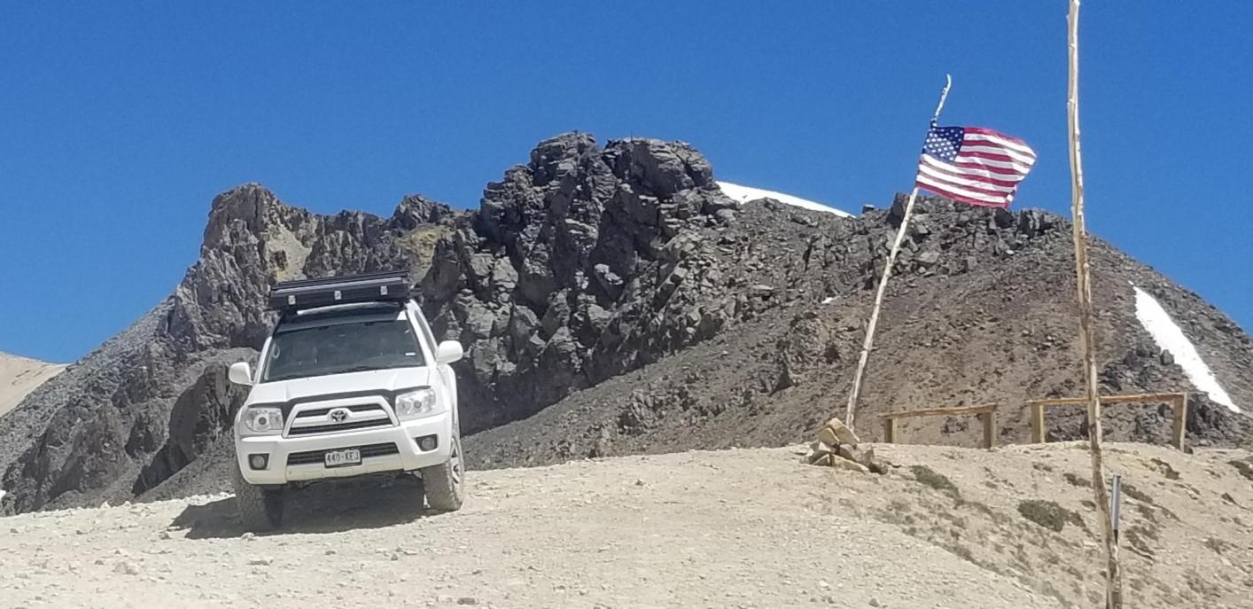

Engeer Pass
Long 3 day camping weekend with my GF, which included a run from Silverton to Lake City. My 4runner performed flawlessly and I was impressed with my new KO2s

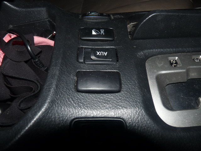

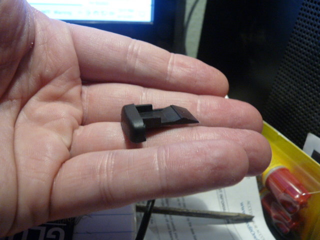

Aux jack rellocation
So was getting tired of the aux jack and Monster Cable for the mp3 player cutting out. Then it just died. So removed the button slot cover between the heated seat controllers and DAC button. Cut the end of the cover, so that the clip that snaps in is left. Used E-6000 adhesive to hold both pieces in (strong enough it aint goin nowhere, but you could still remove it without destroying anything). Just left the old jack in place, to cover the hole. Cable from the harness is long enough, but you cant lift the console/shifter cover up as far. Jack fits tight and flush.

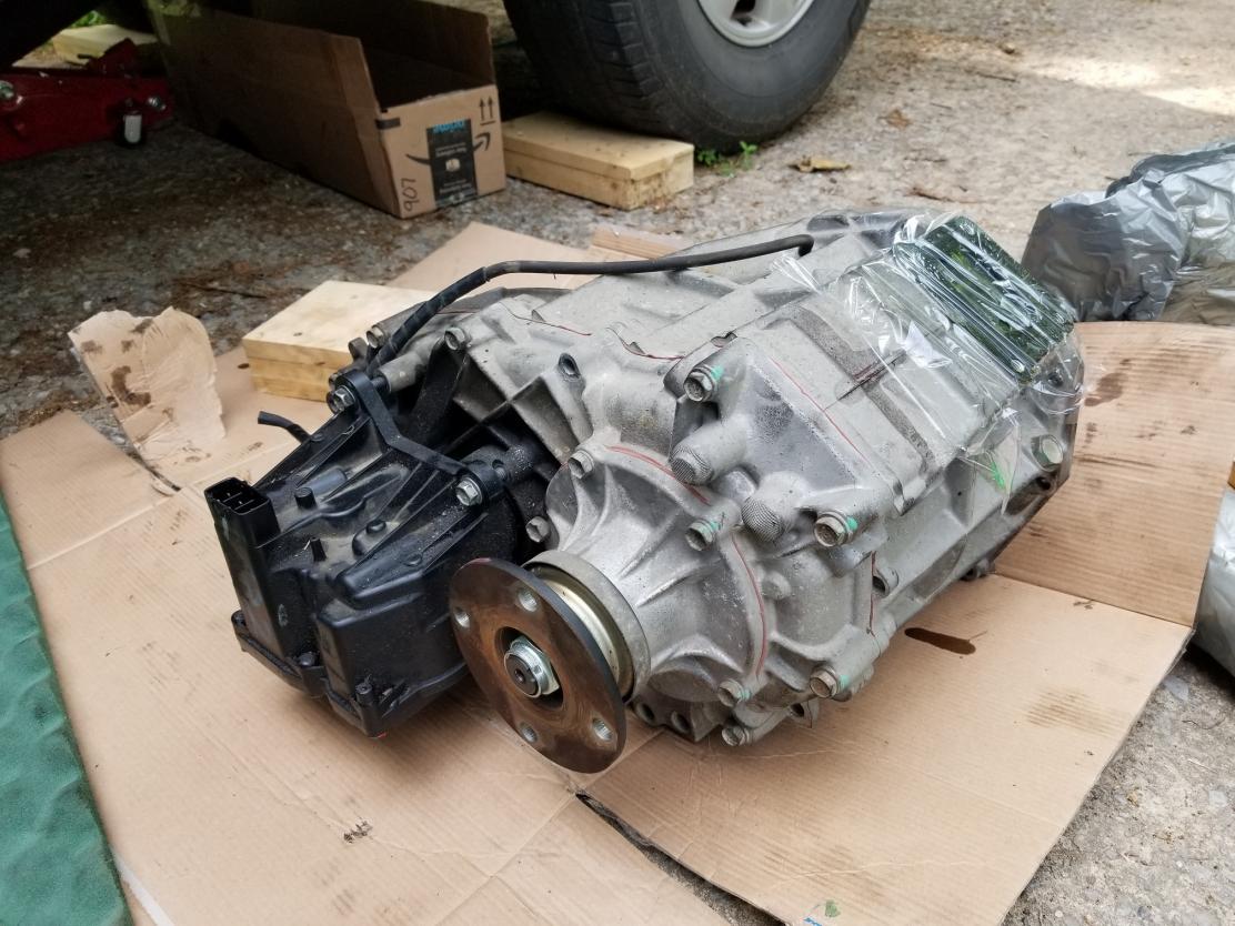

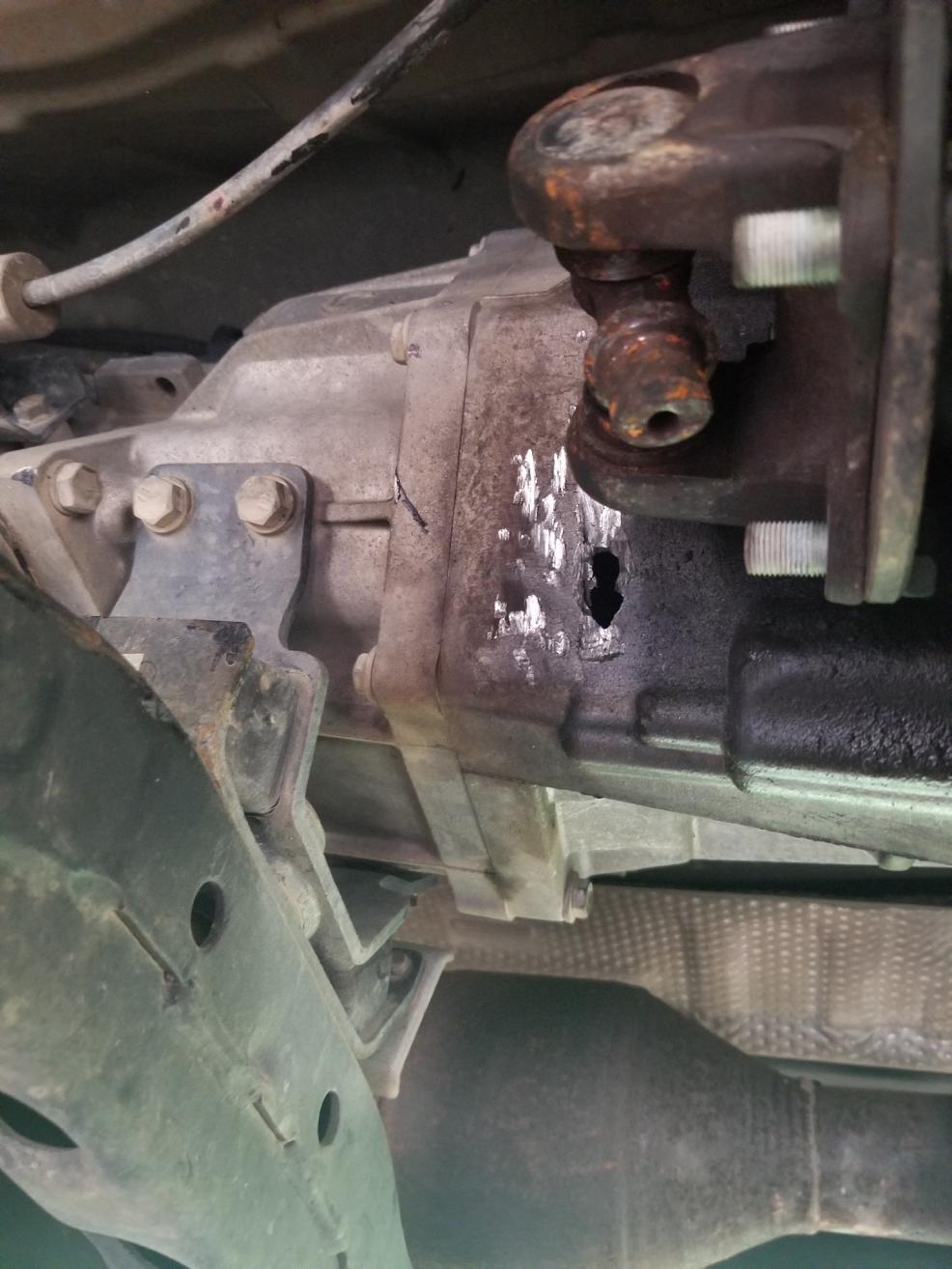

Dropped the t-case. Got a used one to replace. Old one had a hole knocked into the side of it after the front driveshaft broke loose.
I got the 4Runner from my neighbor. Replacing the t-case, new driveshafts, new headlight assemblies, new windshield, and a bunch of little stuff like dash lights, hood struts, new stereo and speakers all around, etc.
Once I get the t-case back in it's going for a timing belt, I'm not going to try and tackle that one since I can't get it in the garage.

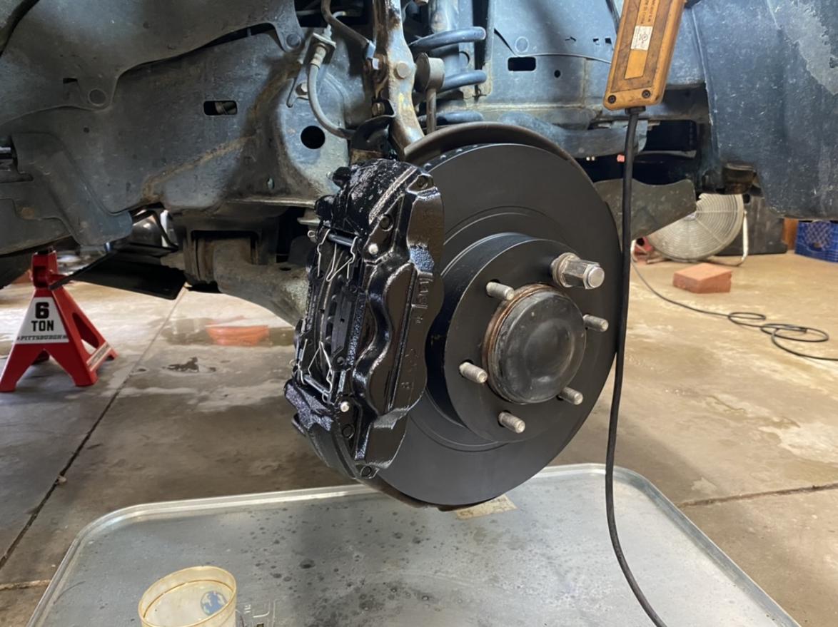

I was able to get a couple things done that desperately needed to be done.
Had to do a full front brake service. I had a seized caliper on the front left, so that meant everything new had to go in. Duralast calipers (for the lifetime warranty), Duralast “Elite” pads and Duralast rotors. I did not have time to order the slotted rotors I would like to have or the Powerstop pads to match the rear. No one carried these parts local and RockAuto shipping was WAY too much to have them in a day. Had to have it done over the weekend to get to work the following. Had to paint the calipers because one came finished and the other came unfinished.
Next was lower ball joints. While I was in there, new sway bar end links and bushings to the frame went in to get rid of the clunks I had going on. I went with MOOG on all these parts.

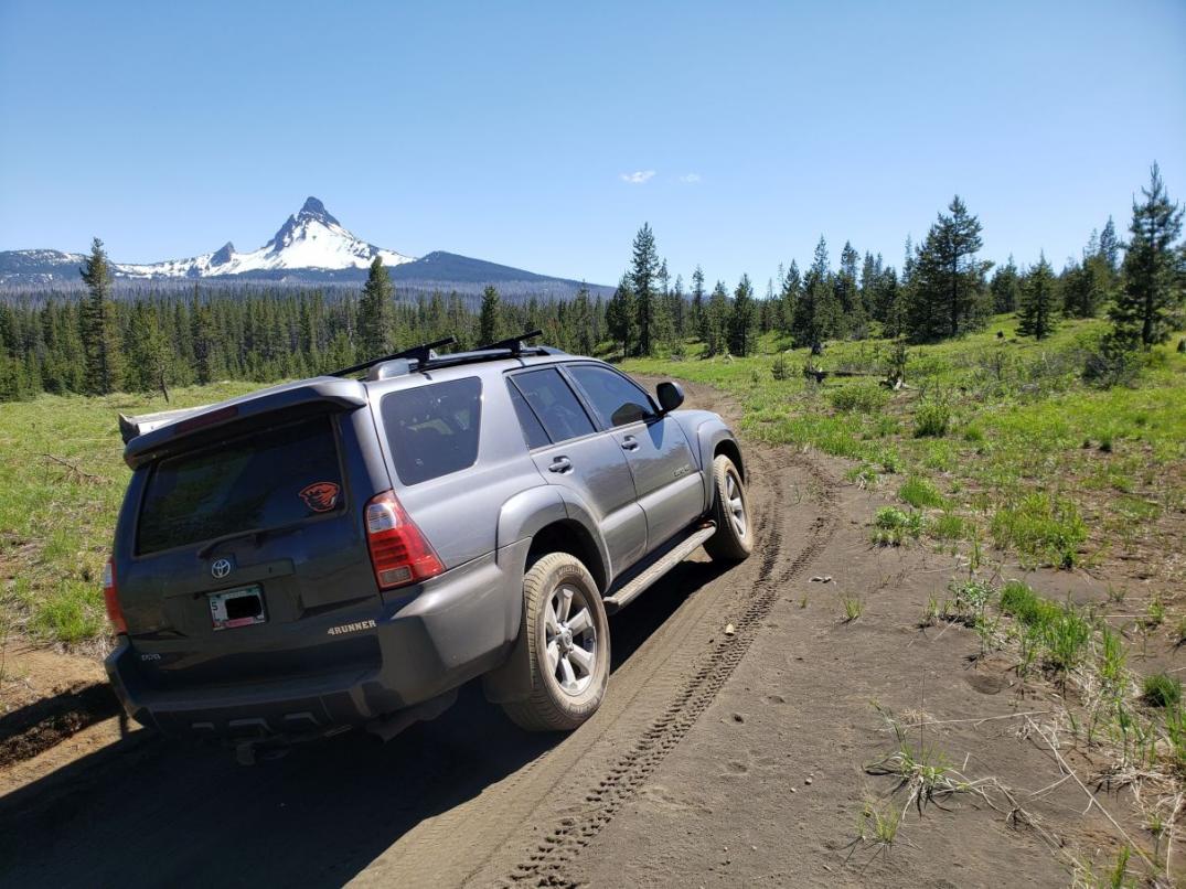

Did some exploring in Central Oregon.

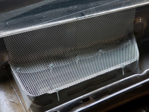

Unfortunately, on the way home, opened up the glove box to find that something had gotten into the glove box and made a nest during the trip.
Got home and replaced the cabin filter (chewed seeds and parts of a tissue)
Opened up the engine cowling and made a steel mesh covering for cabin air intake using Kwik Mesh from Home Depot.
