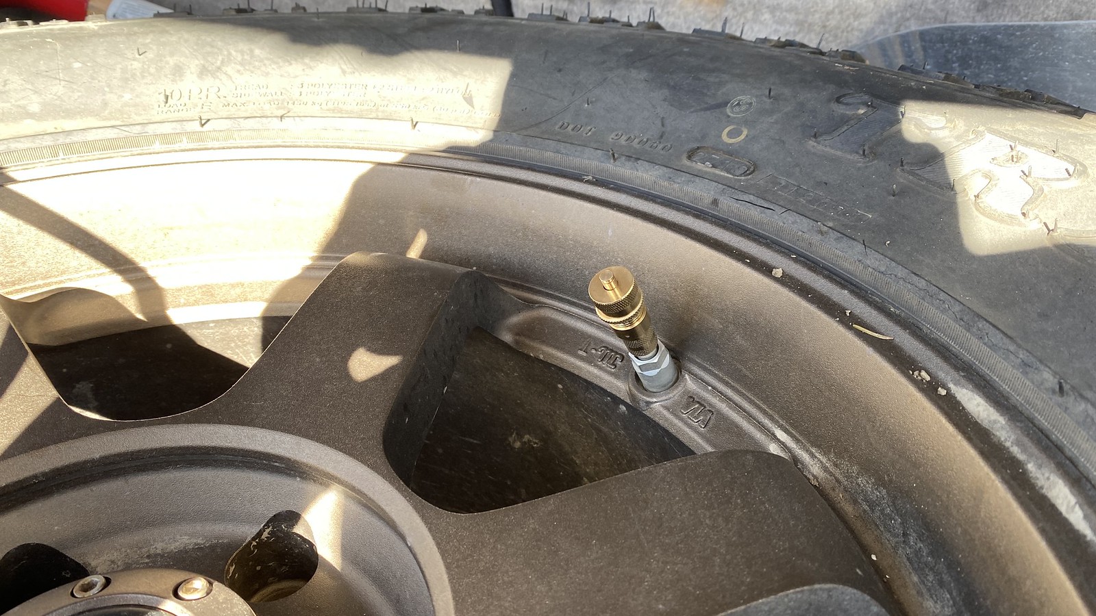

got my Staun knock-offs in the mail today, so I used my spare to set them to 13-14lbs. ready for quick air-down at the next run!
