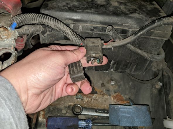

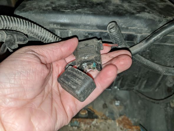

Blown Fuse- not sure what?
As its gotten colder here, I noticed my 4Runner was taking longer to start so assumed I would be replacing the battery soon. Today, the battery light came on and I eventually couldn't get it to start. I tested the battery with a multimeter and it had low voltage coming out, and without much other thought I jumped it and went to buy a new one. After a few hours driving around I started having trouble again so at that point assumed an issue with the alternator. Battery had already drained below 10V. Tried pulling the alternator to get it tested but had some bolts I couldn't get to budge. I then noticed a fuse in the middle of a cable that went from the positive terminal up to possibly the starter? I'm not sure what this is and so far haven't been successful searching for it online. Can someone please help me identify it? I'm not sure if it would be related to my issues but I assume it needs replaced either way. This is a 2007 SR5. My wife's car is having electrical issues right now as well so we are vehicle-less at the moment, fun times!
That is an aftermarket item. See where it traces to.
Do you have a multimeter? Once an engine is running, voltage at the battery terminals should read ~14V to indicate a good alternator.
Thank you - I came to that realization a little bit ago also (aftermarket) after seeing where the wire goes into the cabin. Not sure what it would have been for though, nothing about the vehicle seems aftermarket. I charged battery up to 12.6V, turned the engine on and that dropped down to 12.0V. Will work more on getting the alternator out tomorrow.

[QUOTE="shmitty15, post: 3695334, member: 688783"]Thank you - I came to that realization a little bit ago also (aftermarket) after seeing where the wire goes into the cabin. Not sure what it would have been for though, nothing about the vehicle seems aftermarket. I charged battery up to 12.6V, turned the engine on and that dropped down to 12.0V. Will work more on getting the alternator out tomorrow.[/QUOTE]
Sounds like an alternator. You can typically rebuild with just a brush kit but that's up to you.
