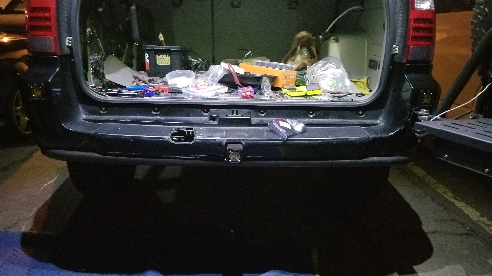

Waayyyyyyy too bright! Had to turn down my screen brightness to look! ;)

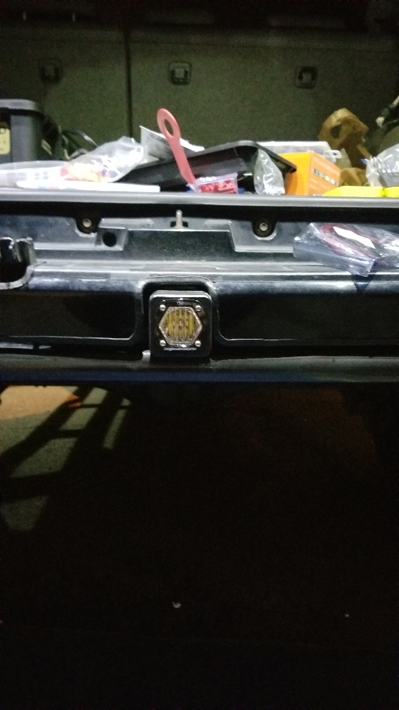

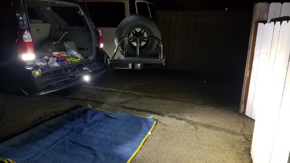

Wired em up today. The s1's are pretty bright for how small they are. Just need to swap out switches tomorrow so I can put into oem slot and zip tie harness to frame and such. I see am S pod type of thing in the future, would love to tidy up my wiring.

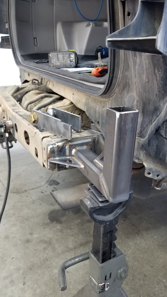

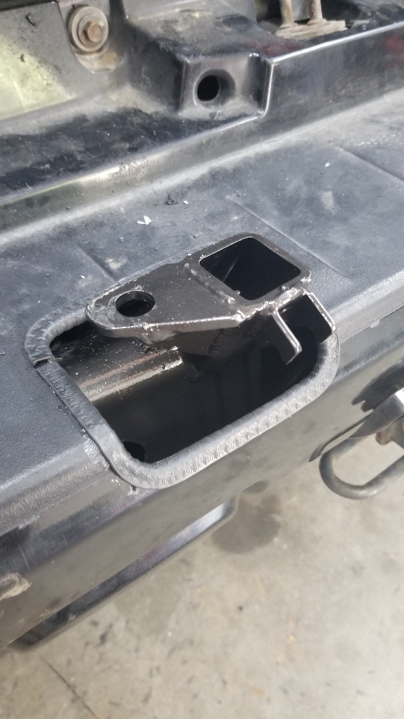

Yeah I wanted to get rid of the low hanging hitch, ended up notching into the cross member and placing a new hitch in it.
wired new switch into oem slot and re routed the harness more properly today. Done with that project, next is back up camera in spoiler.
Mounted up the bd s1s. Just need to wire em up now. If I needed to extend harness, what guage wire should I use? Thanks in advance guys.

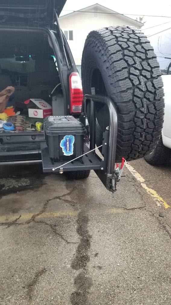

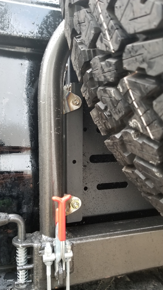

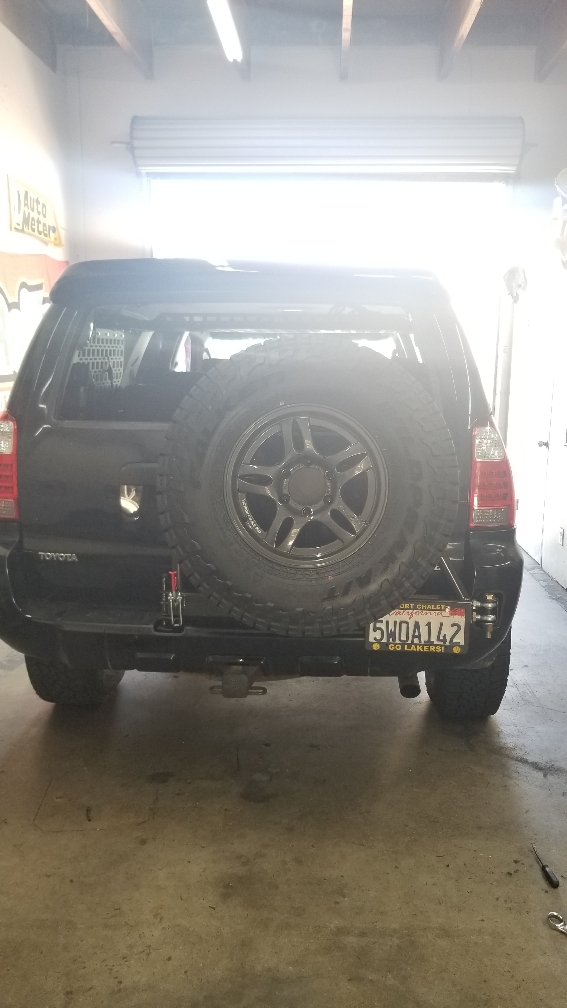

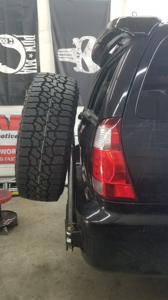

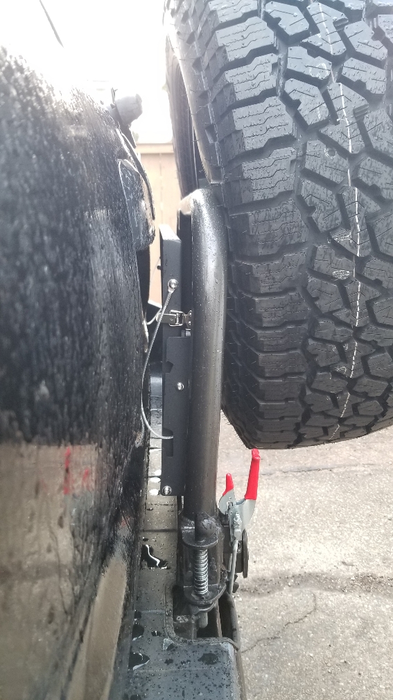

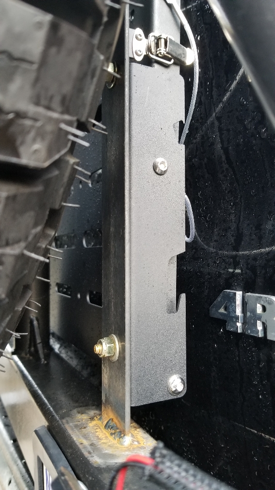

Would definitely like to see more on how you tied that tire carrier in behind the stock plastic pieces. I don’t think I’ll ever have a spare tire back there but I always like seeing how other people build things. Semi jealous of how high your hitch is but I like that I still have towing capability lol

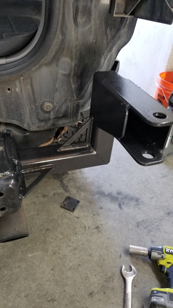

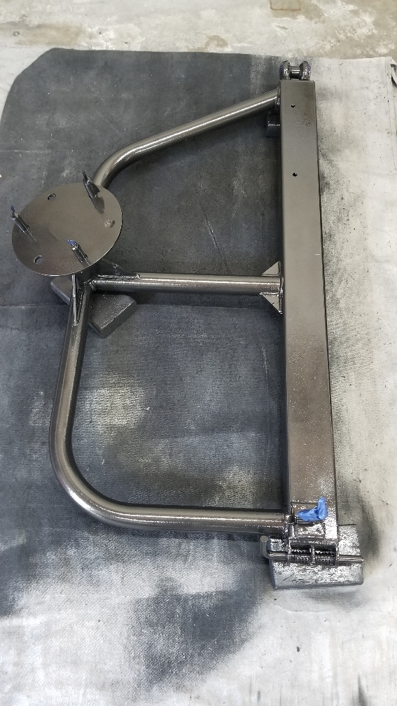

Haha ask and you shall receive. Yeah I don't plan on any towing. Most likely just for my bike rack/bicycles.
These are when I got the swing installed. Since then I have upgraded heims when I got the rear bumper done.
Sent from my SM-G955U using Tapatalk

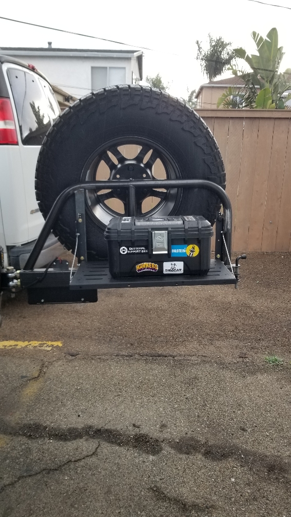

^ I'm getting a table mounted to the swingout tomorrow afternoon. I am more excited for that haha. Will post pics tomorrow when I get it done.

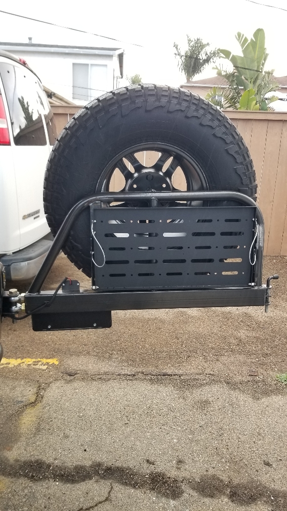

This looks awesome. Love how simple and minimal it is. Would you ever consider selling a kit?
The weather was too crazy in SD today and I wasn't able to paint like I wanted to. But ended up installing the meso customs hitchpod with another baja s1 since it came in today. Just waiting on the locking hitch pin to come in to complete it. Install was really simple. Like 10 mins tops. I'm pretty happy with how it turned out.

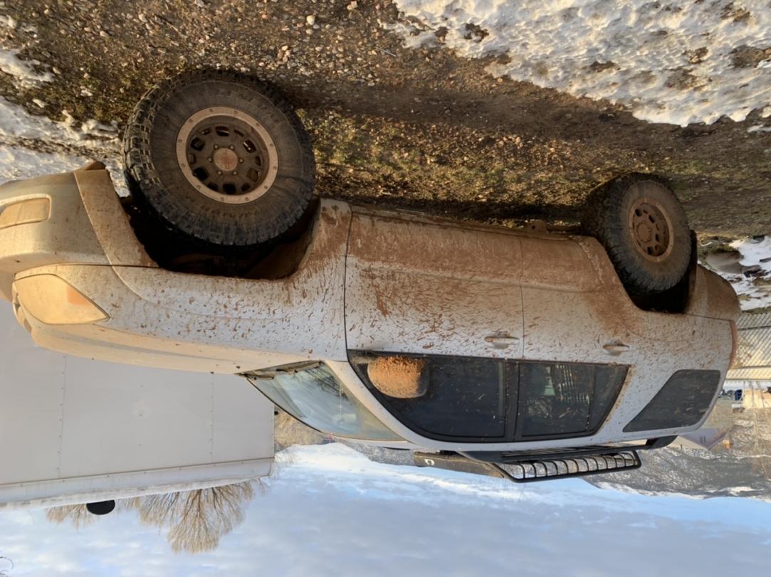

Went out and did the Poverty Gulch trail near Mt. Carmel Junction just outside Zion NP. Got into some snow a lot of mud a little sand and some rocks towards the bottom near the East Fork of the Virgin River. At least it’s consistent 3 of 3 upside down whoop!
