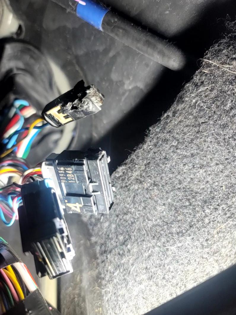

Chased a burning smell
Tried to figure out where I can get this diode from for my 21 limited . My rear lights aren't working hoping this fixes that issue
