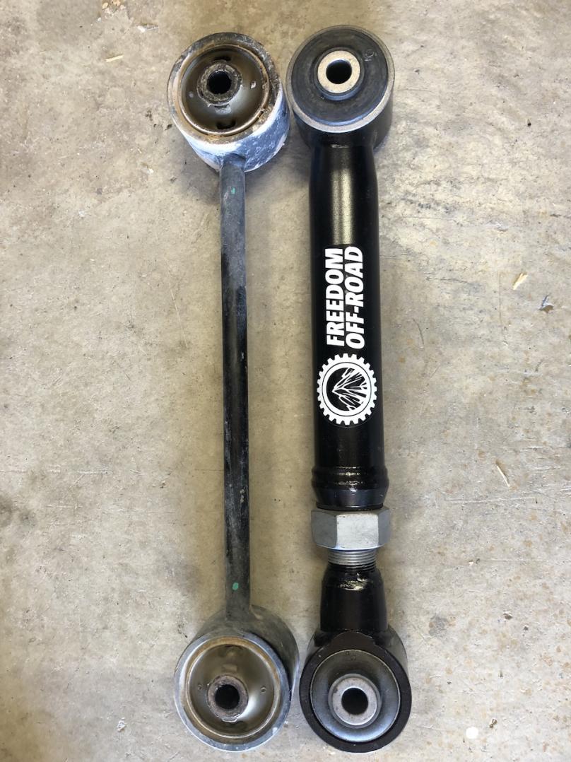

Replaced the rear upper control arms with a set of adjustable Freedom Offroad. Seem pretty good. We’ll see how they do.

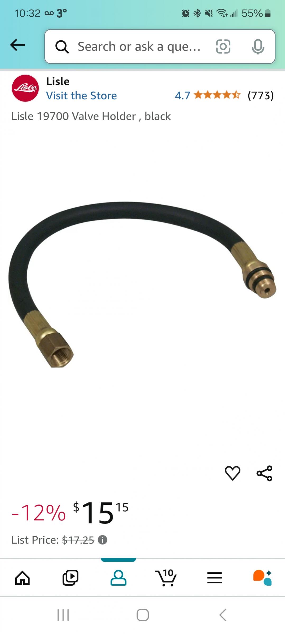

Yeah, that's a deep dive! Glad to hear it went well. Did you leave the heads on and if so, how keep valves in place as seal changed?
Yep, heads stayed on! I put the piston for the cylinder i was working on to TDC and used this Lisle tool with my air compressor to pressurize the cylinder and keep the valves from dropping. Had to buy a bigger air compressor as my 8gal wasn't enough for the job, but still saved thousands doing it myself.

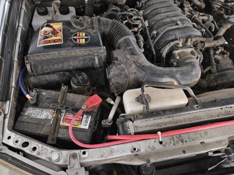

I stole the second battery and isolator from my FJ and put it in the T4R. I made a new windshield washer bracket and bought 2 new washer bottles last year in anticipation of the battery move. She's TIGHT!
