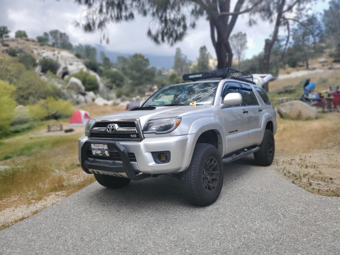

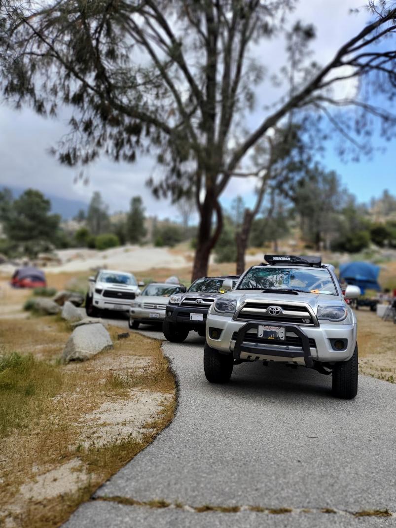

Went out to Kern River near Lake Isabella California for Easter weekend ✝️ . Had a great time with the Family. Took a few toyota fam pics .

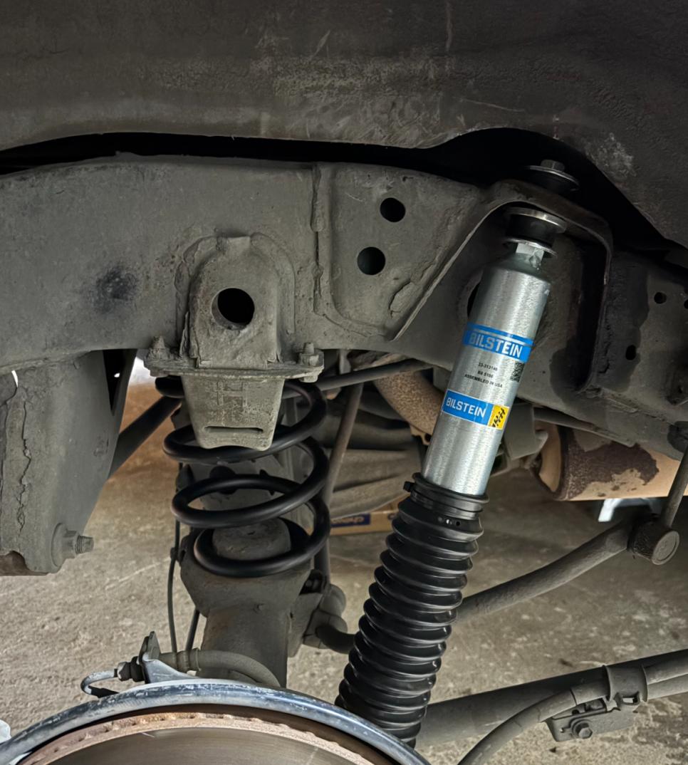

Threw some Bilstein 5100’s in, along with OME 895e for the rear. Vise grips, channel locks, and lots of PB didn’t work so reciprocating saw it is!
Tomorrow is front with 5100/883 and new KYB top hats, excited to see how everything turns out.

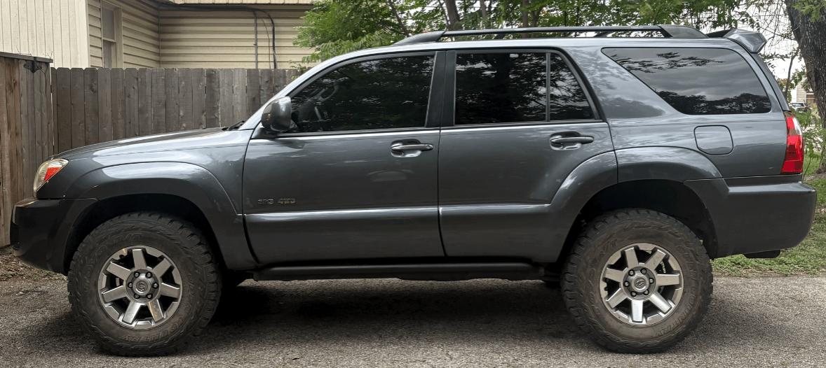

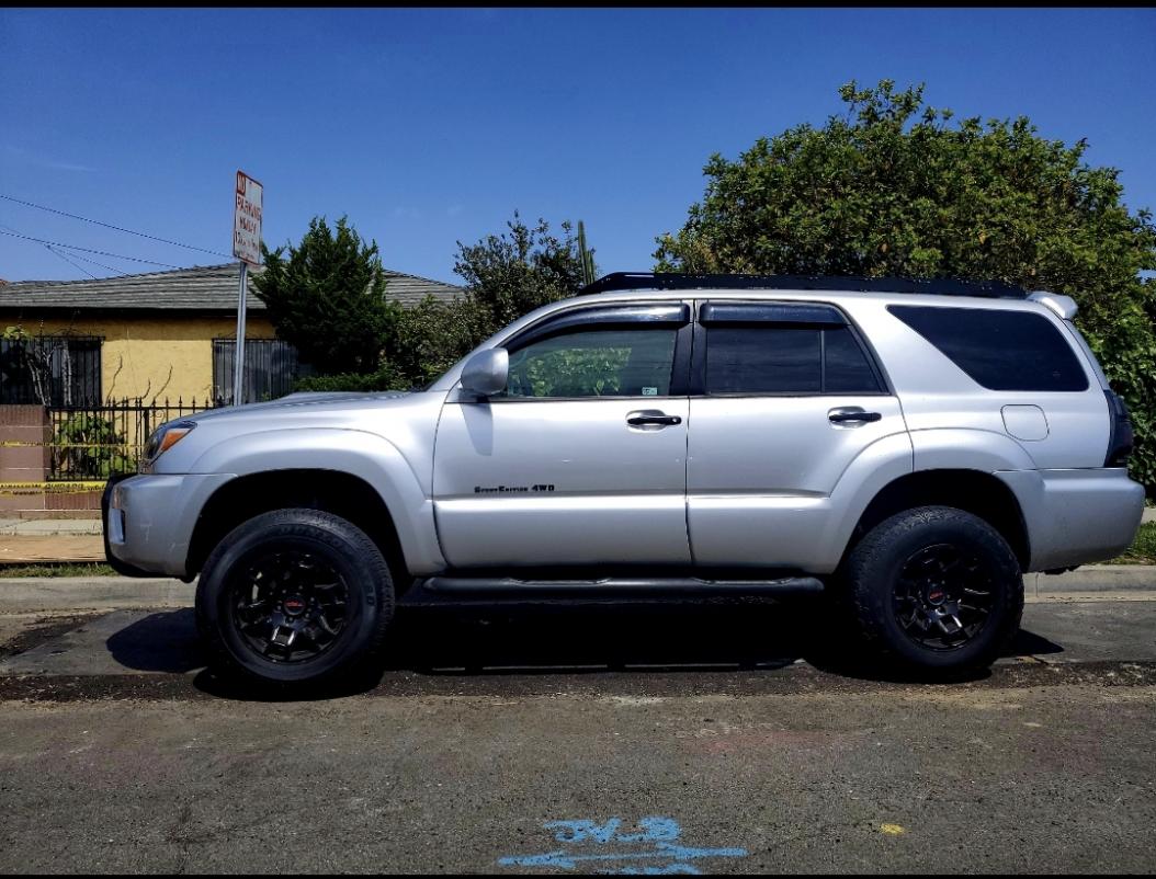

Yeah I’ll grab those measurements for you, I have the before lift specs written down somewhere ages ago.
Before: back in 2019, stock suspension with around 190,xxx miles, and some Wildpeaks AT3W.
After: 5100 with OME 883/895e, hatch with spoiler and colored matched handles. Up next are 255/80/17 AT4W, can’t wait to be back in some Falkens.

So I misplaced that notebook with the before measurements I took years ago but here are the after specs if you’re still interested. Ended getting a local set of Toyo RT in 255/80 off Marketplace.
FD: 21 1/8
FP: 21 1/4
RD: 23 1/4
RP: 23 3/8
Also before purchasing the 883’s, I did read online a lot of people who ran 884’s ended getting more lift than expected.

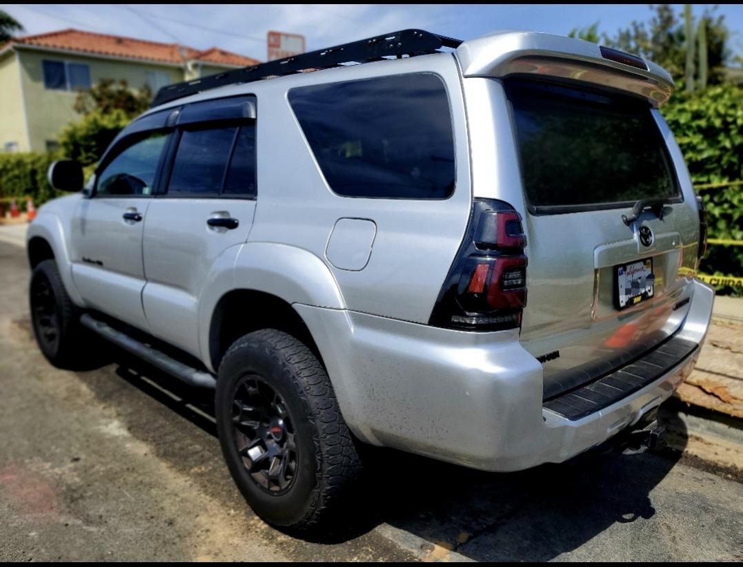

Added a prospeed roof rack. It had the front wind fairing missing so I added a prinsu wind fairing off FB marketplace from a 09 Taco... fit nicely imo
