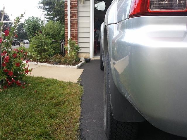

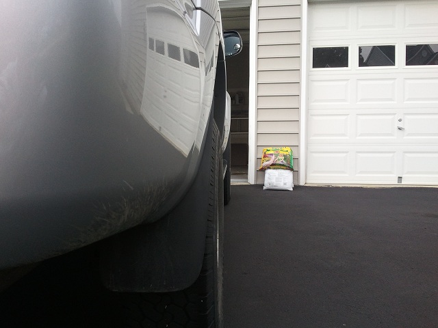

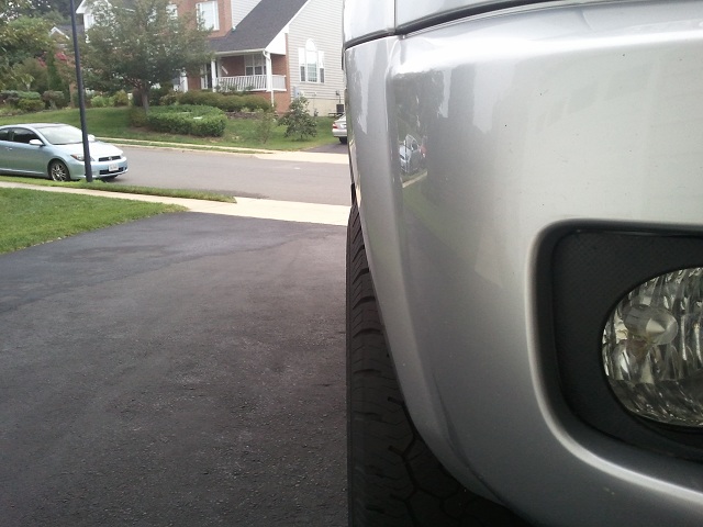

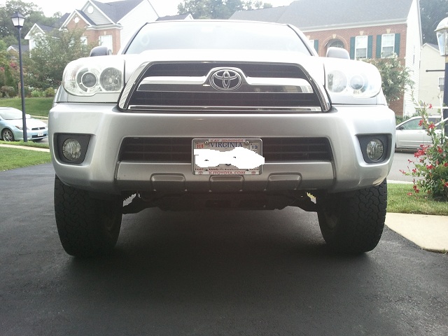

Installed Spidertrax spacers today...

Looks good! Be sure to get an alignment! I didn't and boy did I go through improperly worn tires!
Seriously? Might as well take the opportunity to set my front Bilstien coils from 0 to .85" while I'm at it then get the alignment... Thanks for the heads up emelianenkov, much appreciated! :biggrin2:
You shouldn't have to get an alignment after installing Spidertrax spacers. Installing the spacers doesn't change your camber, caster or toe.
Phew... I wasn't sure if the additional wheel base width would affect alignment. I'll leave it be for now and keep an eye on any abnormal tread wear just in case. Thanks for chiming in on this momo.75
Looks great, goastridr!
I didn't have to get an alignment after mine either.
Thanks Mytoy4, the narrow stance was a pet peeve of mine that's been pinching my nerve ever since the truck as stock every time I got outta the truck and bothered me even more so after the lift. After taking it for a short drive after the install, I did noticed it doesn't "wonder" anymore and feels more sure footed on the road now. I need to take her wheeling to see how the spidertrax holds up.
Actually I had the spidertrax, then got lifted and drove on it before getting it aligned. That was my problem haha. Disregard my previous comment
That was the first thing I did to mine as well, the way the 4R's tires are tucked under these things annoys the crap out of me. The 5th gen is even worse. It looks like you can walk up and push it over, I hate that thing!
