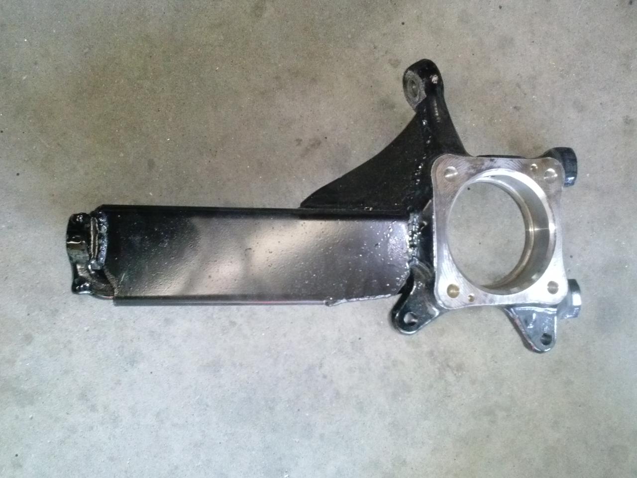

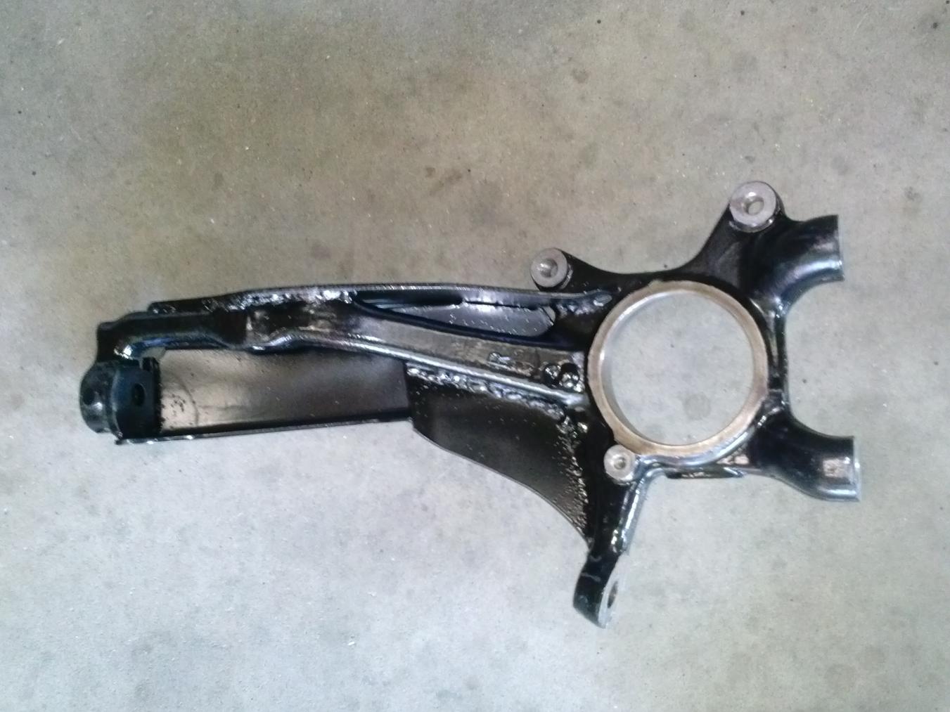

Steering knuckle gussits
I had another form member do this mod and took interest, why not I can weld. So, since I'm local enough for him, he gave me his old set to do this in exchange I give him my old set back, great, no down time.

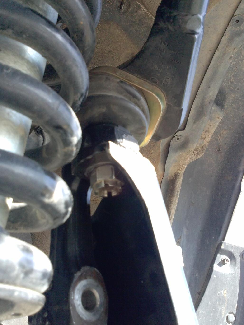

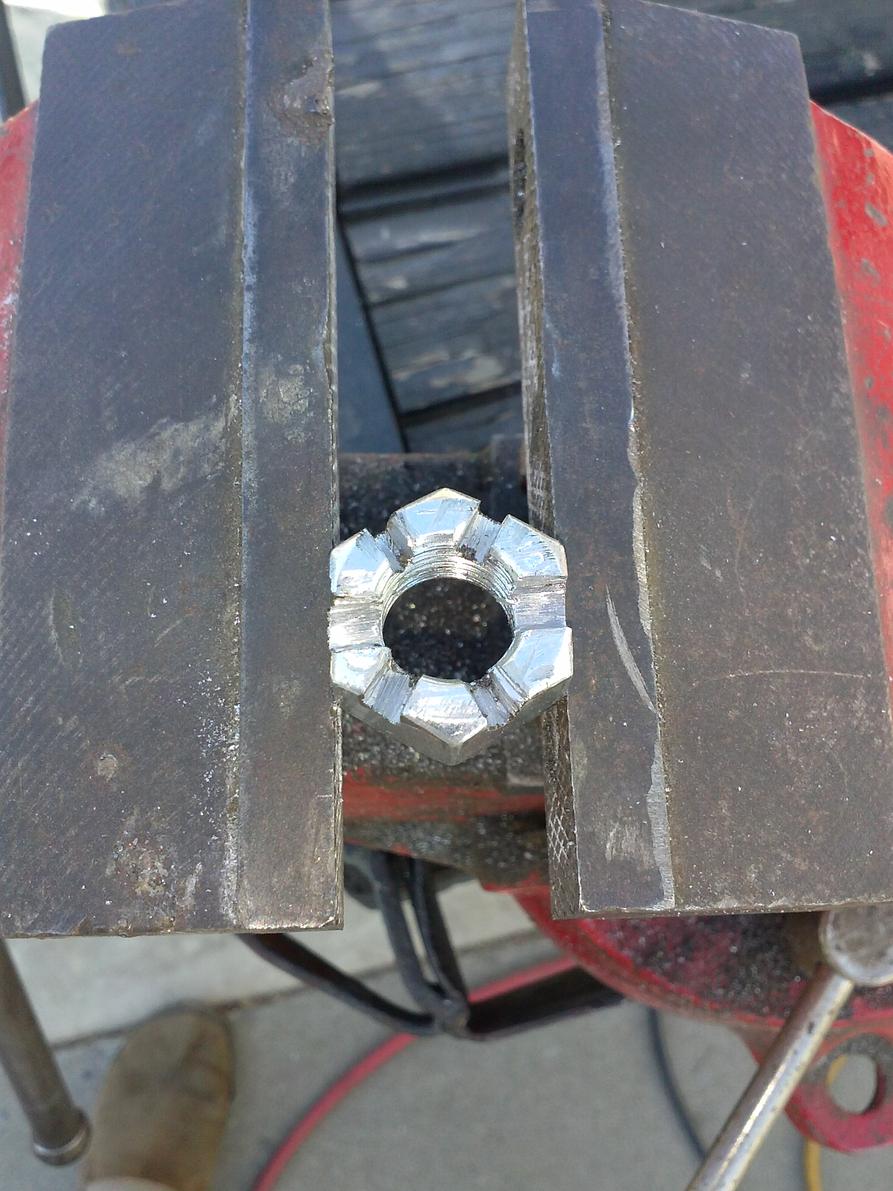

Started the install yesterday and all was going well, except for certain items not posted about using LR UCA'S, first problem, shaft not long enough to reinstall the castle nut and put the pin back in, NOT GOOD.

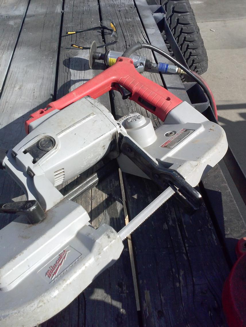

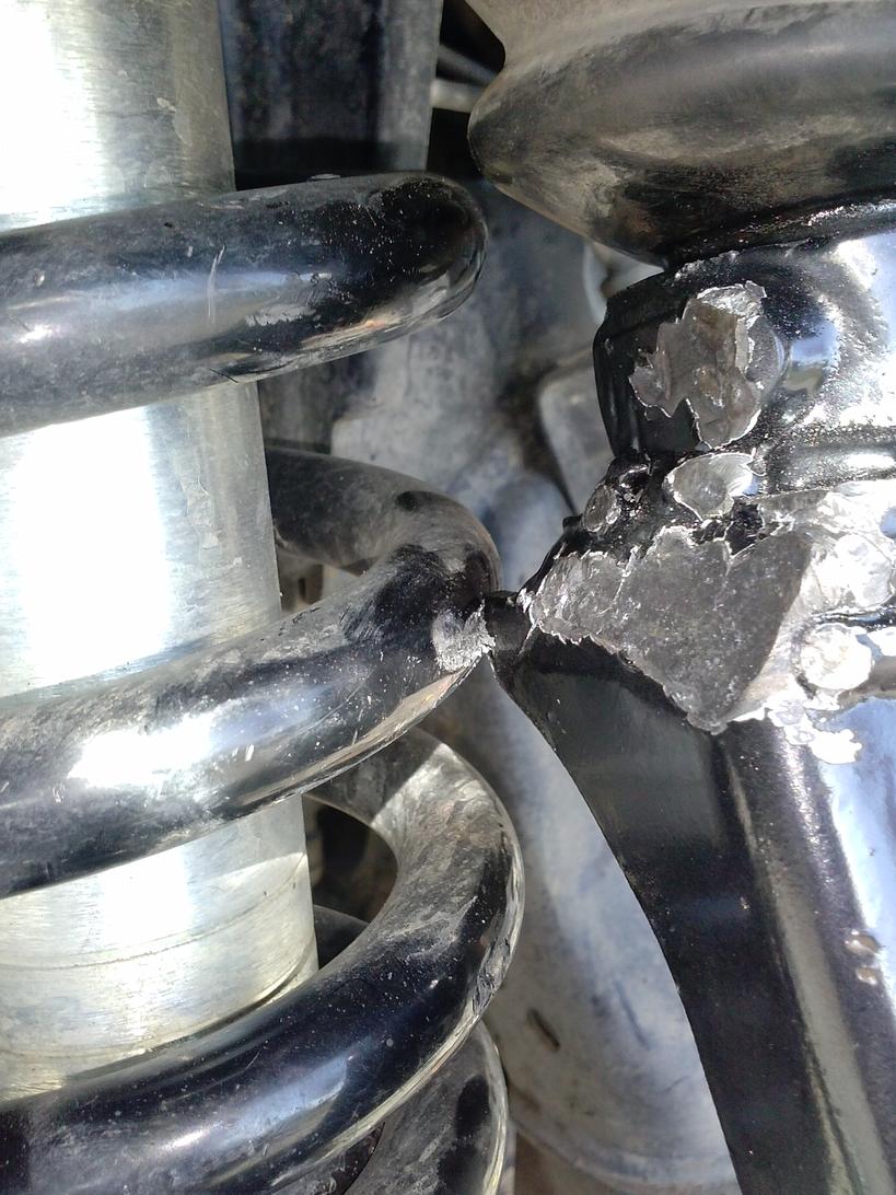

I had the gusset hitting the springs, but, the air cut off tool took care of that.
So, since the nut kept bugging me on what to do about it, today I decided to get creative. Hard to watch football having this problem in the back of the head.
Went to the hardware store and grabbed a couple of nuts and gave it a try, what do I have to loose, but, to get uniball UCA'S. Not on the pocket book right now.
All this for a set of gussets that will accept using my swaybar.
Now I can finish my day watching the games and relaxing.
Will finish the other side tomorrow as I have the day off.
