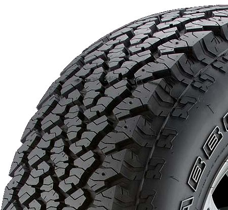

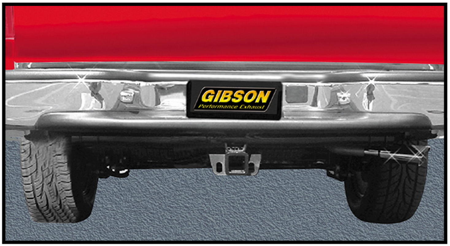

I just ordered these two items... (As a result) Wallet cursed at me !!! :tsk:
