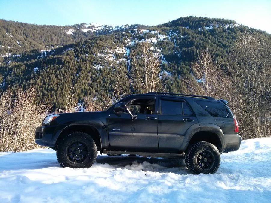

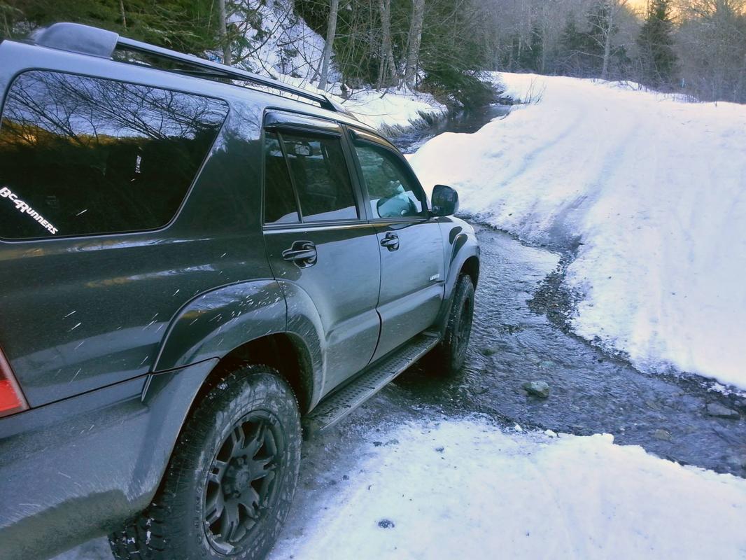

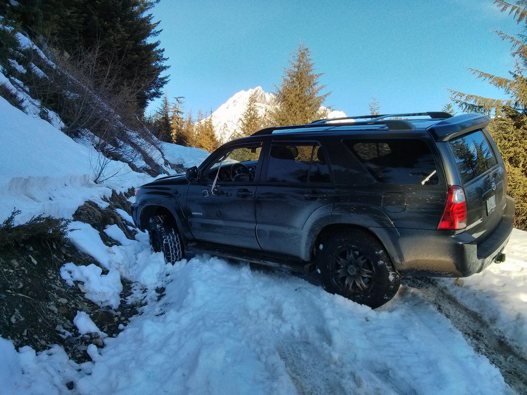

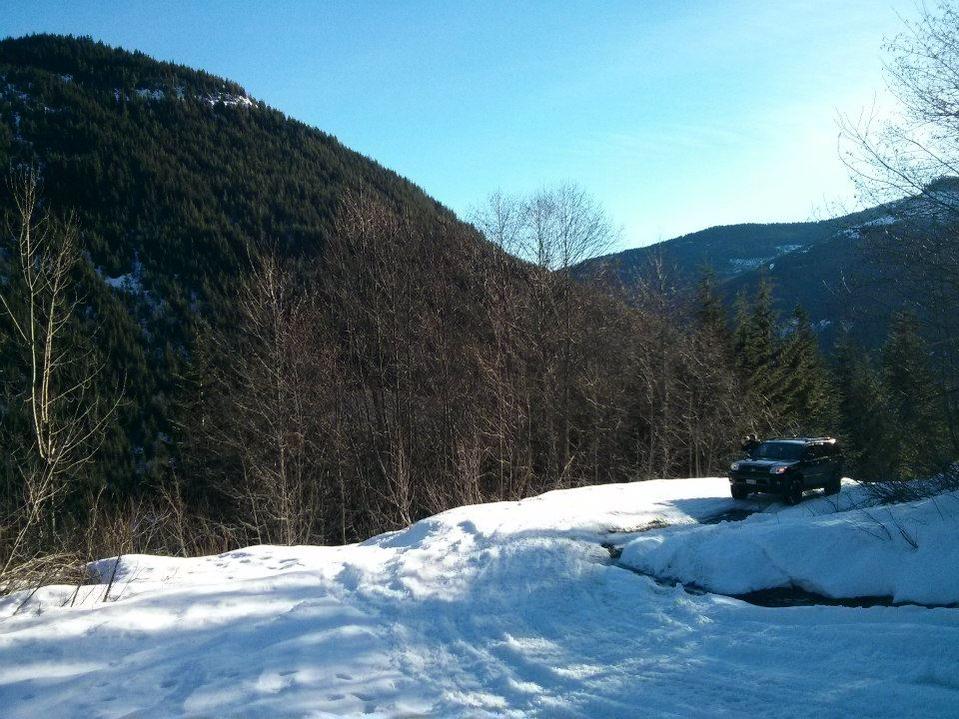

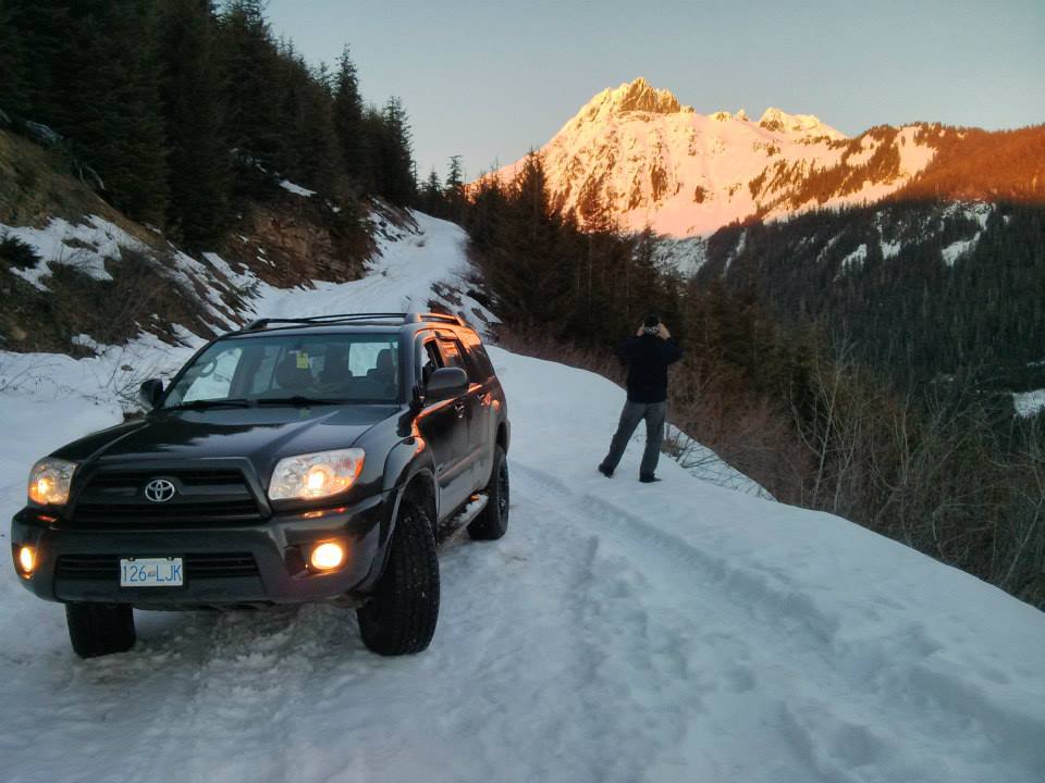

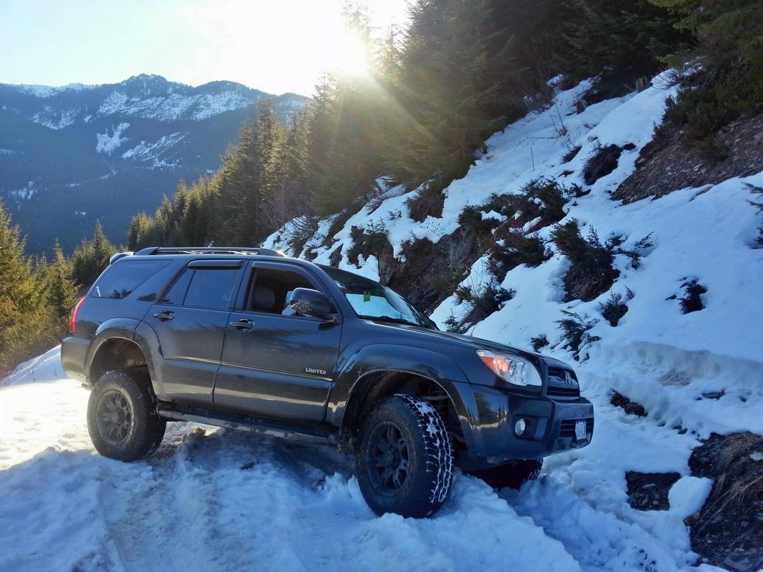

Wanted to see how my Toyos handled in the snow so went up to a FSR with a friend. It was a beautiful day and all fun until i got stuck in a ditch. 45min later of shovelling and creating a path for traction...it was a beautiful day again lol. Had to do a U-turn around that last picture cuz I wasn't able to go up anymore, got too icy. Also, had to go buy a more powerful compressor afterwards cuz my dinky one took took long to inflate my tires :bounce:
