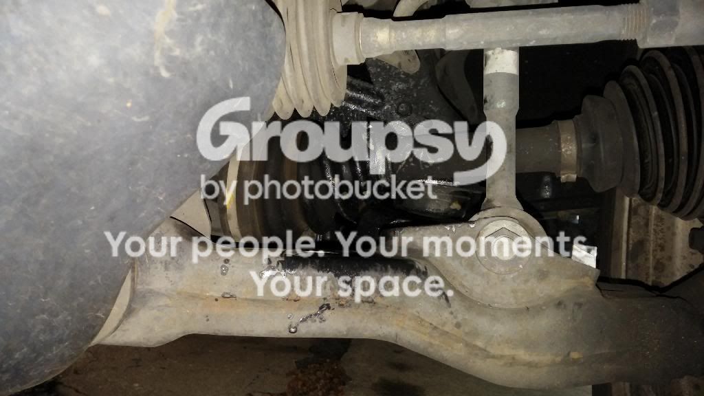

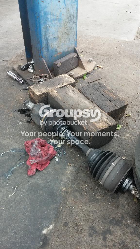

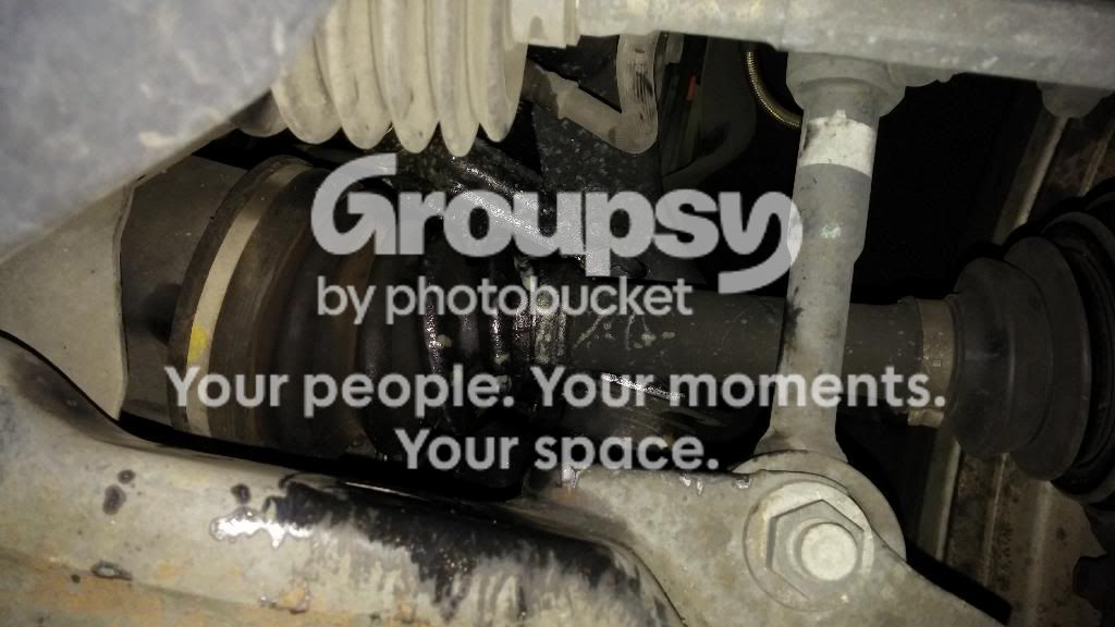

checked my brake pads, and apply new brake grease. then to driver side, found a tear on the cv boot, the inner one, so pissed right now since i dont do the extreme wheeling like you guys all do. going to get it worked on this morning. is the cv boot a common problem, driver side inner?

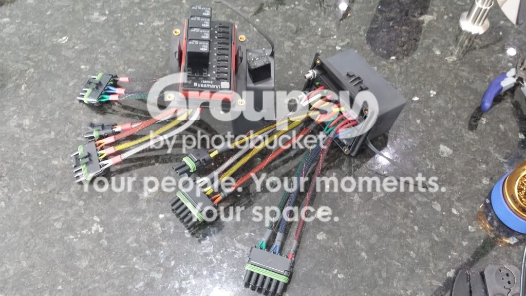

This was actually yesterday but I wired up these 2 relay boxes. Each box holds 5 micro relays and 10 mini fuses. I added weatherpack quick connects too so it will be plug and play. I reverse wired the relays so that one buss bar is 12v and the other is ground. (You can see the relays are upside down).
I'll be posting more details in my build once a get a few mins.
