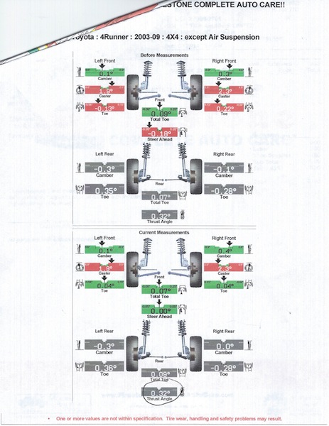

Heres the before and after for today. How do these numbers look? They kept telling me since its lifted its going to be off and not at the factory spec's. And I kept telling them I want a print out with the numbers.
Those numbers look pretty good actually. The only confusing thing would be that your camber actually increased after the alignment for the right tire... Lol
But your toe is good and caster isn't really too important for our application, so you look good to go!
Keep a close eye on your tires for any abnormal wear though, sometimes it takes a few alignments to get it right, and when you're altering the suspension, whoever did your alignment might have done it to stock spec, not lifted spec.
The only issue I would ponder is the caster. ~3.5 would be a nice place for caster. I am surprised they couldn't get it any better.
There's no way they would be able to get caster above 3 with stock A arms and a lift while keeping camber angles in check?
I don't think so, but I have seen some at 2.7-2.8 with the smaller lifts. Hers is quite low, I wonder if the tech was lazy or that was the best they could do?
It's firestone, definitely lazy techs.. I deal with it every time I go there and my alignment feels like poop. My caster is always at 1.5. I always try and tell the explicitly 3/0/0 but it NEVER is above 1.5. I live with it.
