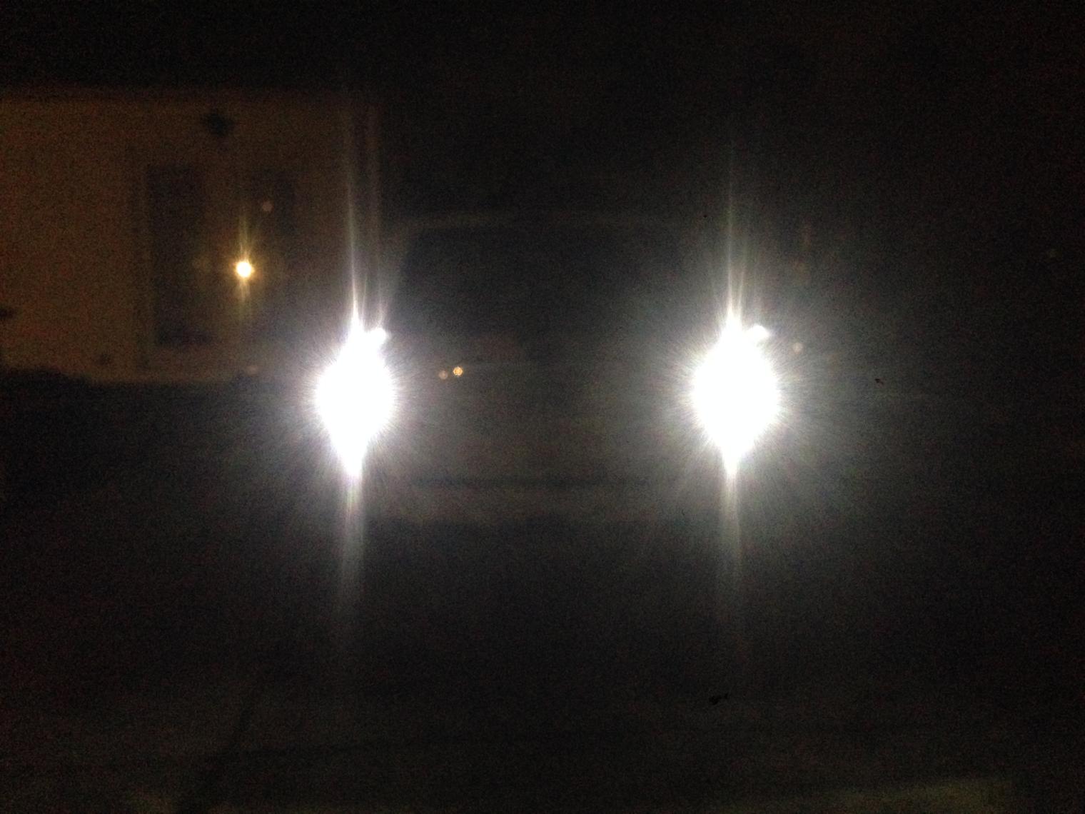

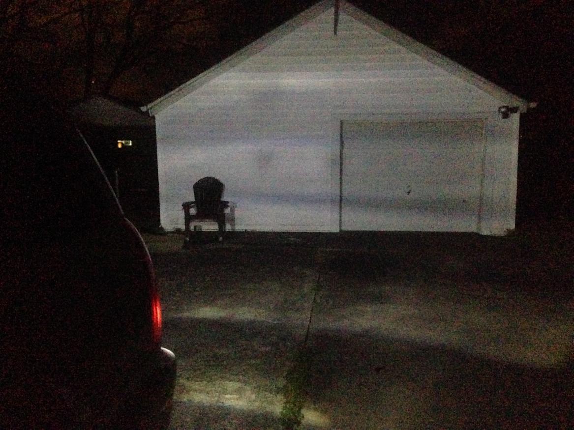

Here are pictures of the LED reverse lights I bought from [MENTION=67365]Whitebeauty[/MENTION]
Love how bright they are
