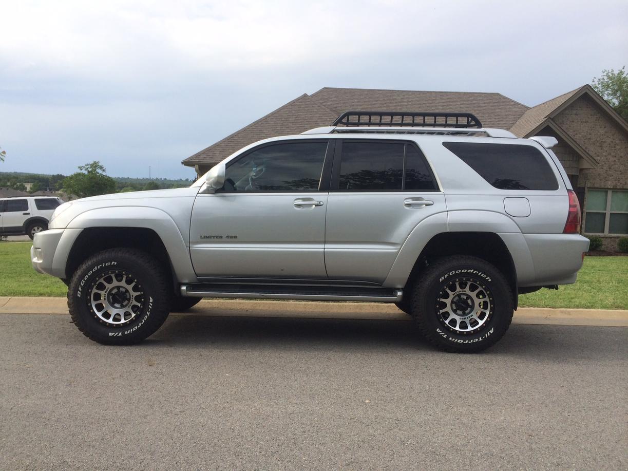

Picked up some new shoes! 285/75/16 duratracs and some level 8 MK6s in bronze. Soooooo happy with the look
Nice. I'm trying to keep it modest with a 265/70/17 or 275/70/18 Duratrac, but every time I see the 285s I love them... But what???? The tire size calculator says a 285/75/16 should be shorter than a 275???

Well, the measurement you are comparing is the width of the tire. The height is a ratio/percentage of the width ( in this case 70) added to the wheel size. Need to look up how to read tire sizes.
I know how to read tire sizes, for about 25 years now.
If you'll notice, the aspect ratio of the two tires I compared are both 70. All things equal, 70% of 285 is greater than 70% of 275 or 265. This means a taller tire.
The question here is 16", 17” or 18” wheel diameters, and I didn't think it was enough to compensate to that degree for the difference in tire height.
I further comment about the spec of this particular tire because aggressive tires (track car or off road) are typically known for running wider (thus taller in common duratrac sizes) than other brands.
I would guess that something like a Dueler might be 30.5" for a size rated at 30.5", and a Duratrac in the same size would be 31.4", etc.
You know?
You know?
The side walls would measure out taller but the overall height is decreased based on a 2" smaller wheel. I think it actually shows the 285 is about a half inch taller in sidewall height since the difference is only about 1.5".
Not sure where your confusion lies. Maybe I am misreading something.
Just so I am clear 285 x .7 is 199.5. Times two is about 400mm. 16 wheel is 406mm. Add together and you get their height on chart you posted.
Same math works on other where you end up in mid 800 range.

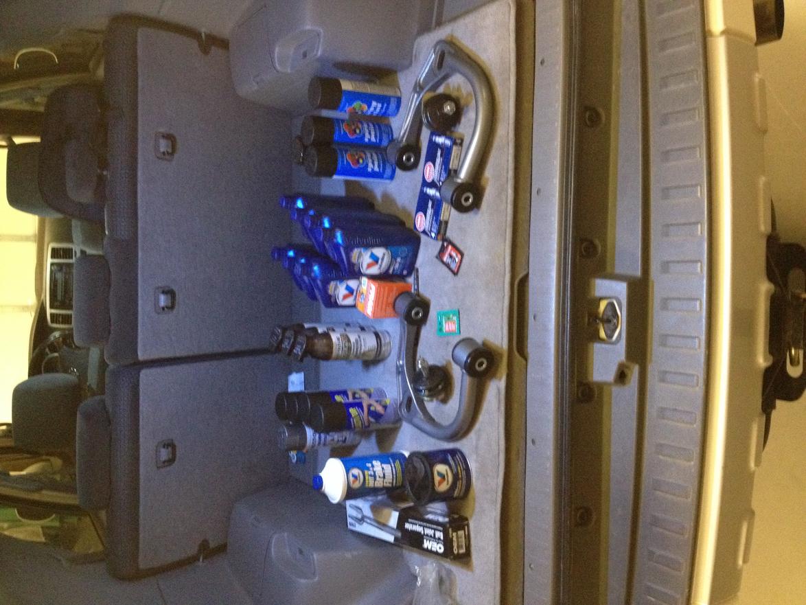

Big day!
Install UCA's
Get alignment
Remove and clean wheels
Plasti dip and paint wheels
Change oil
Spray paint fender well's
Paint skids
Bleed brakes
Spark plugs
These all take a lot of time with drying etc, the alignment will slow me down a lot! Want to get that done so my dip and paint don't get screwed up!
