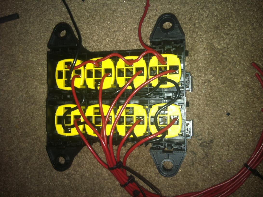

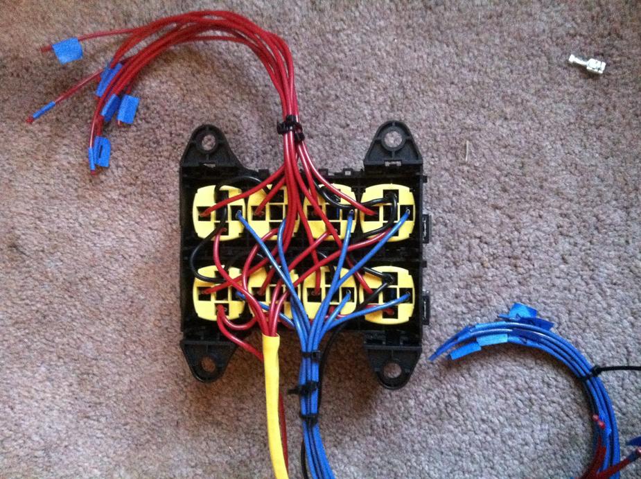

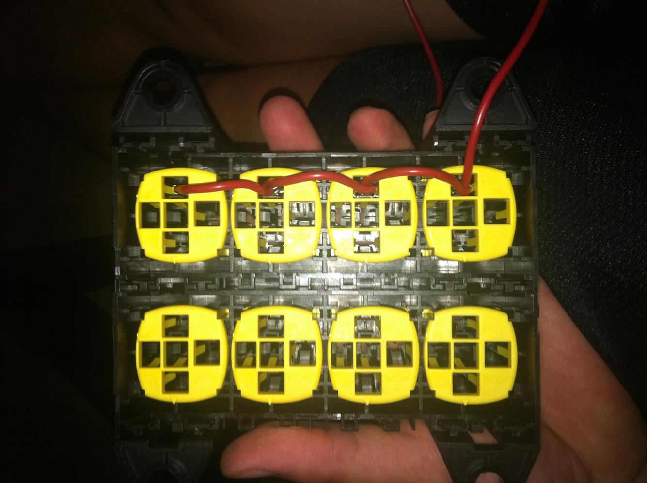

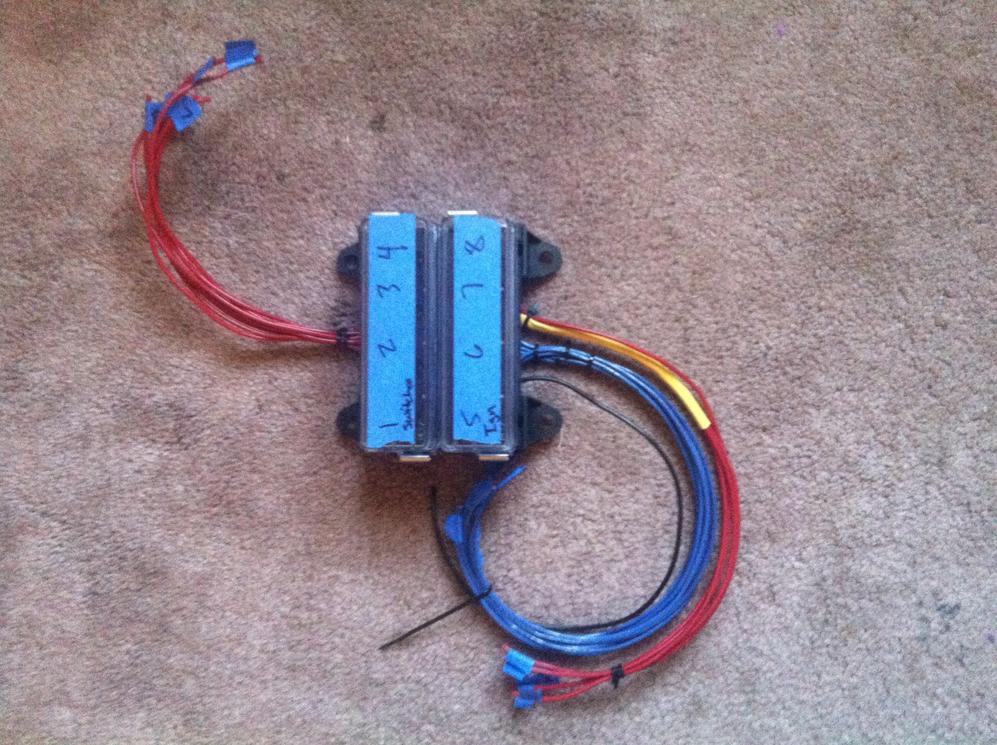

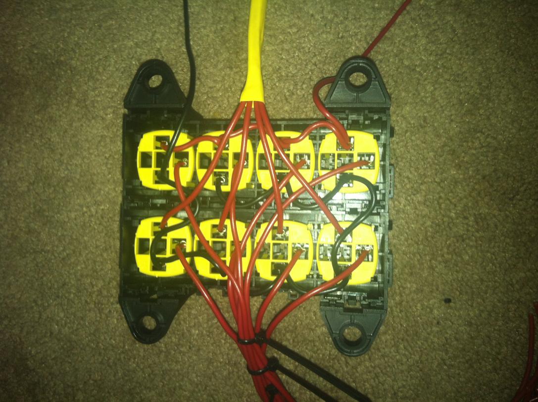

I started the process of setting up all the wiring for my future accessories. Also installed my ditch lights about a week ago.
Looks real nice. I like it. where did you get a relay bank like that? Could you have used larger gauge wire in there? Looks like you are running 14?
I'd like to get one and then possibly make a bracket for it to mount to the drivers front frame rail.
They are Hella relay boxes. I got them off of Amazon, I am waiting on a matching fuse block, a circuit breaker and a bus bar to come in and I'll mount them on the passenger side of my engine bay using a bent piece of steel mounted to some provision holes I found. I will post pics and possibly do a write up when I'm done. Half of the relays are switched by the ignition and the others are to be operated by push button switches but only while the ignition circuit is active.
Edit: The wire is 16 awg, its all I require for my application. Anything larger would probably be too tight of a fit.
