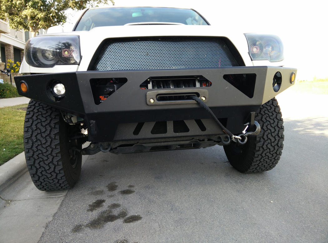

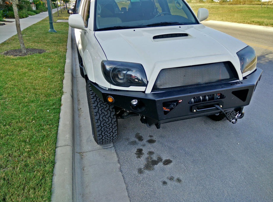

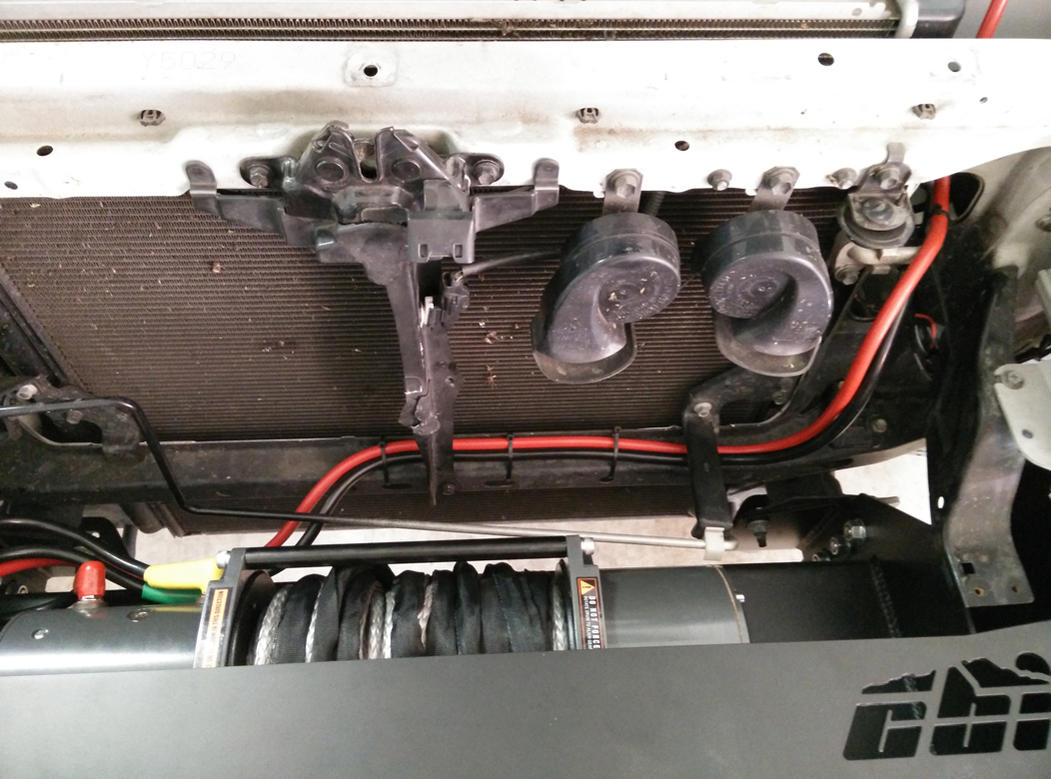

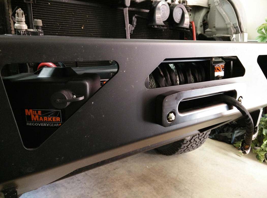

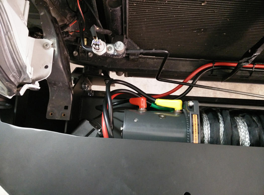

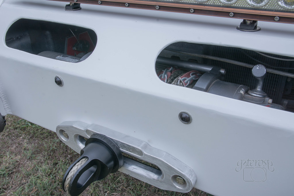

Installed my Mile Marker winch today. Had to clock the motor 90 degrees to clear the grille, but other than that it was a simple and easy install.
