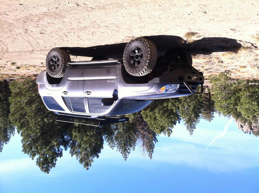

Anti-gravity mod? Nice. Could you post a write up?
3intoytec boss suspension with total chaos ucas icon remote reservoir in rear. 285/75/15 nitto trail grapplers with spidertrax 1.5in spacers on stock rims Demello bumper Yakima roofrack dual battery set up
Damn! Way to go all out in one swoop. Looks sick! ( once I turned my phone upside down ) lol

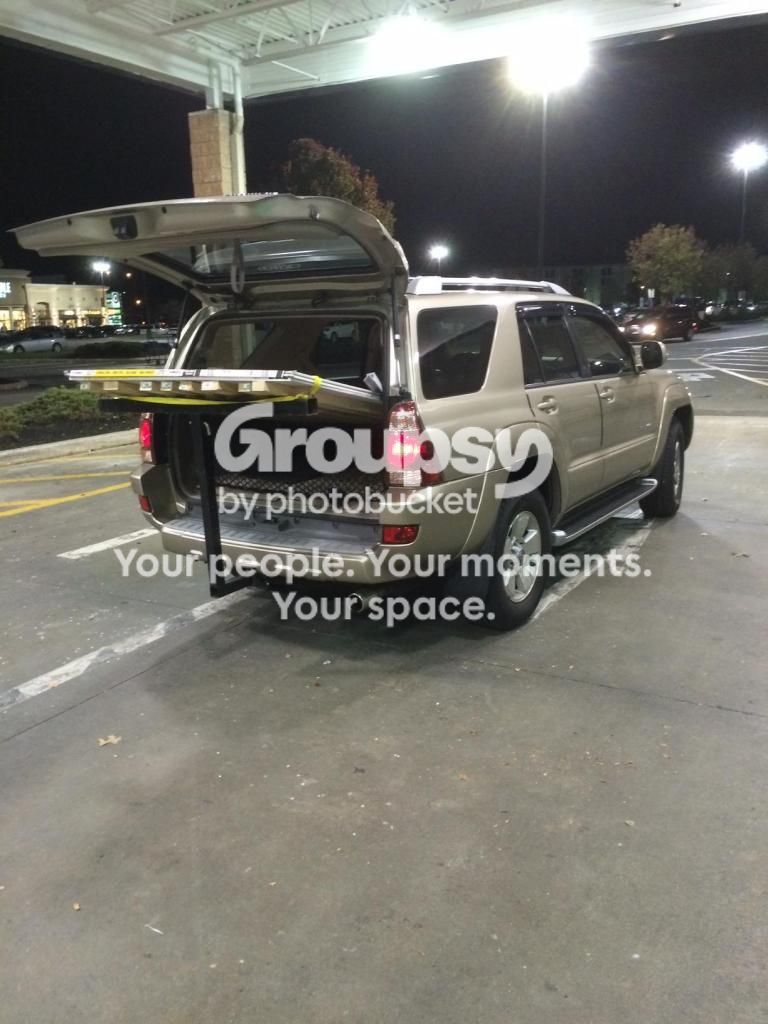

Drywall transport
I'm in the middle of a major kitchen renovation. I needed a decent amount of wood framing and drywall this weekend during construction. I was determined to transport it all in my runner with 2 requirements: 1. I didn't want to cut the drywall and 2. I didnt want it on the roof. I have a hitch tailgate extender that I used to use to help load a kayak onto my roof. When I sold the kayak I kept the hitch extender but cut it to a height so that it was slightly higher than the bottom of the rear window so I could transport long heavier stuff hanging out the back window without resting on the windowsill itself. I folded my seats down, used that tailgate extender and loaded all of my 2x4s first, then drywall on top. Tailgate extender has U hooks on it that I used to ratchet strap everything down. I had to leave the tailgate open, but it wasnt a long trip. It was extremely secure and nowhere near the weight rating of the tailgate extender. All in all, a pretty simple way to transport drywall, plywood etc, in a safe manner without cutting it down or strapping it to the roof, or causing any damage to the truck. Thought I'd share...
