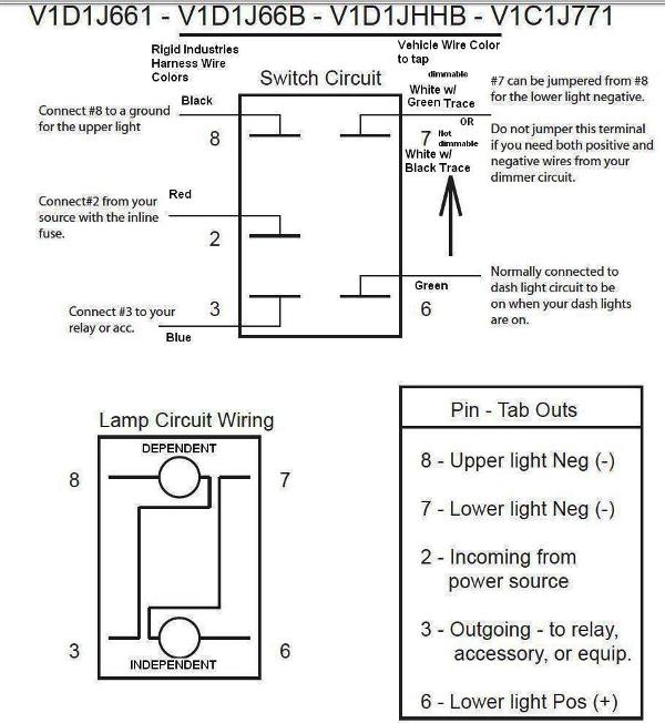

I'm taking suggestions for the cleanest and most professional way to ensure my 3 sets of RI LED lights only have power available when the vehicle is running.
Right now the 3 harnesses are attached directly to the positive battery terminal, which means even with the vehicle off the lights can operate, thereby draining the battery potentially.
Anyone have any suggestions?
I was looking at this https://www.bluesea.com/products/7748/SafetyHub_150_Fuse_Block
but I am not sure how to connect it so it only has available power when the vehicle is running.
Any help would be appreciated.

If you run them off of a relay, make sure the switch operating the relay only gets power with the ignition on. You can run your main power off of the battery, and your switch off of switched power.
you're gonna have to really spell this out for me... I'm using the rigid industries harness connected to OTTRATTW SPST switches in the below configuration, does this help?

take #3 and run it to your relay.
relay gets wired like this,
30 12 volt in
87 12 volt out to lights
85 ground
86 in from #3 on your switch
now #2 on your switch you wire to something that is controlled via ignition inside the truck.
easy peasy
