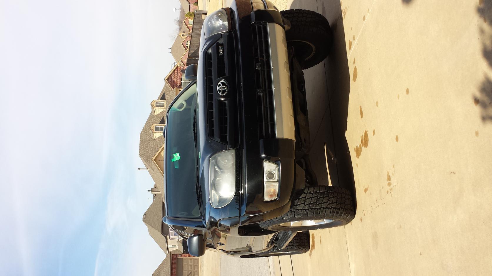

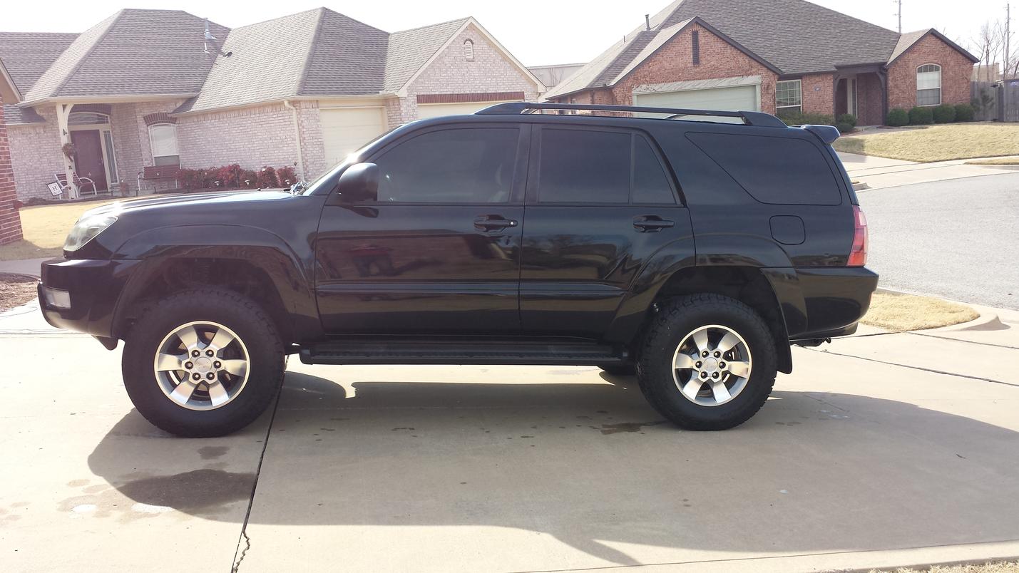

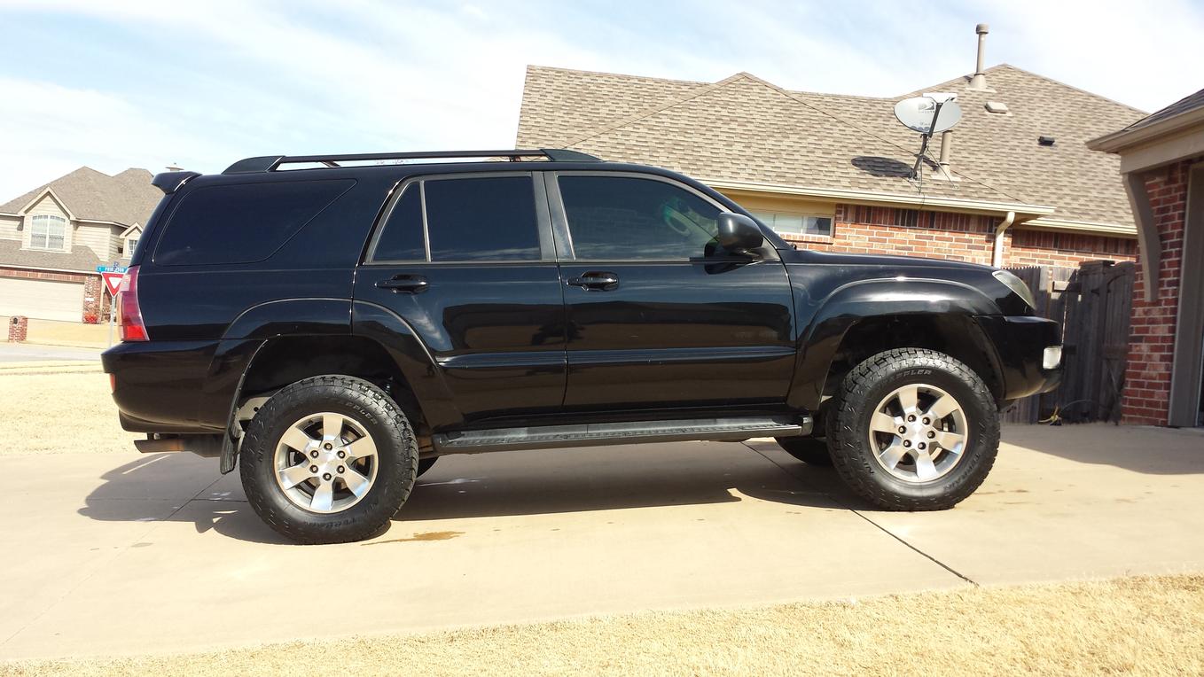

Finished the lift and had tires put on today. I'm really impressed with how it handles off road. It's really nice having the V8. About the lift I have 5100 front set at 1.75" with Tacoma TRD sport springs the rear is fj springs with daystar 1.5" and the tires are 265/70/17 on a 2013 4runner wheels
How's the alignment? My set up is exactly the same except my fronts are set at .85. Alignment shop was able to get my casters over 3 degrees. Was worried 1.75 wilI need uca. How is yours?

They told me everything was good but come to think about it I didnt get a print out so I will swing by there and see if I can get one.
