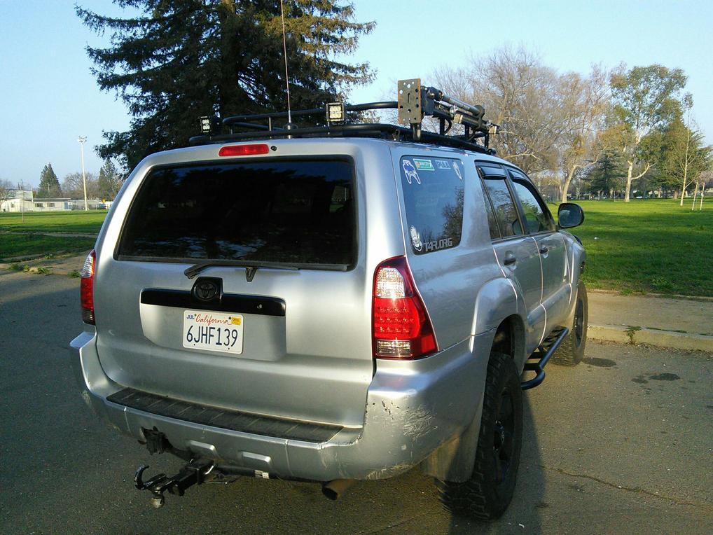

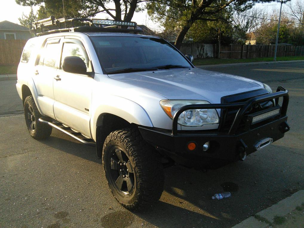

Finally finished wiring in a fuse box on the interior, and hooked up lights and switches this weekend. Took the kid to p/u some BBQ and hit the park up for a picture shot and eat.

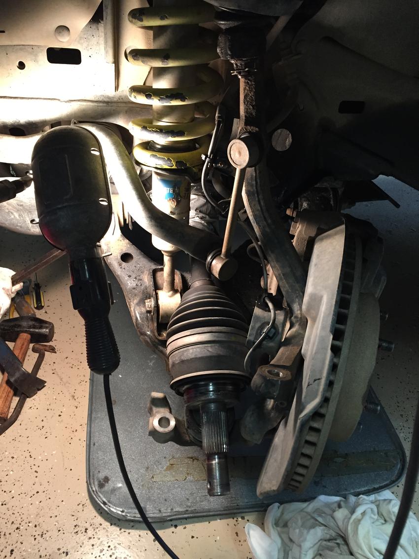

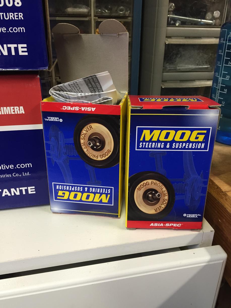

replaced cv axles and lower ball joints.
I need to do my passenger side lower BJ, probably just going to end up doing both sides. I also ordered the moog bj's with the zerks fittings. How easy was the instal? I hear they can be a little bit of a process, also do you guys think its worth it to do the bushings at the same time? I know this means more work but i figured while i'm in there..
Install was kind of a b***h, not gonna lie. the ball presser i rented did not have the right size receiver tube. so i looked around and nowhere else had the size i needed. so ended up getting another piece of metal tubing that was close to the size i needed, cut it to fit and made it work with the presser. other than that it just takes some major muscle to torque that baby out.
and for the bushings, i like to do everything at once so I would knock them out if you really wanna at the same time
I read in another lower bj post about somebody else having the same issue with not having the right size receiver to press it. I think they did something similar to what you did and just fabbed up they're own. I know [MENTION=47269]Darklight[/MENTION] did his and i think everything worked out fine, maybe i'll hit him to see what kit he rented. I was thinking they might be a little easier to press in and out once off the truck since i'll have to take them off anyways to to the bushings but idk it might not make a difference?
Jared, it is actually easier to press the ball joints on/off while on the vehicle, unless you have a good vise to hold them. As for the ball joint press kit. Get the biggest one you can find. Get a big cheater bar too. I used a breaker bar with about a two foot pipe over it. Just row them off and back on. When putting them back on make sure they start off evenly with the zerks facing the right way. Good luck with everything.
