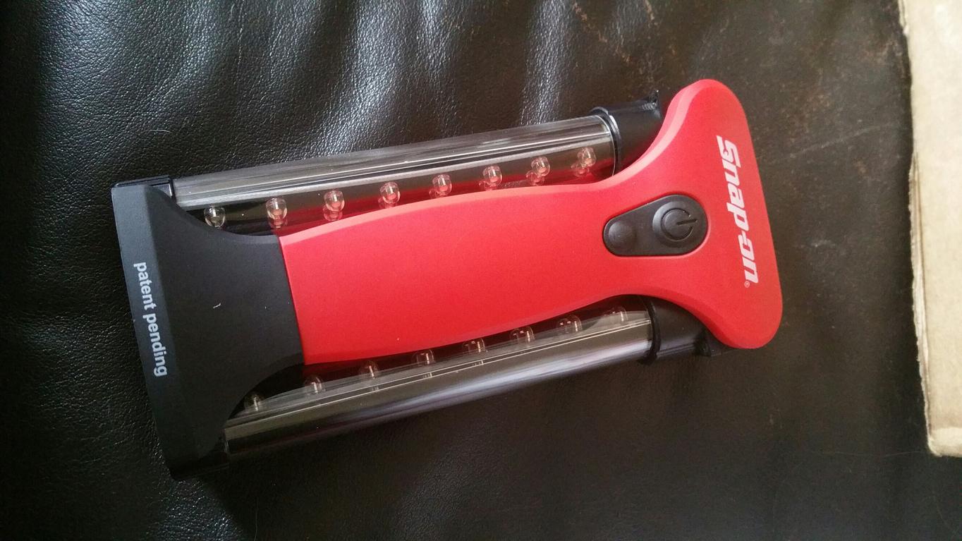

This came in the mail today, good tool for my emergency box for engine probs should the need arise, the lights swivel and has a hook+magnet at the end to hang on hood. Super bright!
That's a great idea, I may try that tomorrow. Than you!
