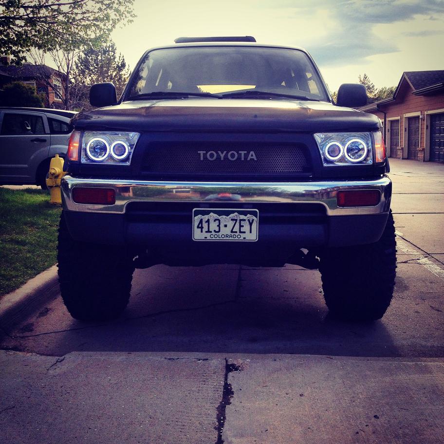

3rd gen headlight retrofit
Finally finished today!

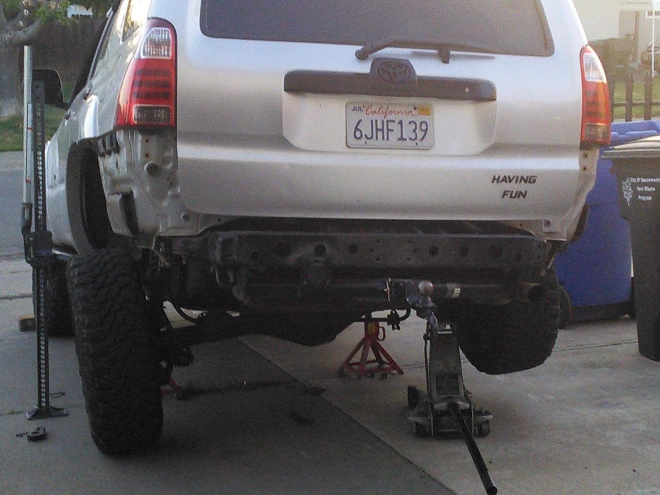

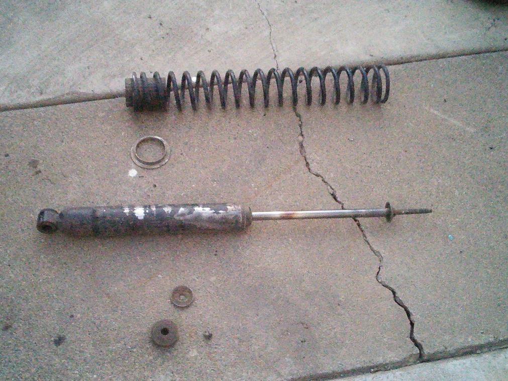

So, I have still had my 2.5" spacer lift in the rear w/coilover HD shocks in the rear for a while. I decided to go with the 3" Overland dual rate HD coils now.
What a difference, not so much bounce and don't feel to much pot holes anymore.
Since my shocks where designed for a 3" lift, I'm reusing them without the coil springs on them. Was tired of the lack of support when loaded down.
This morning, had to use the spring compressors to re install the driver side with 1 of my spacers I cut down to 1.5". No more driver lean.
Yes she's got rake. I estimate aprox. 180 +/- lbs extra weight on it constantly.
