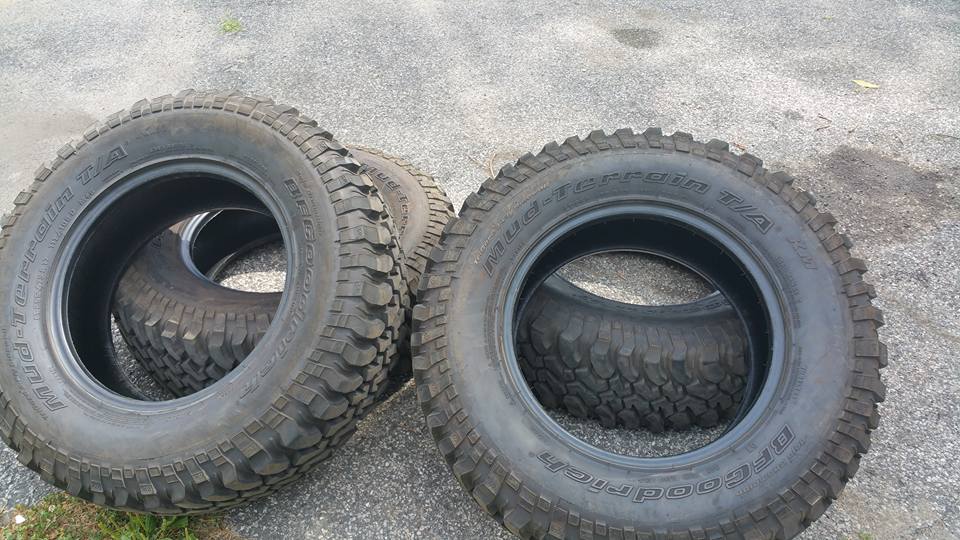

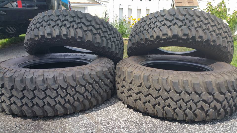

Got a great deal on a set of 5 Rubicon take off's 255/75/17 today. Less then 800 miles, came off a brand new jeep.
Mounting them on my 13' trail wheels in the next few weeks.

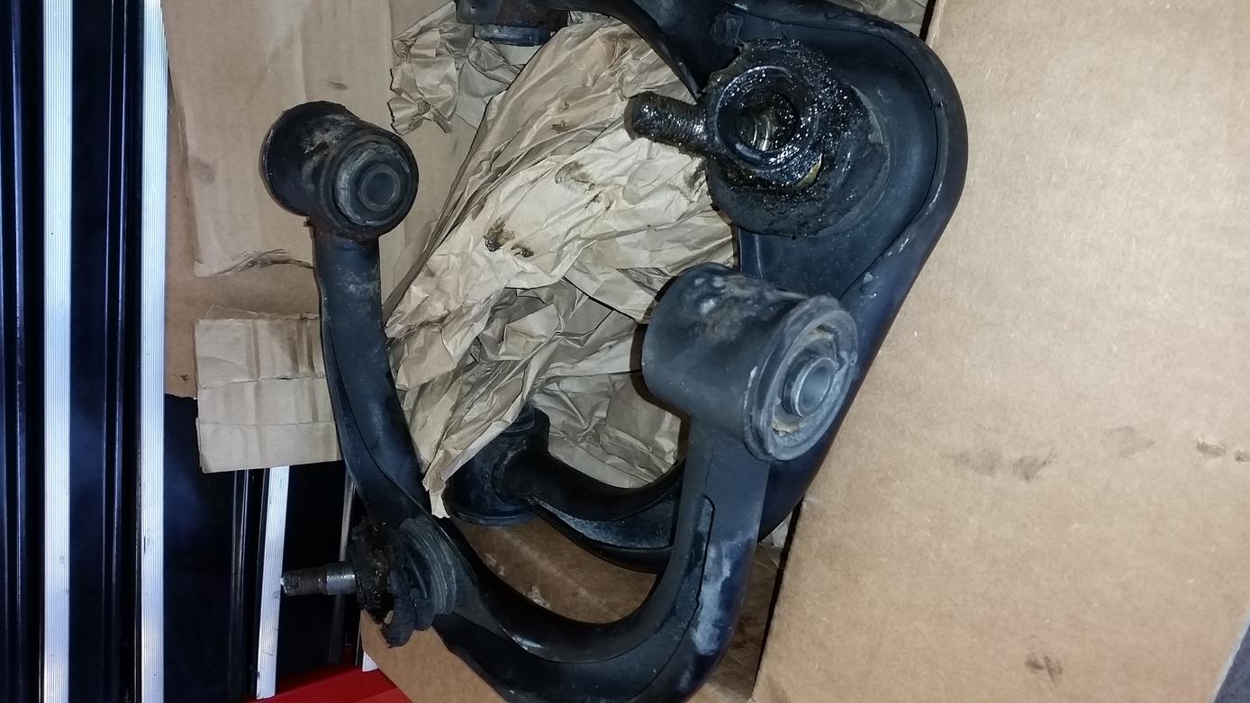

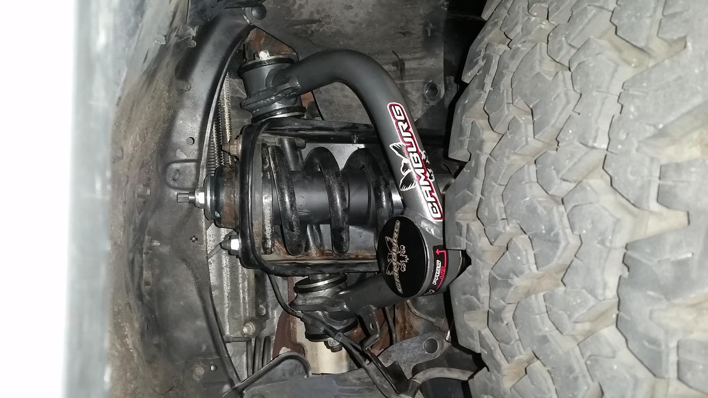

Installed new control arms today!

On the camburgs, what's the main difference between going with ball joint vs uniball uca's? I know ill need some down the road and don't really know what the difference is besides price..
Interested to hear how this works for ya. My PA speaker is stuffed in the engine bay like yours was, and I've been thinking about mounting it somewhere else.
So far I can definitely hear it over the engine, which is an improvement over when it was in the engine bay, but I haven't gotten the chance to test it out on and pedestrians yet haha. I'll let you know
You will get a little more travel/flex out of Uniball UCA vs BJ UCA when running them upgrading the suspension with more travel. But you still get good travel with the camburgs with the BJ's. The main reason i went with them is because i live in the north east and didn't feel like replacing the uni ball once a year or so from the harsh winters and salt.
Truck looks awesome by the way, love the new stance with the new shoes!:thumb3:
Thanks for clearing that up, I guess since I'm in the south and theres no major salt or anything I might as well just get the uniballs when it comes time to buy uca's.
