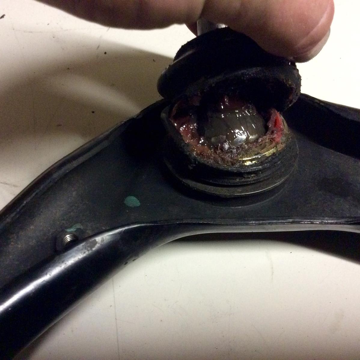

New Energy Suspension uca bushings and Ball Joints both of mine were completely blown out bad, and the bushing were just shot and had play in them.

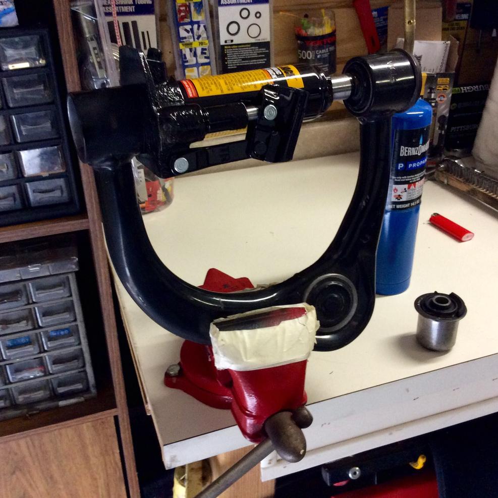

So I torched them out cleaned the inside and metal sleeves and pressed in the new bushings was straight forward with no issues and then took out the old arms and installed my completely new rebuilt FJ trd 4wd uca's..I can say what a difference all new parts makes.

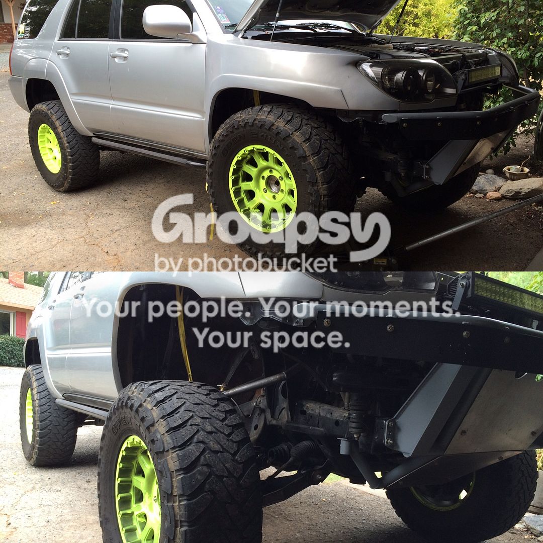

Cycled my custom lt kit for the first time. Cycled a clean 14.5" but will probably be limited a little by the CV angles. Happy with the outcome so far though.
IMG_4433_zpsysszby3z.jpg~original
58df7ad1-044e-42ab-92d1-618ed8ee09d7_zpsbovosw4k.jpg~original
c1a8208c-508f-49b7-a782-f060b155689d_zpstenpdahb.jpg~original

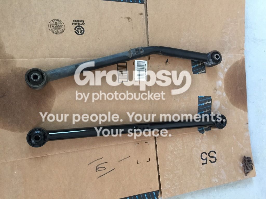

Got rid of the high clearance lca

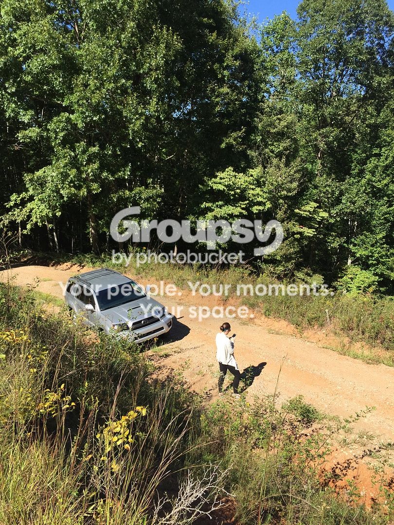

Me and the wife took the little man exploring in Dawson Forest WMA today. This was his first experience on "rough" roads. He didn't mind at all.
