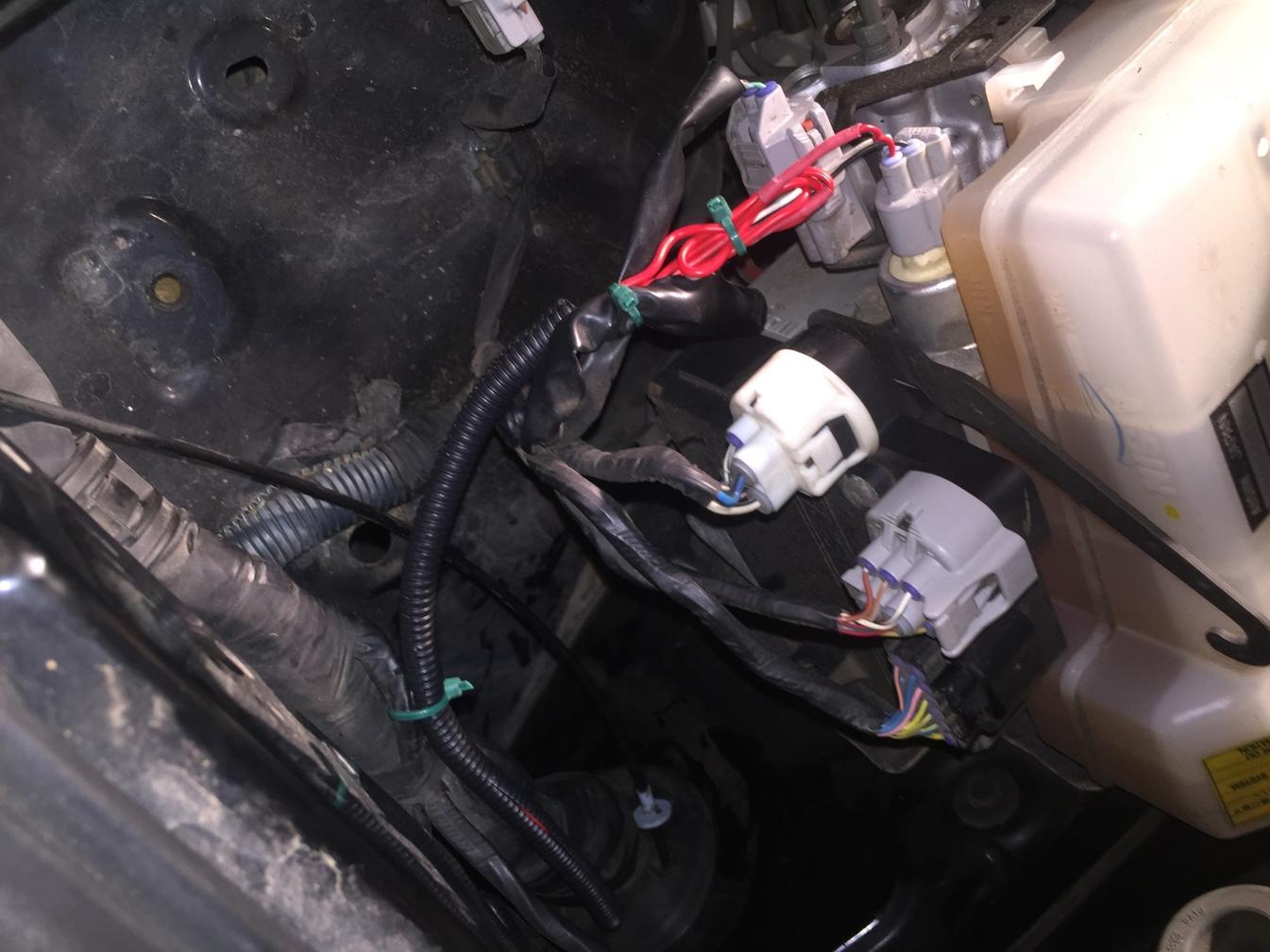

Traction control off switch :couch2:
WRITE UP HERE http://www.toyota-4runner.org/4th-g...witch-write-up-4th-gen-v6-v8.html#post2147371

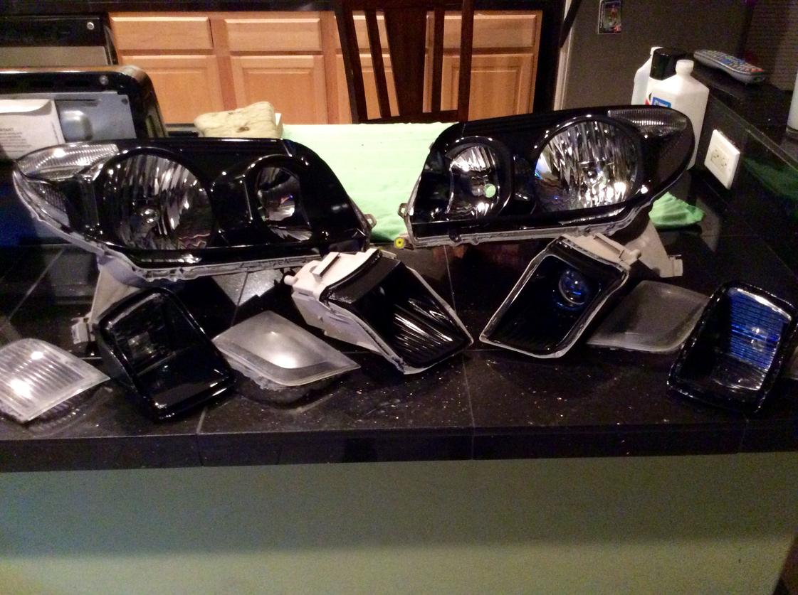

Complete Front End Lights Blackout
Just got done baking and painting all my stock front end lights
now to clean the yellowed lenses and asssemble...oh joy

Looks good so far!
I still cant figure out how to pull those damn fogs out -_-
Theres three screws holding the fog and blinker in
one on the side of the fog light , one on the back in the middle where the two lights meet each other , the other is on the back on the blinker, once you take those out undo the bulbs then push the light housing forward from the back once they move a lil you then just push the for forward hard and it will undo from the clip in between them connecting them together, super simple and once you get it out you'll be like , serious thats it. and chuckle.
Let me know if you need any other info.
good luck brotha

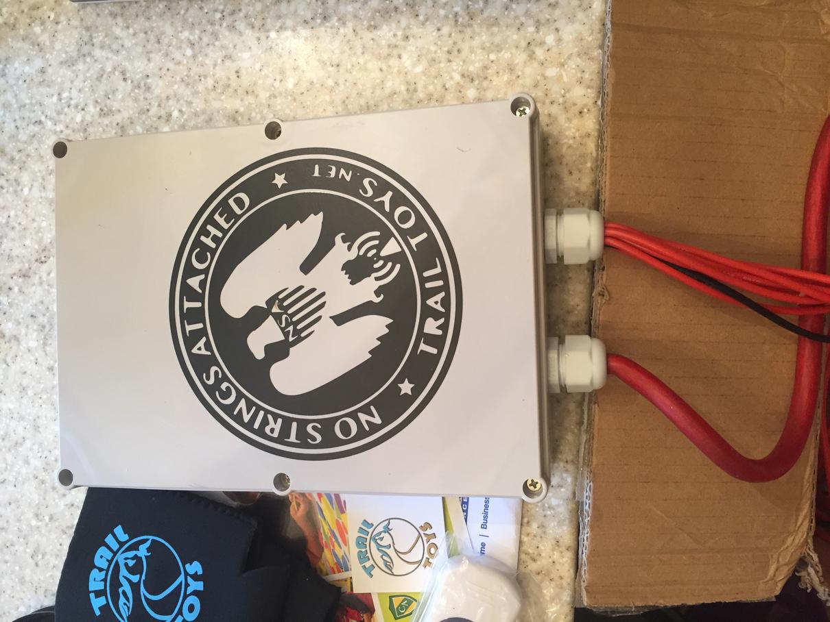

Another present waiting for me today. Thanks to Nathan at Trail Toys! Hopefully get it hooked up this weekend.
