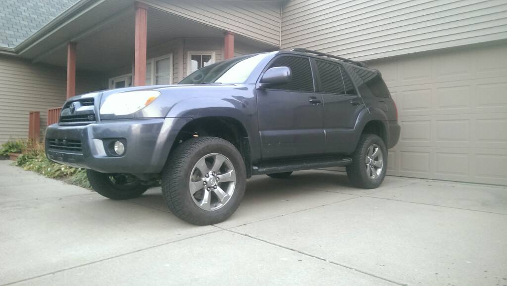

Today I managed to replace my leaky Xreas @130k on my 03 SE. REplaced with 5100s n FJ springs. Also mounted my stealth lightbar. Too bad my harness and switch require some more custom work right now. I'll post pic later, exhausted.
