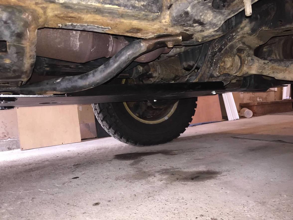

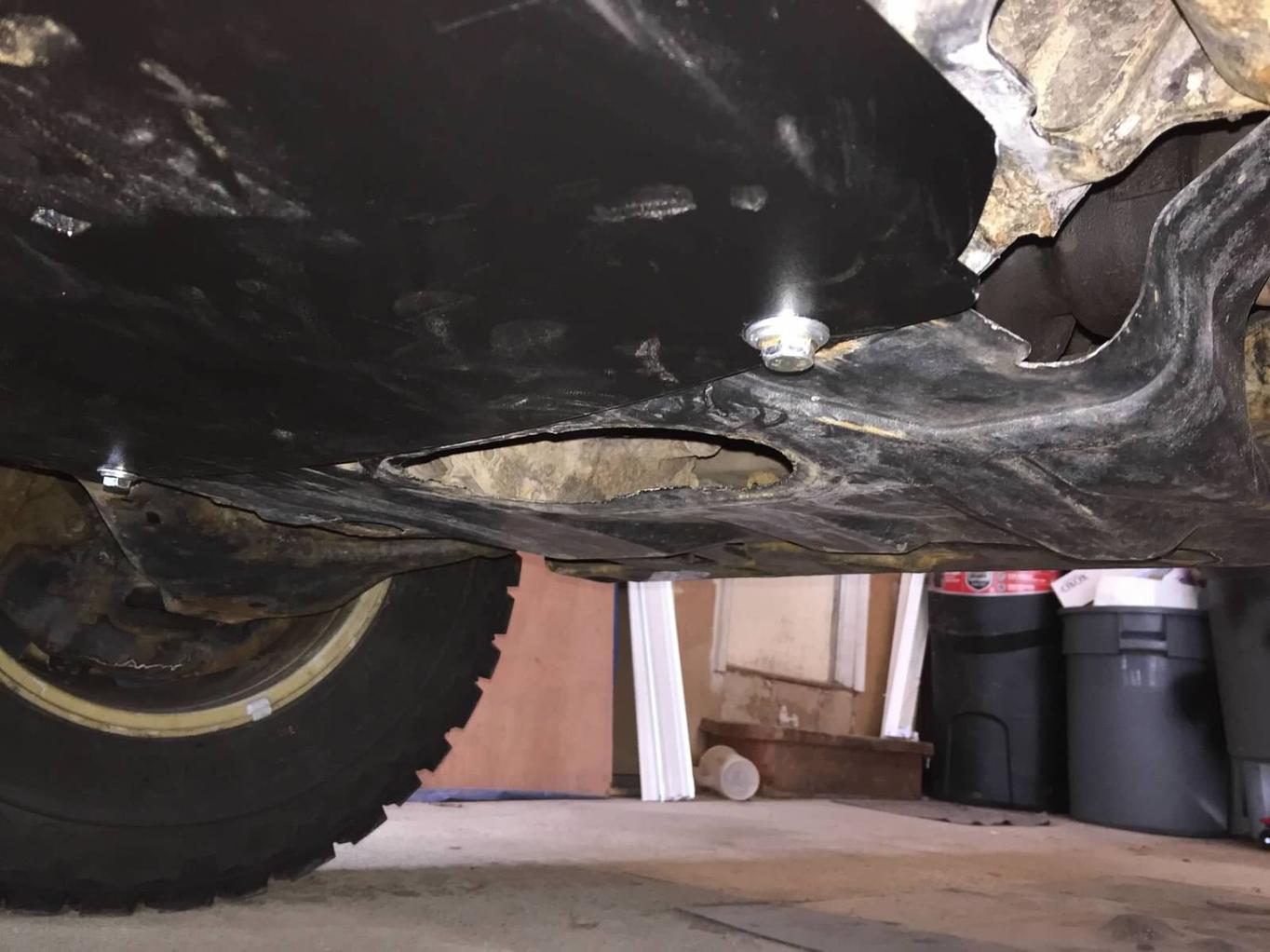

RCI trans skid
Installed my RCI Trans skid that I got during their group buy.

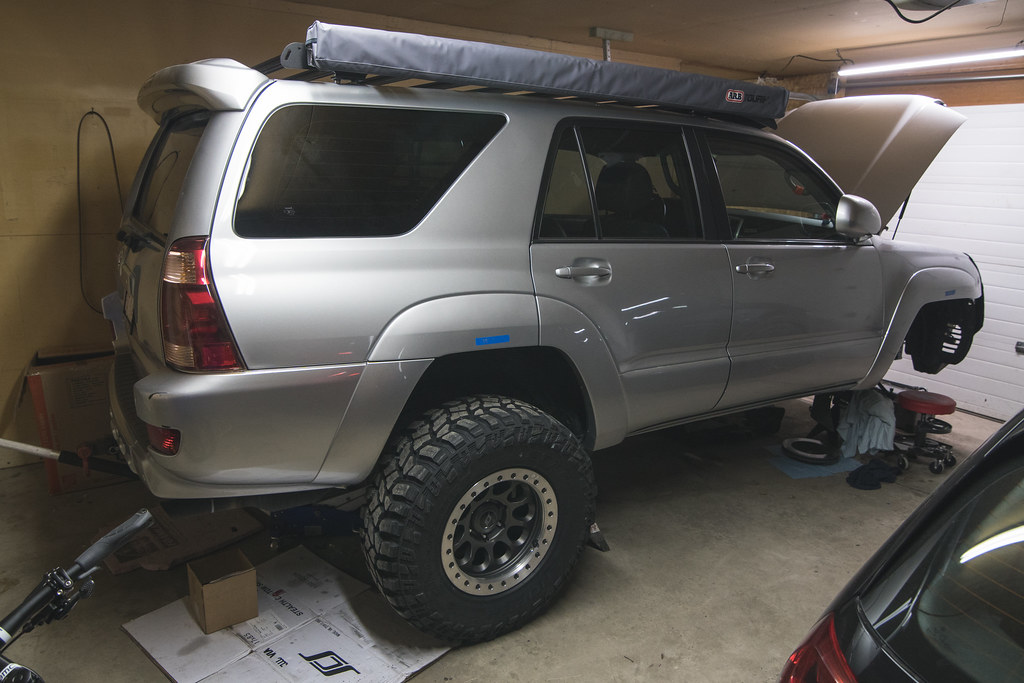

Got my 08 SR5 a month ago. Replaced two bad front calipers, rotors, pads and sway bar bushings. I've never done a more satisfying brake job. Stops straight and on a dime and no more annoying thumps from the old bushings.

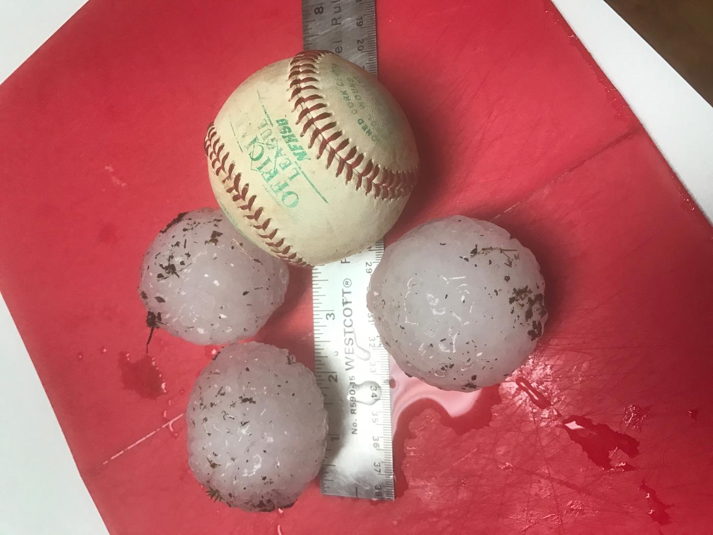

Holy. Sh*t. I got caught out in pea-sized hail on my bike a few weeks ago. Can't begin to imagine that crap.
