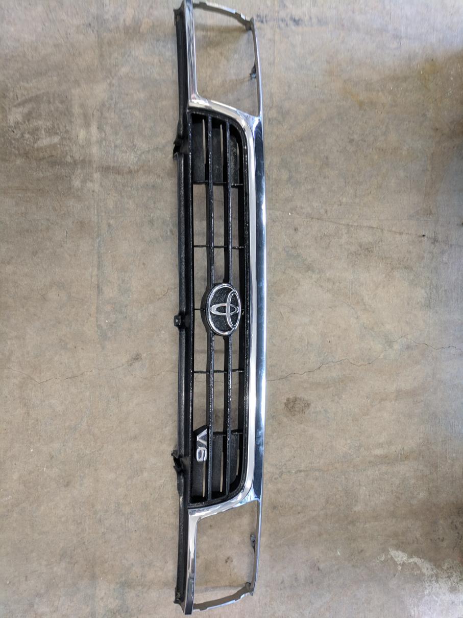

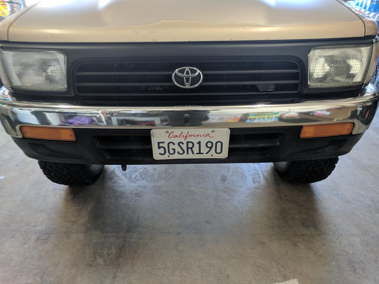

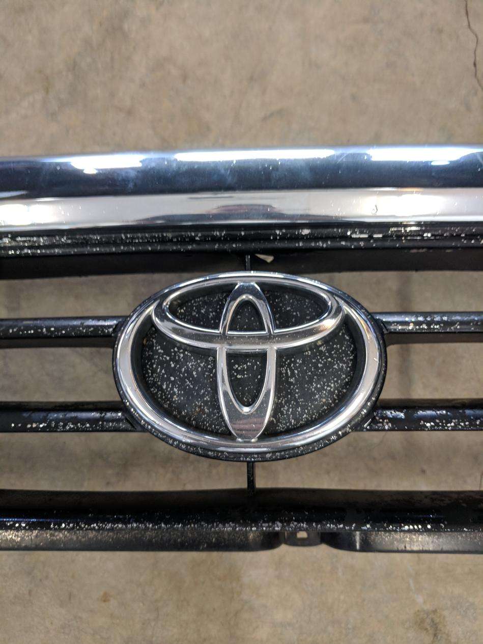

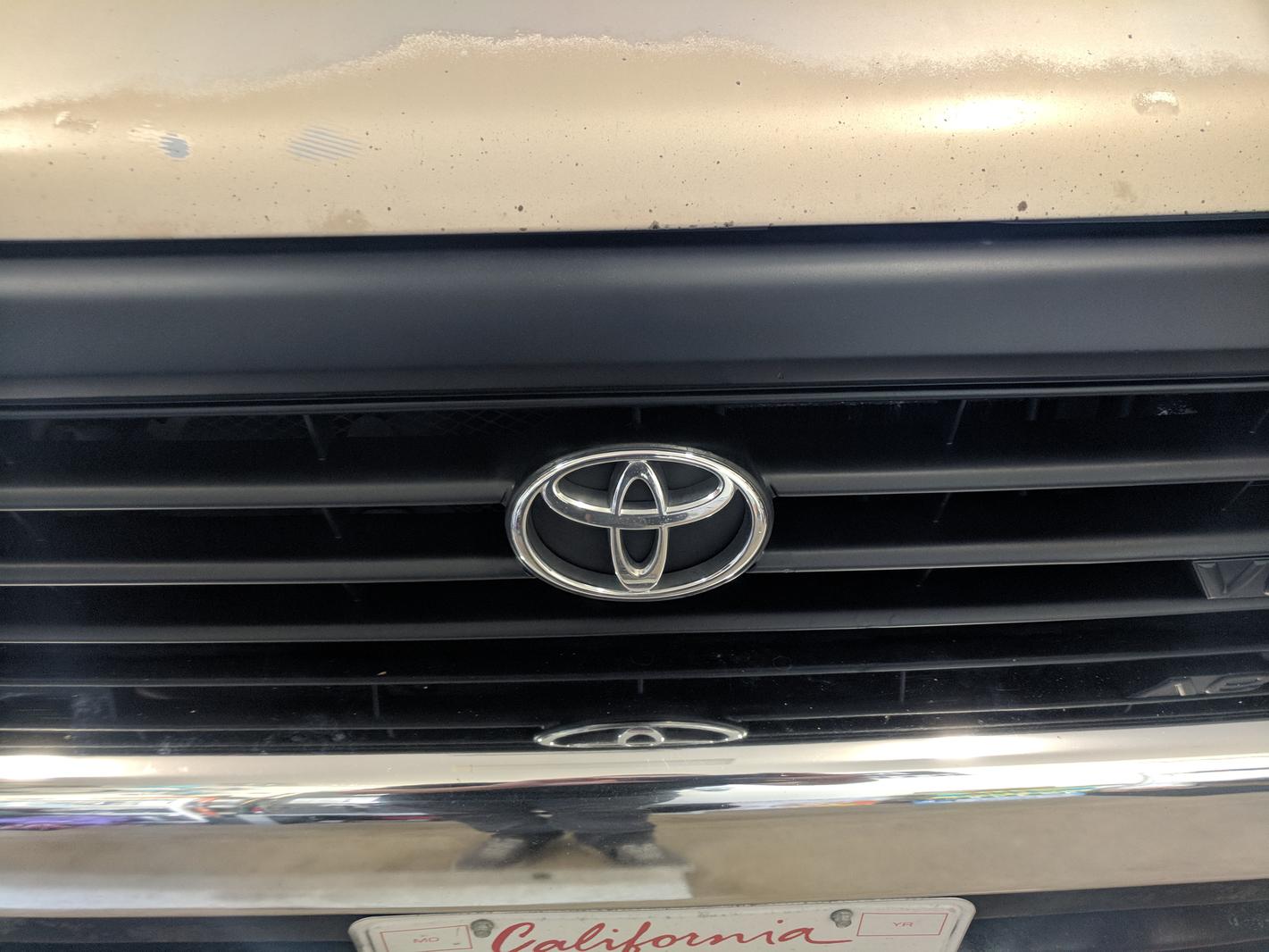

Took the grill off to change the headlights and decided to paint it flat black. I think it looks much better. Pics of before and after.

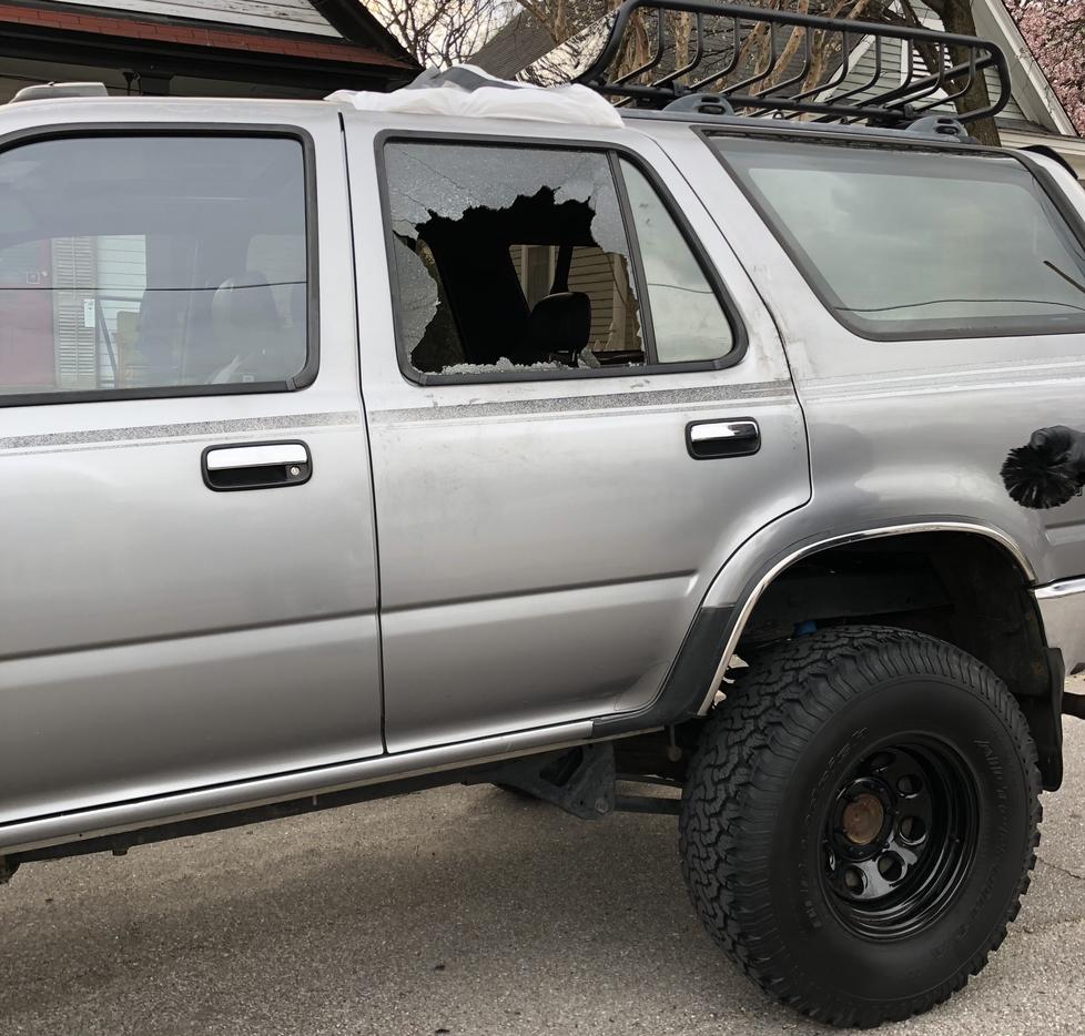

I swept the glass of my street and vacuumed my Entire interior of glass shards. Who knew smashing a window would put glass in every crevice of the interior. And the guy that threw a brick through my window, there is a special place down under for you.
