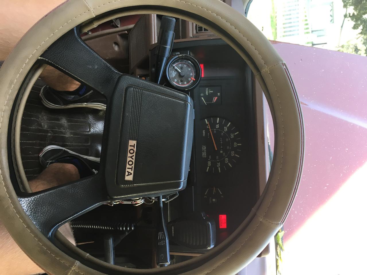

'68 Camaro horn on my '84 4Runner

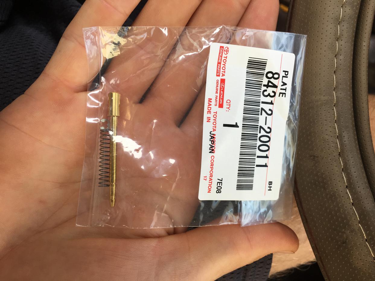

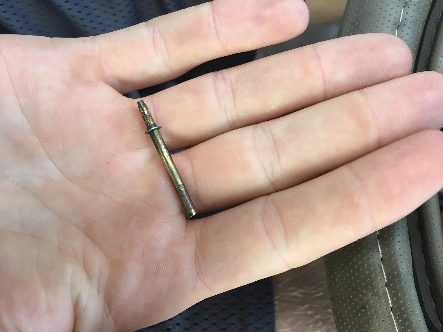

My horn on my first gen 4runner recently gave out, didn't know why at first so I did some digging. Found out that the contact pin was way worn down and the spring was gone.
So I picked up a new pin and spring assembly straight from toyota. (wasn't able to do that .22 casing trick as I don't have any ammunition.)
Replaced the pin, that little clip was a PITA to get back on.
Got everything back together and horn worked!

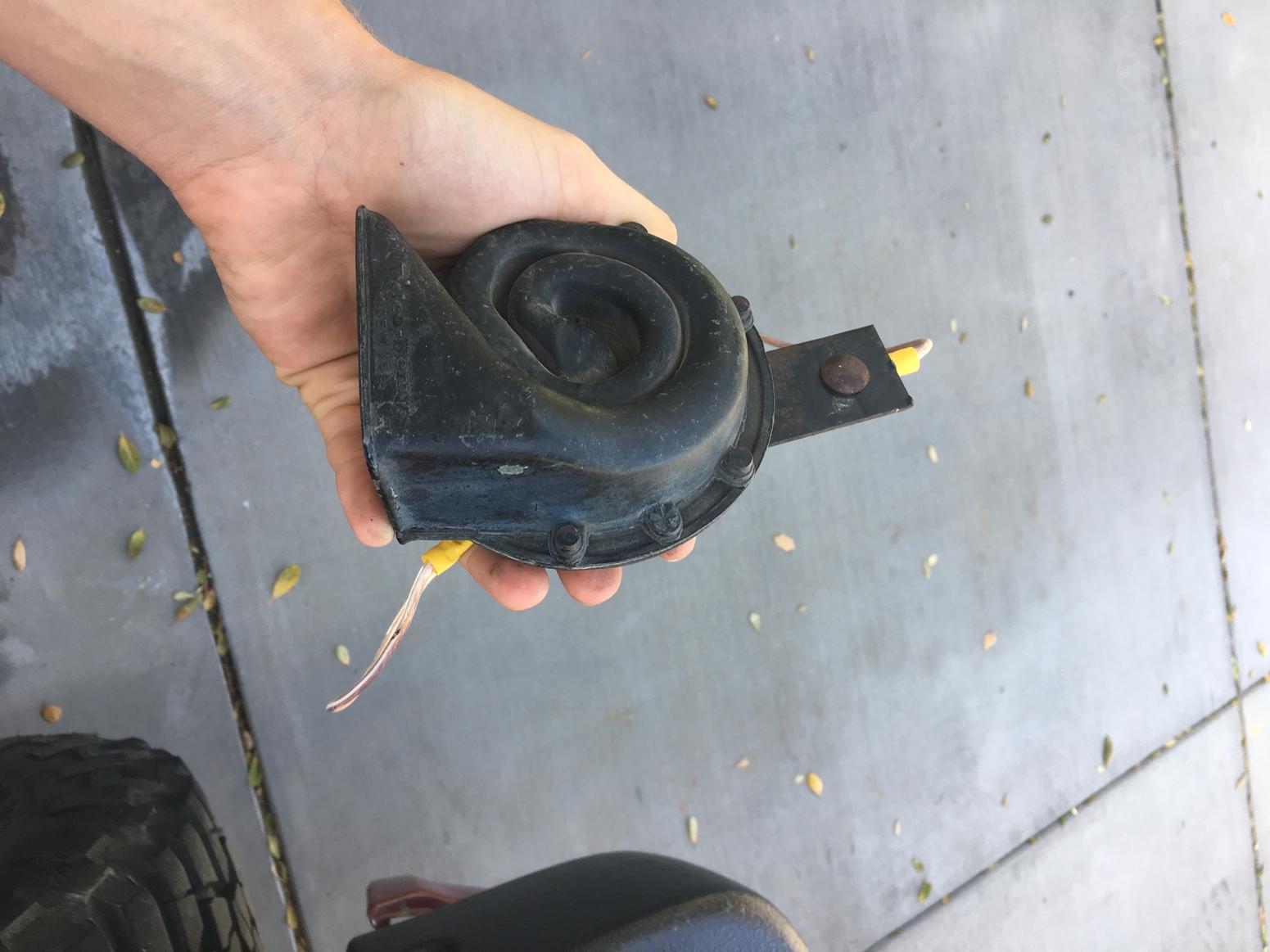

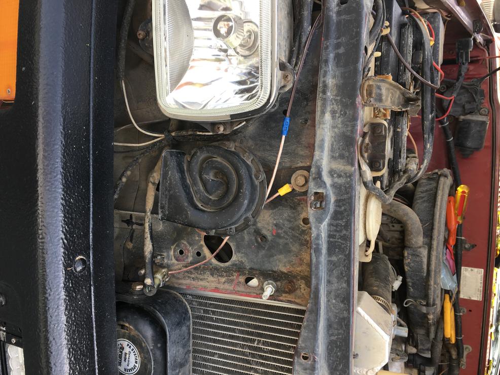

But since the stock Toyota horn has no nuts I figured I'd give this a shot! A 1968 Chevy Camaro horn.
Long story short, got it working by sending it constant power and a selective ground when the stock horn button is pressed. (Toyota horns are weird)
Sounds a lot better than that little wimpy Toyota horn, and fit nicely behind the grill! Works with the stock horn button.

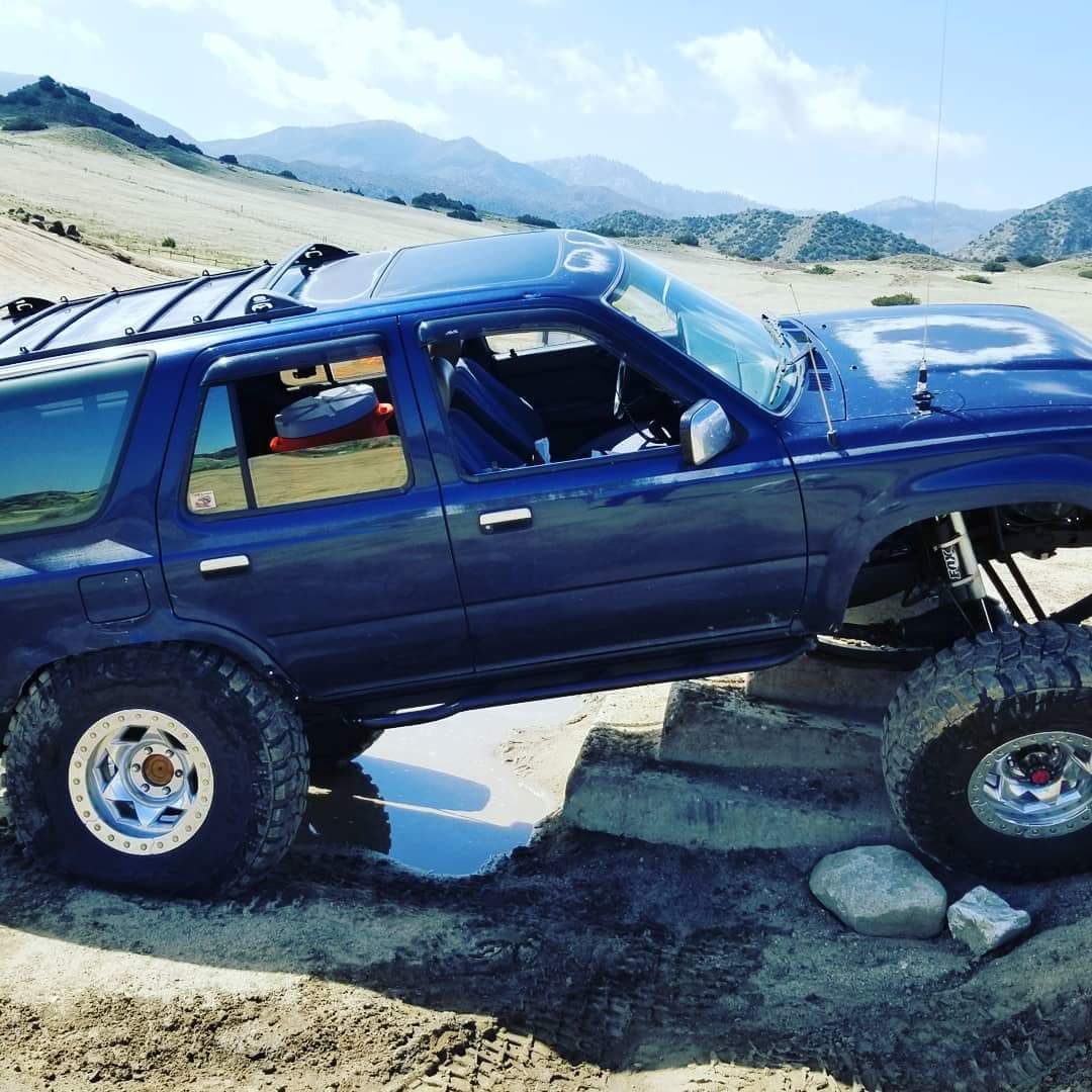

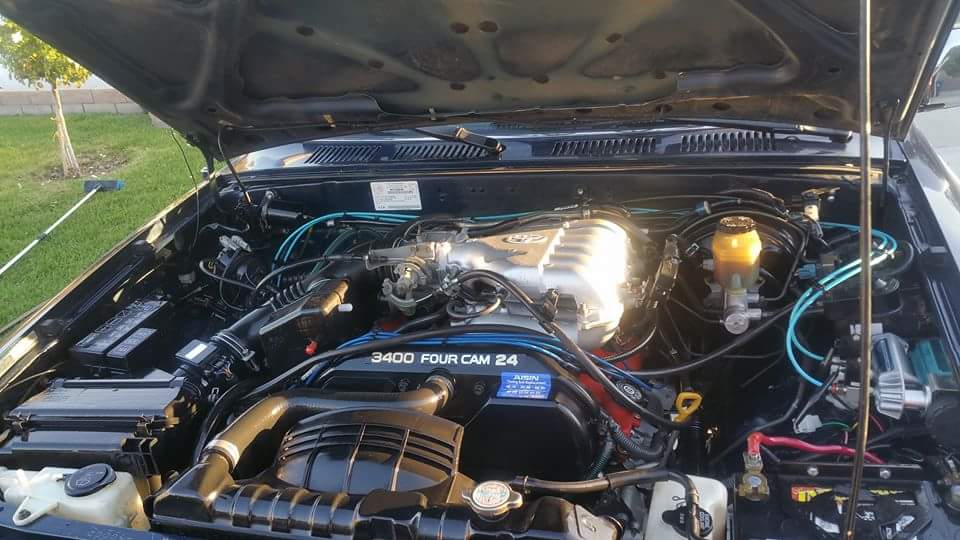

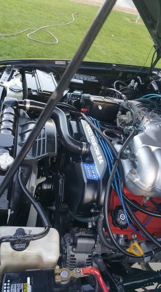

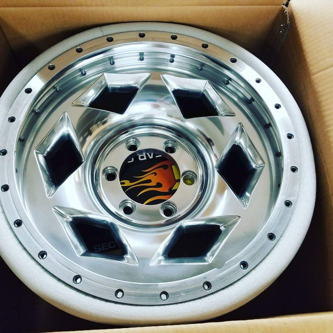

It's been a while
Long time since I've Logged on. Since then the 4runner had some changes and for the better I guess... :lookout::shrug::rockon::rockon:
