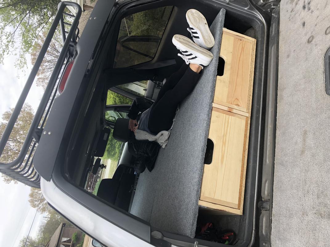

Just going to give a little teaser for now. I haven’t made the magical 15 comments yet and I don’t want to give away all the secrets before I can make a build thread. That being said I did a little more work on my storage / sleeping platform in my 95. Carpet in on! (Apologies for the sideways pic)

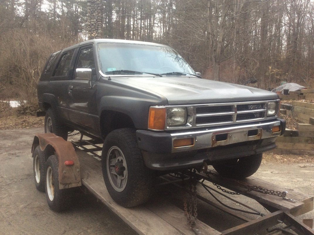

added another one to go with the '87.
an '88 3.slow, sr5, auto. a beater, not worth making it nice.

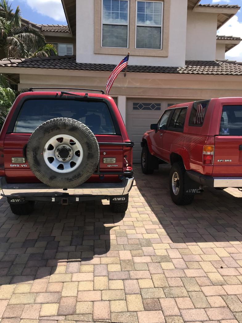

Finishing up the spare tire carrier install. Got lucky finding the correct color tailgate. Much easier than repositioning the backup lights.

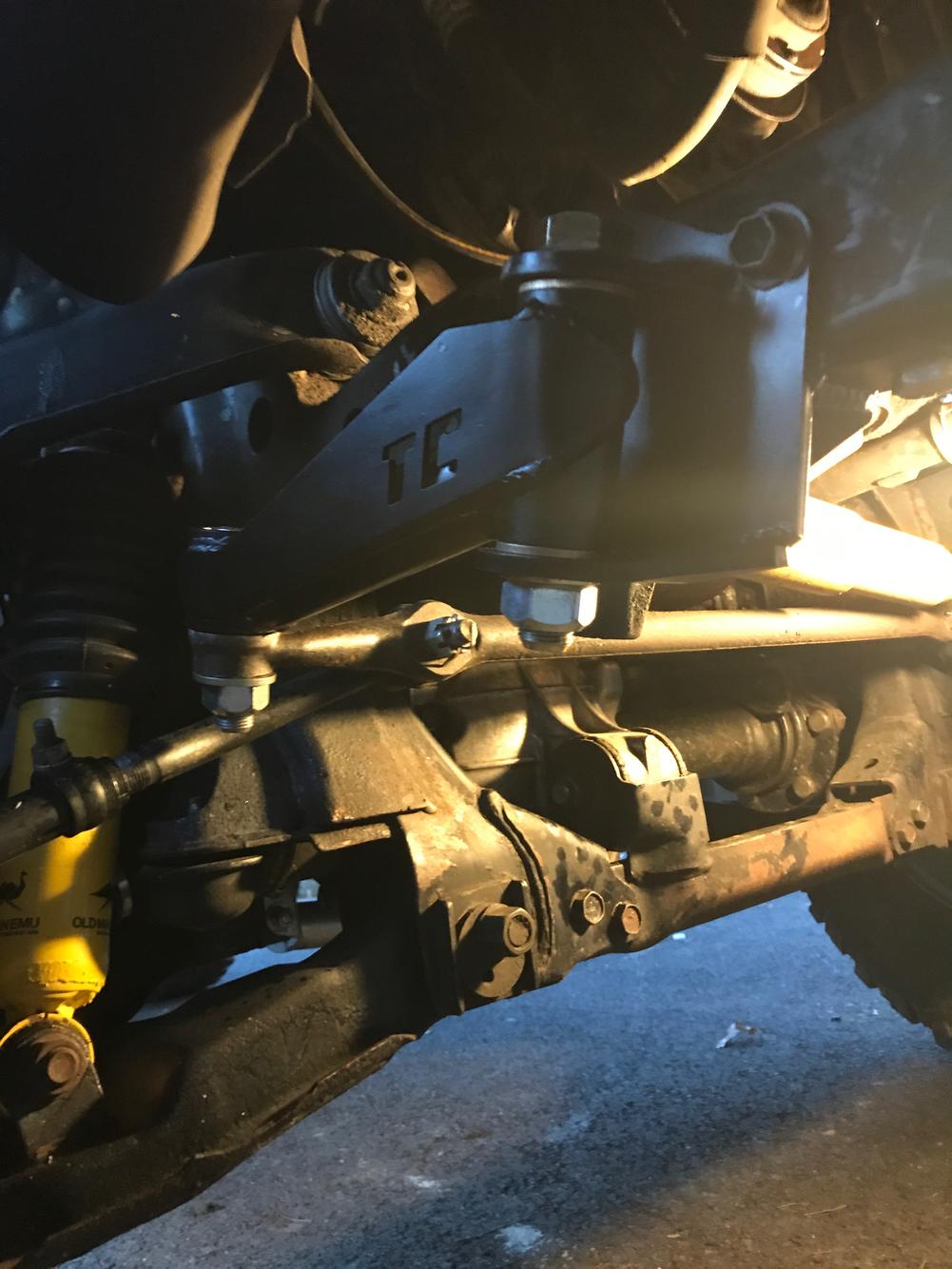

Today I installed my Total Chaos idler arm because i got tired of replacing stock idler arms. Bronze bushings & idler arm braces just exposed the next weak link...the small end that bolts to the centerlink.
Straightforward install, just had to drill the centerlink out to a 5/8" straight hole and chase threads on a fourth mounting bolt on the underside of the frame. Nicely made with ball bearings on the ends so hopefully it'll last till my sas.
