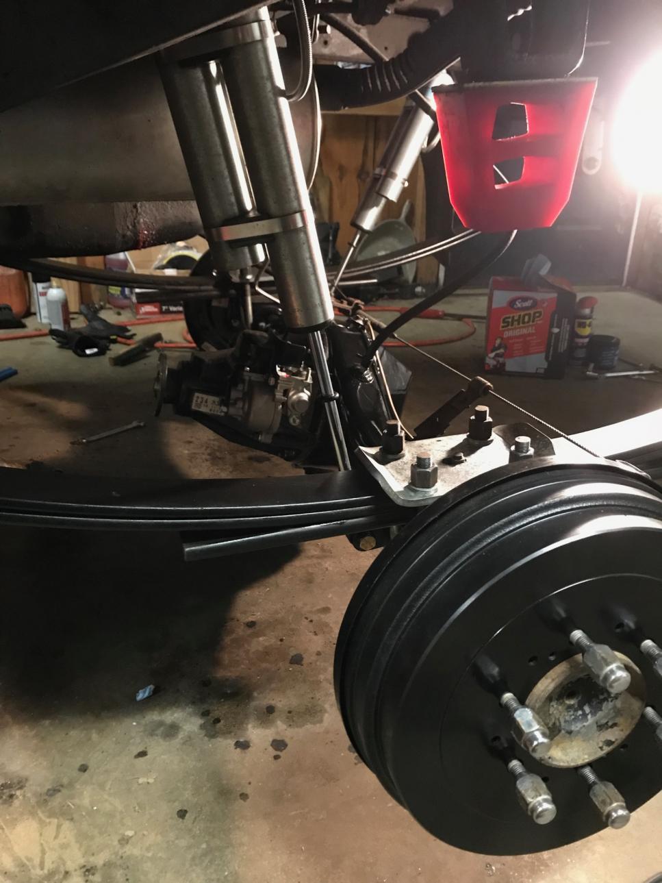

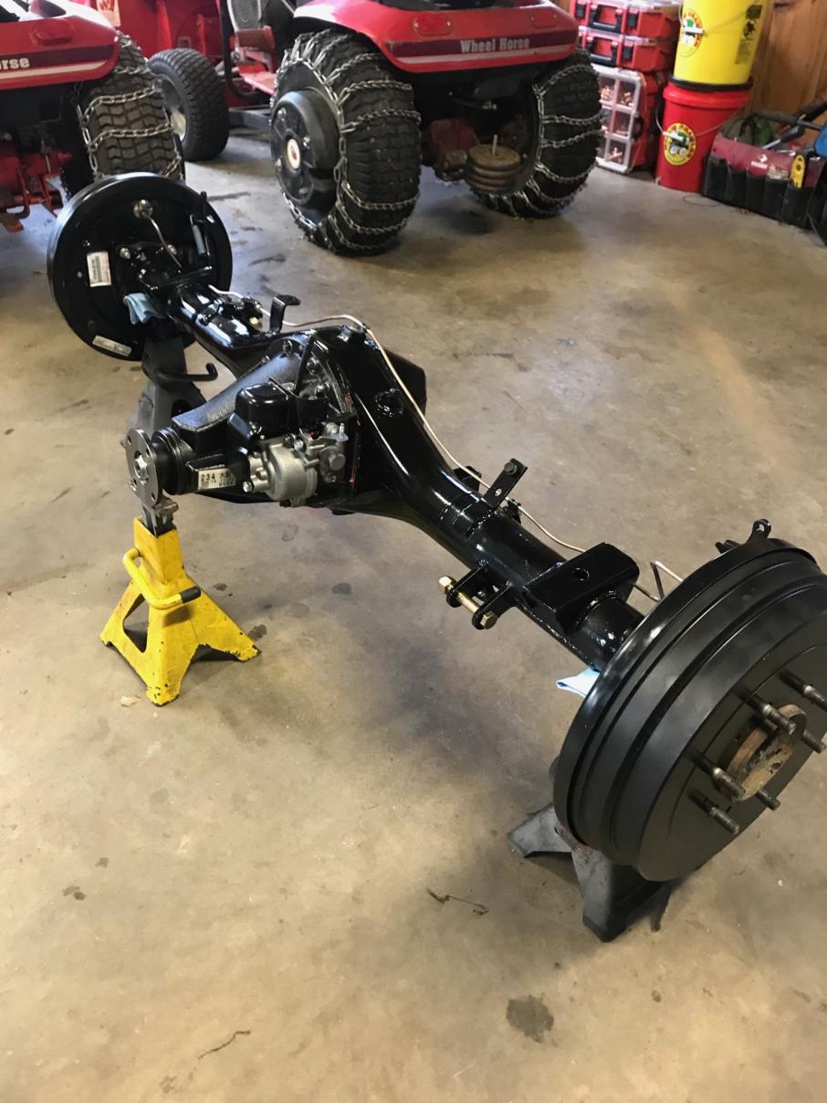

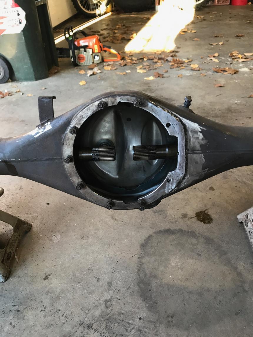

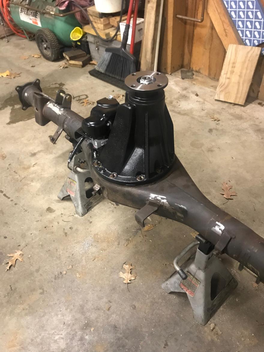

I finally got my new axle under the truck! Brand new 4.88 e-locker from marlin w/ 2nd gen 4Runner axles. The old axle had a Detroit Locker in it which was great off road but terrible on the street, so this selectable should be the best of both worlds! I still have to wire it though.

Nice! I did my sons 92 4runner last year. I have a detroit in mine and like you said its tough on the road. The Elocker was the perfect alternative. Looks like you built up the mounting area. Nice job, enjoy
