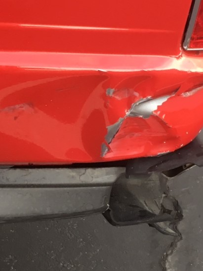

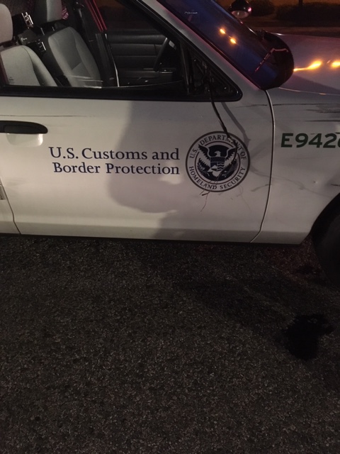

Bad day
My 87 took a hit today. I stopped to help a gal that was in an accident and then our trusted BP found it tough to look at the road while driving. Look at that nice clean metal under the once nice factory paint.
I'm pretty sure the bumper and plastics are no longer available never mind the quarter panel. Lets see how this plays out....

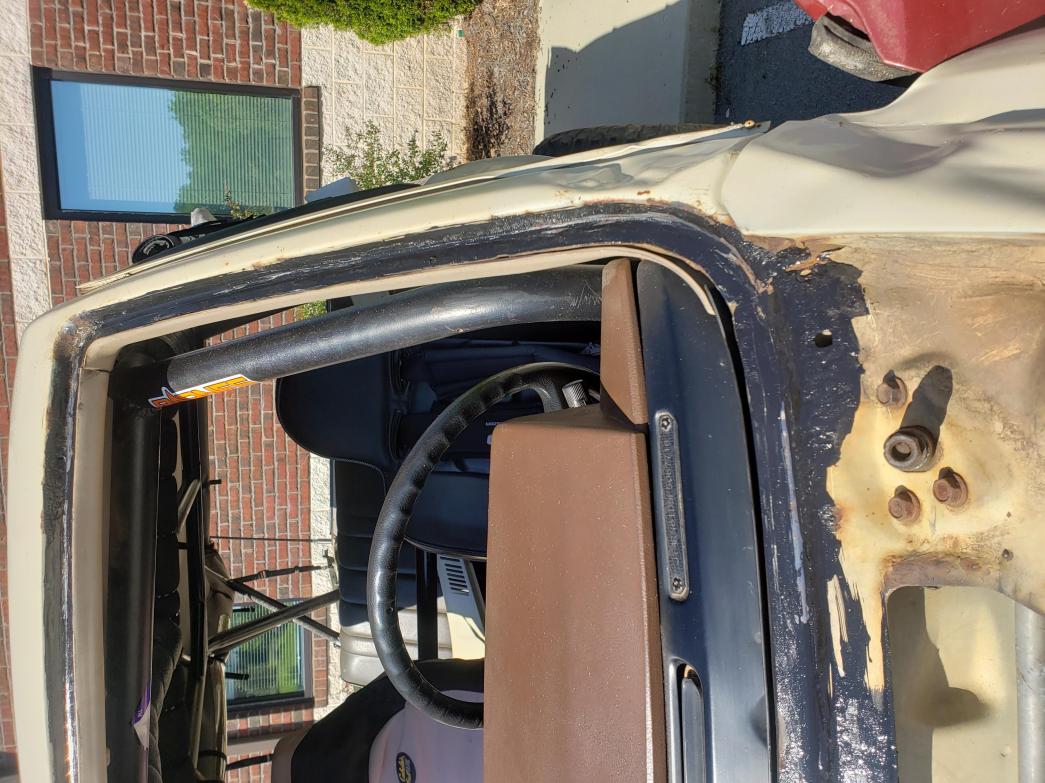

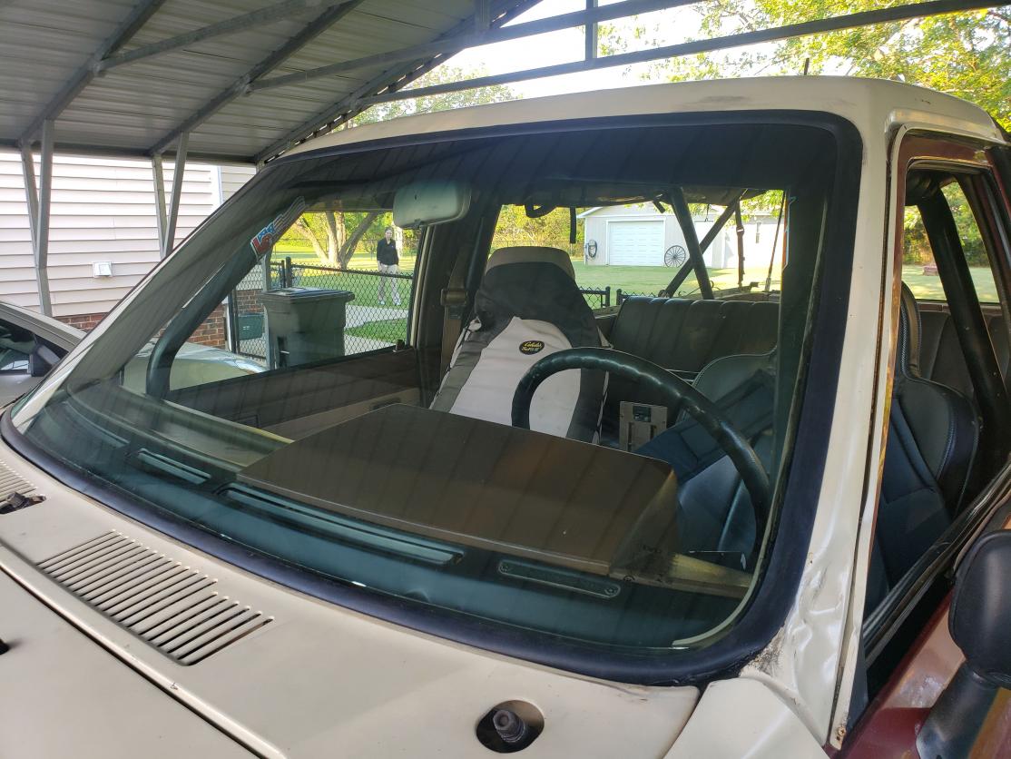

Got rid of my leaky windshield after 8 years of owning it. Was able to find someone who knew what they were doing and replaced all of the chrome molding with a nice rubber seal. Makes it look a heck of a lot better, even with all the dents.

Share more info about that, please!
Gasket part number, the mods he had to do, the guy birthday, etc.
Replacing the windshield chrome molding with a rubber gasket is a complicated thing to do IMHO.

Nothing was modified. He ordered me a new windshield, the original idea was to try and save the old one, but after watching him take the old one out there is about a 99% chance it will crack no matter how careful you are. He took a good 30 minutes with a grinder and got rid of the rust build up, mine had a little more due to a few small leaks. He then used a paint/primer that dries instantly and promotes adhesion of the glue.
The rubber molding was a universal part he just had in his van. It just pushes on to the windshield edge all the way around. It does kink some on the top 2 edges of the windshield, but once it is glued and put in the car you are able to pull the edges back out with a pick and push the window down. The adhesive dries almost instantly so once you give it a good push down it sets in nice.
He did say most big box companies wouldn't touch something like mine, so your best bet is to find a smaller company with someone who has been doing it forever.

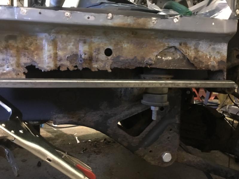

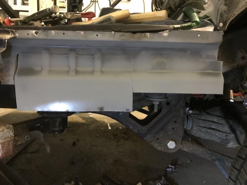

After spending ages removing rusty steel, I made a start welding in some patches. Still tons to do, but it's nice to finally turn the corner!
