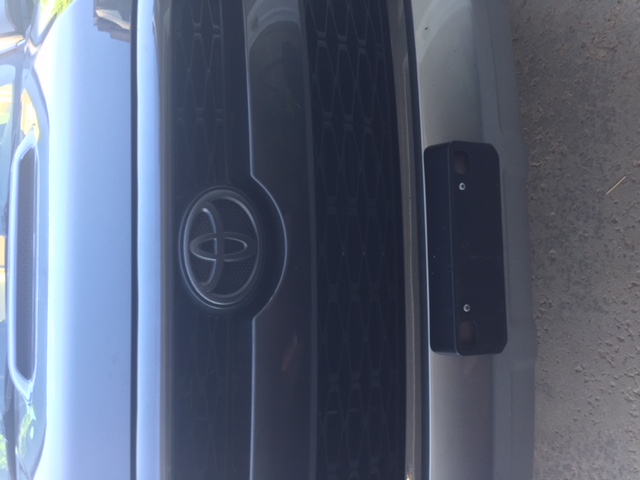

Front grille piece and chrome bumper strip (old pic; N-Fabs replaced with MetalTech sliders):

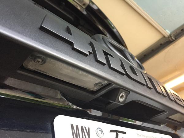

Rear garnish and bumper trim(I have since peeled the dip off the letters and logo):

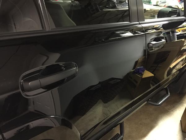

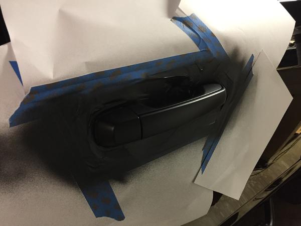

Door handles (which I have replaced with OEM black handles; MUCH better):
2012sr5-albums-2012sr5-s+t4r+pics-picture47013-6-coats-varying-angles-these-dipped-handles-came-out-well.jpg

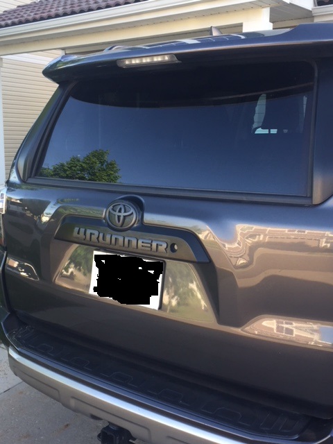

Hey Everyone, So I was able to find a plasti dip that matched pretty close to tha magnetic gray. I've read a lot of your positive and negative feedback about plasti-dip. I've painted a lot in the past, but this is the first time I've used plasti dip.
I wasn't super fond of the product itself and found it pretty lacking and hopefully it holds up longer than the "6 months" the can said. I was interested in this due to the fact that I've rear a lot about the hassle of removing the rear emblems and letters, and the only overlays are in black - if this plasti dip wears off I'm going to buy the overlay and paint them with a real matching paint. However, Posted are some picture of my final products with the front emblems, rear emblems and 4runner with a graphite plasti dip This will probably be the first and last time with this product as like i said, I wasn't to thrilled with it.

It will last longer than 6 months if you apply enough coats. At the end of the day, it's not a permanent solution anyway. What specifically were you not happy with?
That's what I liked most when i looked into this, the non permanent being the biggest pro and being able to get different colors.
The two big things I wasn't happy about was that even after 6 coats (maybe I went to light) when I started peeling the excess it would continually rip going around the letters and in the corners of the emblems - which didn't ruin anything, but made it more time consuming using a toothpick and a tiny flathead screw driver to get in and get the excess plasti out and make it clean.
Second, which this could just be this particular one; The Plasti I got had a metallic flake to it, but when it came time to peel the plasti off those flakes would NOT come off with the plasti dip itself and remained behind on the black trim. If it doesn't weather off I will have to go back with goo gone and a q tip to get the flakes off - it gave me a cheap product feel
This is nitpicking, but I had to keep cleaning the nozzle of the can after every coat because it would constantly get build up and wouldn't have a consistent spray. Which I'm assuming because it's a rubber like compound?
