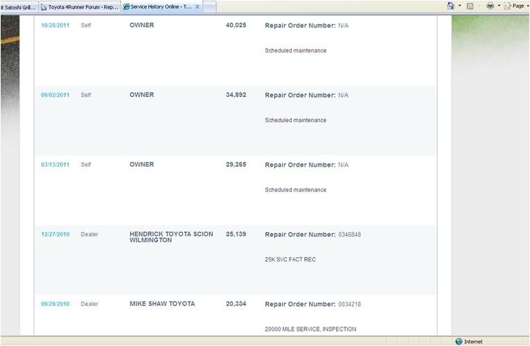

Not sure about the Canadian site but Ive been registered at the toyota.com/owners site since I bought my truck in 2010. The dealer serviced the vehicle until 25k and Ive serviced it since. All of the dealer services show up but as you can see, you can also add your own service records every time you do scheduled or other maintenance. I back these records up with reciepts for the items purchased to service the vehicle so if / when I ever do sell it, there will be a chronological history of all the maintenance that has ever been done along with reciepts to prove Im not full of it. Also, there are digital copies of the owners manual which is very convenient. Overall its a very useful site and one definitely worth registering at, especially if you are purchasing used.

don't think .ca has the same functionality as .com
