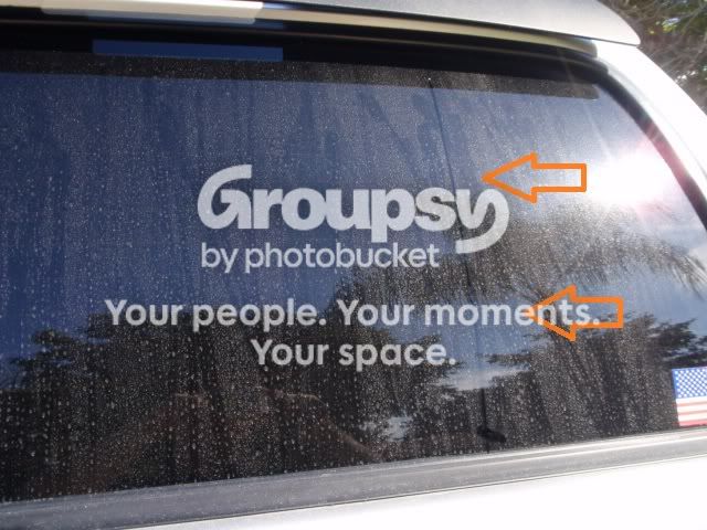

What is causing this scratch on my rear window.
xcmountain80
Good morning T4R,
I noticed this line on the window when I washed the truck last, so I figured I'd let it get good and dirty and narrow it down. So here it is good and dirty and leaving a not yet visible but it will catch your finger nail type scratch.

Roll the window down all the way, take a cloth rag and spray some cleaner on it (windex works great), with a finger, shove the damp rag down between the rubber and move from side to side. You could carefully pull back the rubber before you lower the window to see if there is something there BEFORE you lower it.
I would guess that you have a speck of sand in that rubber.
I do this with all of my window trim (top, sides, bottom).

I have the same scratch, but its WAY deeper. I removed the rear hatch panel to find a bolt holding the wiper motor(I believe from memory) had begun to back out and was contacting the window. I would suggest taking 10 minutes and do the same. Open the hatch, remove the panel and take a quick look. Once opened up, the offending bolt will be easily to see.
Just my experience.

That was it! 15 minute job deep 10mm, plastic putty knife for the trim and an extension made life a breeze. Went ahead and tightened the remaining motor bolts as they were all loose.

I figured that it was the same loose bolt that I had. Sucks because now I need to find a rear window for mine. I hate that scratch back there.
