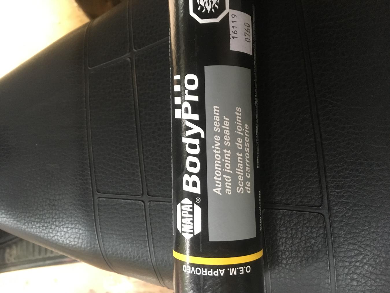

Depending on where it is, it could be a version of this stuff. This was a very good match for some spots that needed sealing in my corolla due to a previous accident.
