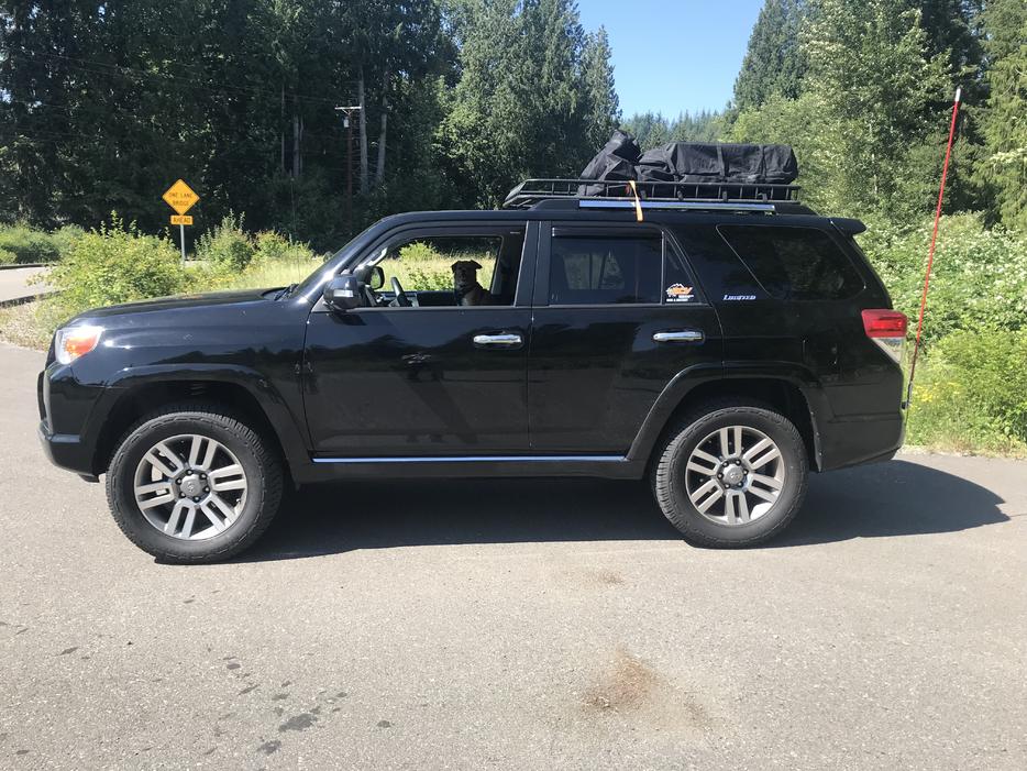

I’m running 275/65r20 (equates to 33”x10.8”) on stock l.e. wheels they rub a little on the front of the front fender liners when backing up and turned fully but even after swapping suspension I have not experienced anything more. Full size spare under the rig too
