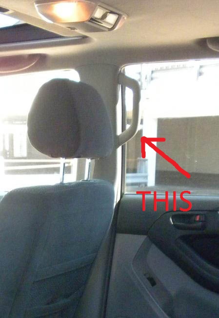

My google search hasnt turned up anything, the only term I could think of was "rear grab handle", which didnt turn up anything helpful. I need to know how to remove the part (handle) temporarily from my 05 4runner, and the trim to get to the part.

I believe that would be the "oh shit" handle. Have you opened the door and looked on the other side for fasteners?
The bolts holding the handle are behind the trim piece. The trim piece itself is held on to the b-pillar with plastic tabs/clips that hold almost all trim panels on.
Thank you both for the comments. I just came in from messing with it. I was afraid Id break the trim just trying to yank it off. I was able to get the trim off with a little flat bar and think I managed to avoid breaking anything. The seat belt height adjuster seems best in the lower position, the lower edge of the trim seems firmly behind the lower trim, the top edge of the trim is behind the headliner and the piece seems to need to flex in the middle to come out. I could see the 10mm bolts holding the handle on with the trim only half off but couldnt get to both of them. Theres a white plastic piece bonded to the grey at the top, I think it will survive, I thought it came off....

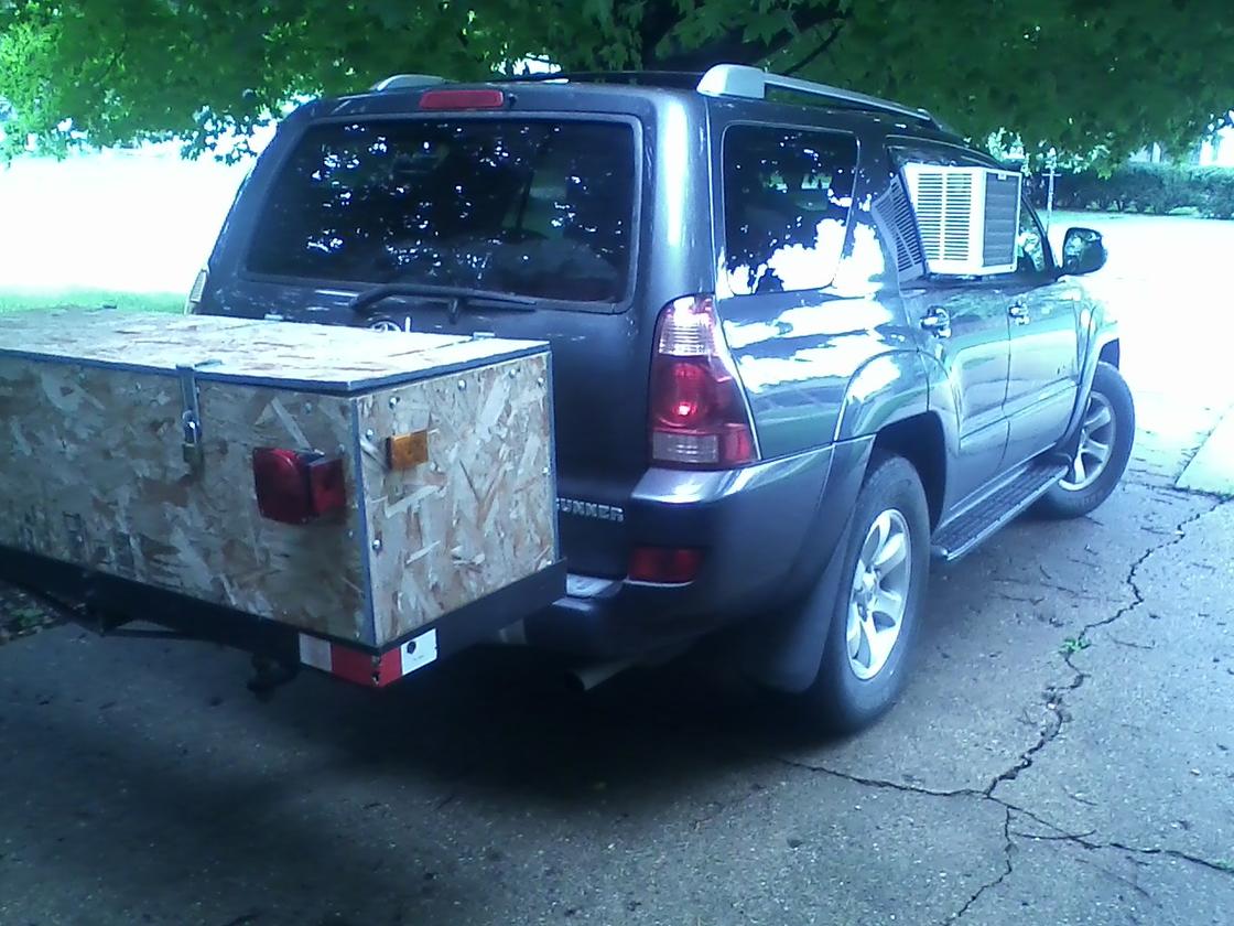

OK, now on to the the hillbilly stuff. The handle was in the way of the window AC. I was going to try to put the AC in the rear cargo box, but in the side window looks simpler, no ducts and no cutting the cargo box away to nothing so the AC can breathe. Looks like the Honda generator will be OK in the cargo box with an intake air vent in the bottom and the exhaust/engine cooling air directed right out the side.

OK, now on the the hillbilly stuff. The handle was in the way of the window AC. I was going to try to put the AC in the rear cargo box, but in the side window looks simpler, no ducts and no cutting the cargo box away to nothing so the AC can breathe. Looks like the Honda generator will be OK in the cargo box with an intake air vent in the bottom and the exhaust/engine cooling air directed right out the side.

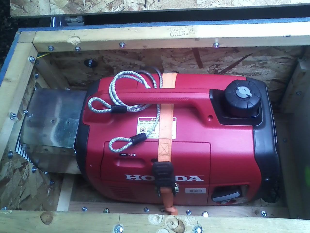

The generator will be in a cargo box on a hitch mounted cargo carrier, not inside the vehicle. It may be fine just venting it out the side in the engine heat dump vent, but am also looking at exhaust extensions that can get it further away. I havent gotten it complete yet to test.

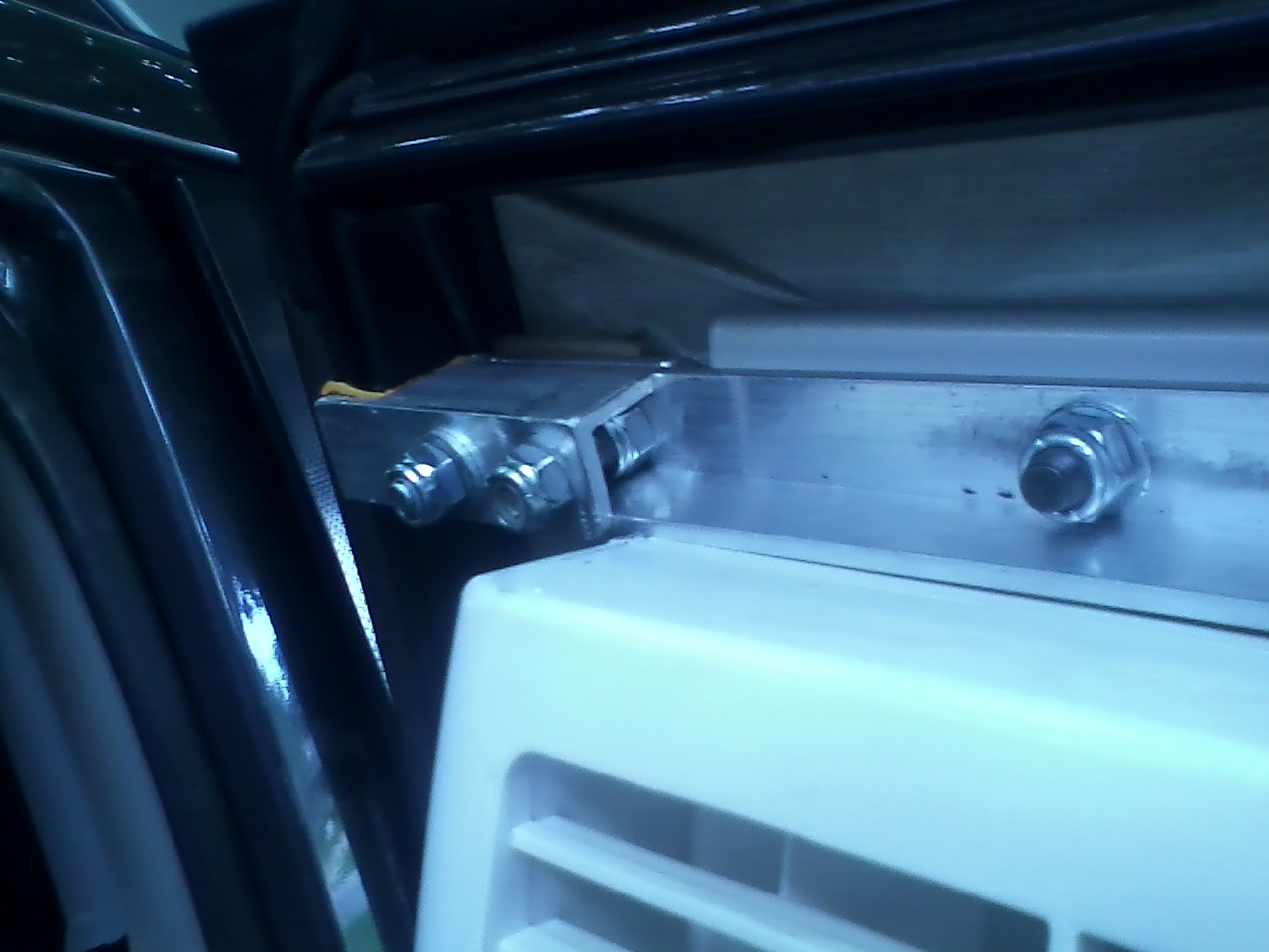

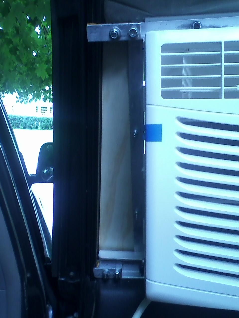

I have some aluminum angle that im going to make brackets to mount the AC in the side window, and fill in around it with lexan. Looks relatively simple and mostly not permanent to the vehicle.

Full Hillbilly
Have finished the generator and window AC install. Seems to work fine so far, but may need to get a hard start capacitor if I want to run the gen on Eco mode.
Update: I did end up having to use a hard start capacitor to get the AC to start reliably on ECO mode on the generator. It was $12 locally. I just zip tied it to the side of the AC unit and ran the wires and connectors in through a hole and piggybacked them on the existing small capacitor. Theres a lot of info on them on various RV and boat forums.
