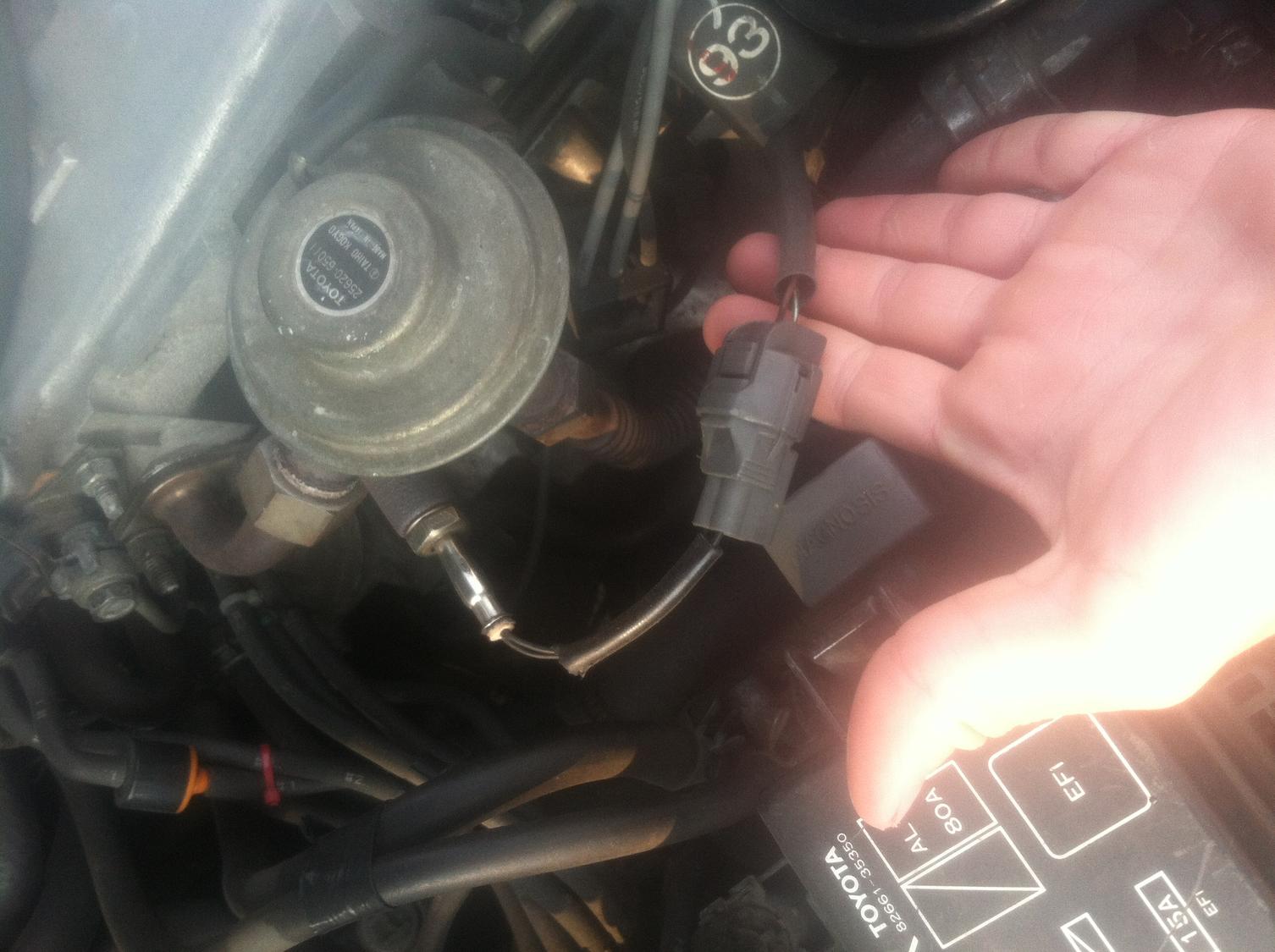

Hey well i went out side and snapped a photo of it anyways. Good thing i did because the wire actually comes across from the drivers side. It comes across along that bridge like the spark plug wires does. Hope it helps bud

I don't have a pig tail coming out at that location. But I did find a pig tail tucked under the battery with the same connector. The po has some funky broken thing plugged in to it....to fool the computer I guess. So my guess is the temp sensor is bad. Now the sensor is just the brass part right? And it's $130 for a new one?:wow2:
I have a resistor in my plug to fool the computer. If you plug the line coming to the egr thing it should rujnbbetter when cold.
Yeah it's just a stupid sensor for the computer. Yeah i'm pretty sure i looked at the parts store, then went to the junkyard. And as you can tell it's looks like a new piece haha Best of luck bud
