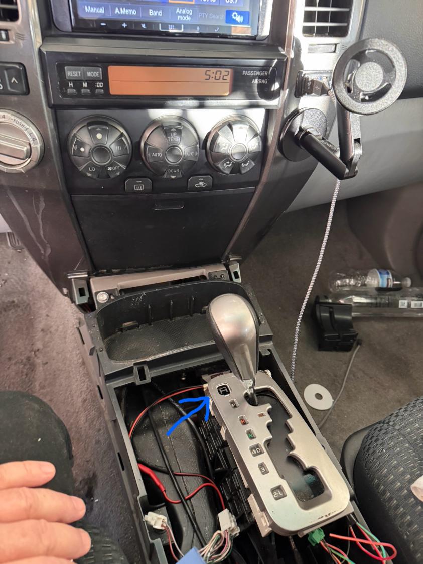

P Pirate702 New member Oct 12, 2025 #1 The button is above the P on the parking selector there’s supposed to be something there. I don’t know what anybody have any ideas? Attachments IMG_4362.jpg 132.5 KB · Views: 299

cwilliams563 Member Oct 12, 2025 #2 Pirate702 said: The button is above the P on the parking selector there’s supposed to be something there. I don’t know what anybody have any ideas? Click to expand... It should have a little cover over it that is removed when you need to depress the button. The button is a bypass to take it out of park if needed without the ignition key. Excuse the filthy 4 Runner

C Cezar Member Oct 12, 2025 #3 Thanks for the reminder I need to replace my cover after mice chewed my crankshaft sensor and I had to drag the 4runner around. Ten bucks on amazon.

G gshoeman New member Oct 13, 2025 #4 That is the shift lock override button, they are on amazon for around $9.
