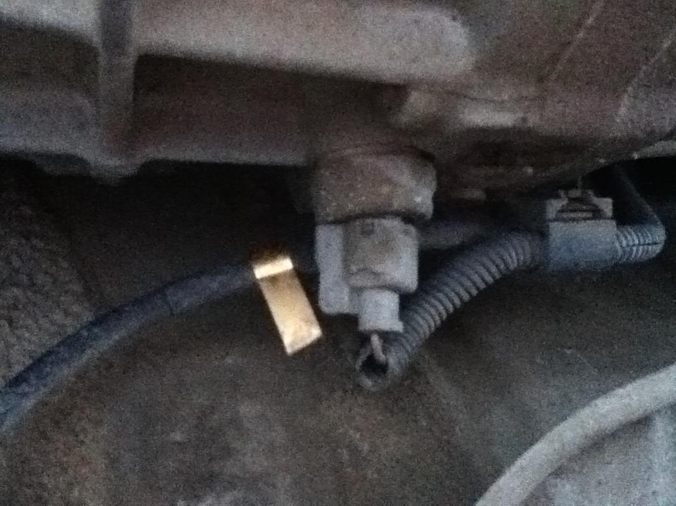

Hey Guys, the back-up lights work, but wires are still attached, so it probably is the same sensor. Please see the attached picture.

Ha, I'm a pro at breaking my stuff, this is the girls ride and I'm only allowed to work her toys, she knows I break all my toys. The inner plastic broke off, when I was re-installing the transmission after doing the clutch, so the connection is no longer dirt or water proof and if it is only a $50 part, might as well fix her stuff right.
So unplug it, and see if the reverse lights work just to be sure. But it does look like the back-up switch. I'd be happy spending $20 for an Echlin, they make pretty good stuff.
