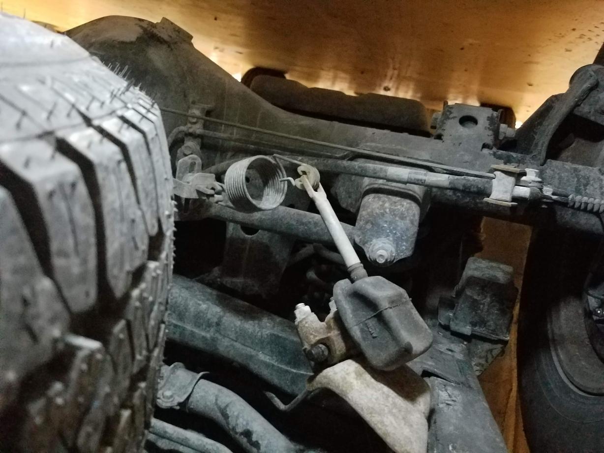

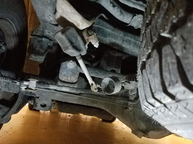

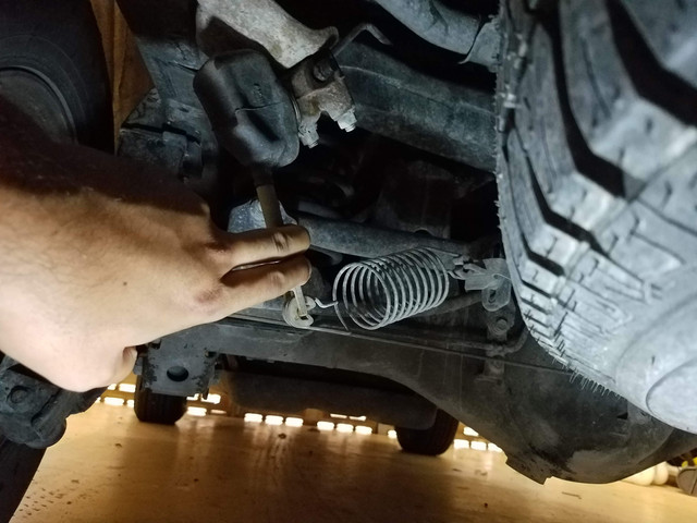

Is my valve just broken? I feel like the default state should be with the spring fully loaded and the arm down. My default state is with the spring fully relaxed and the arm up. When I pull down on the bumper (adding a load), it seems like the arm wants to go up, which can only work if the default state of the arm is down.
Default state (unladen) with spring fully relaxed and just hanging loosely. Arm all the way up.
What I think should be the unladen state, with the arm all the way down and the spring fully loaded.

Thanks. What is the unladen distance you quoted earlier? I couldn't find that in the manual you posted.
That wasn't me. And I have never seen one of these; except I was looking for one on mine many years ago because of the manual. I have ABS, so I never found it.

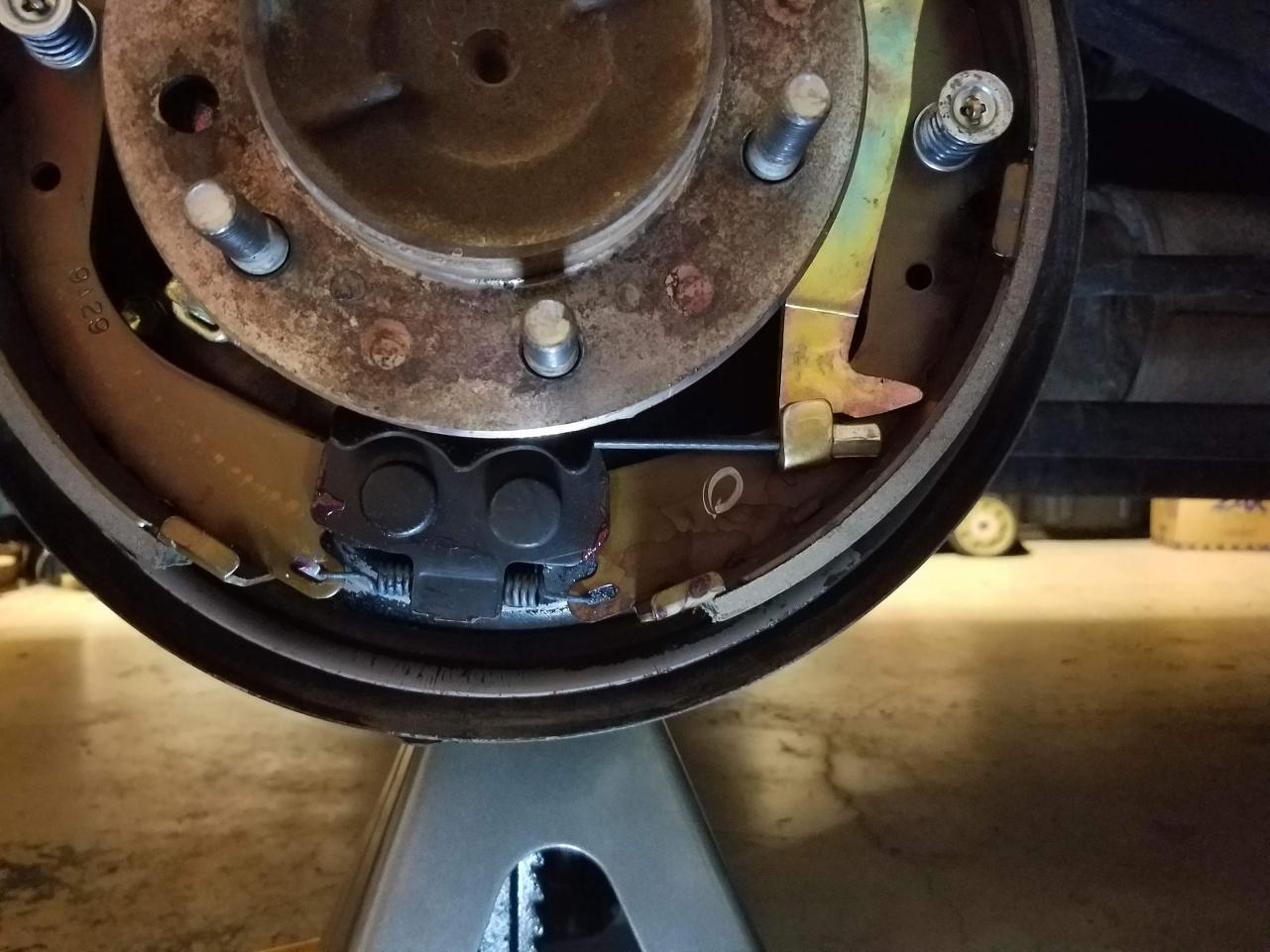

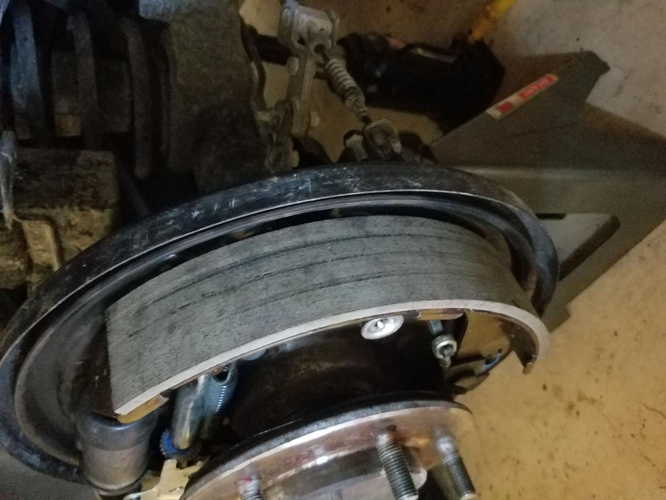

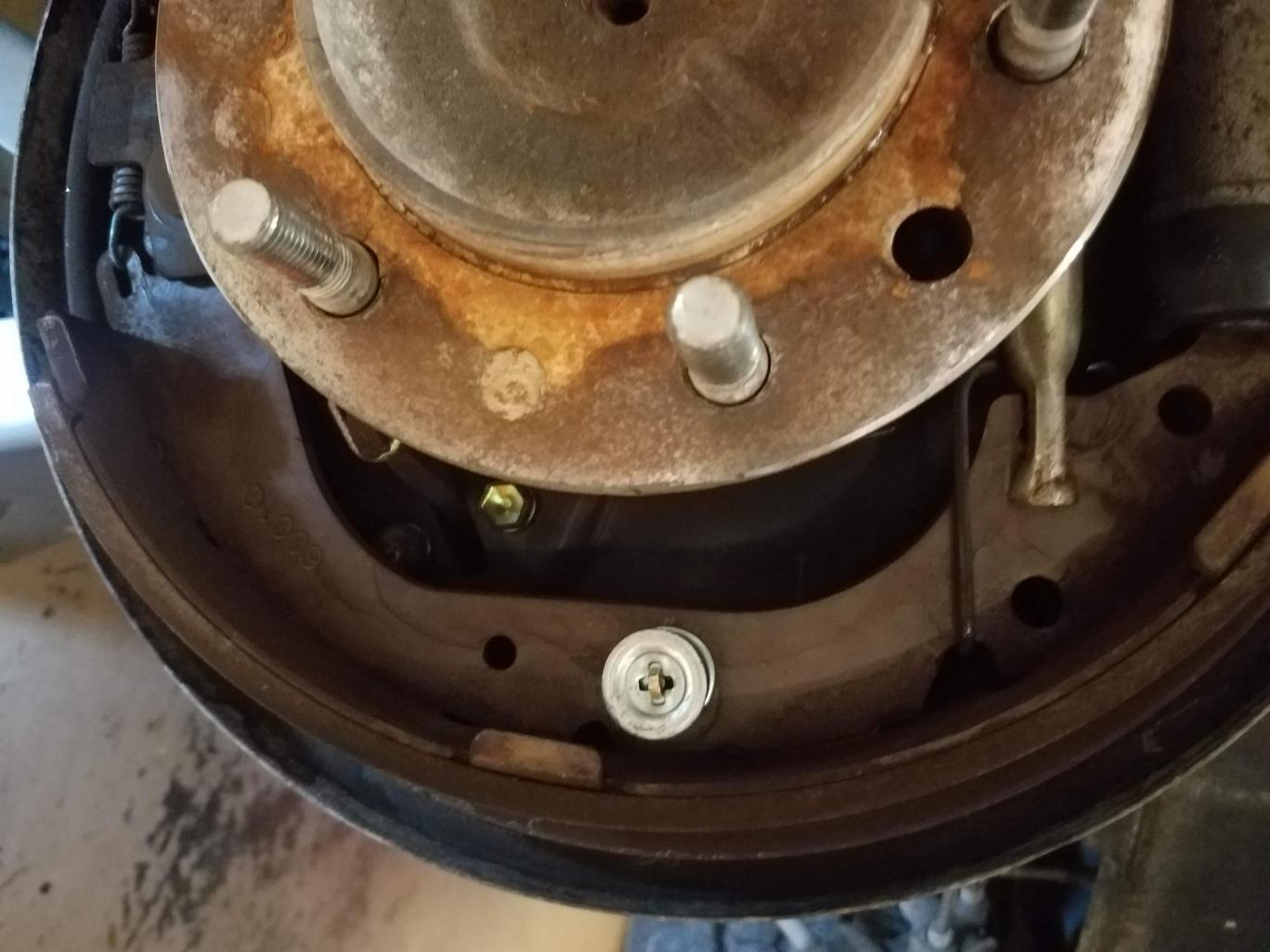

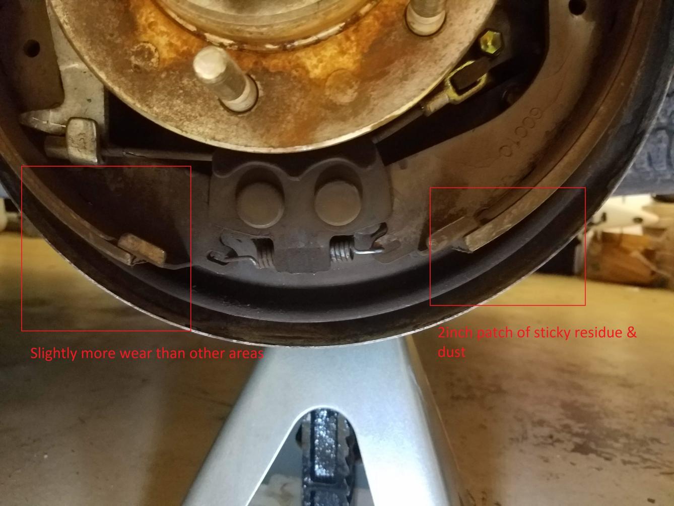

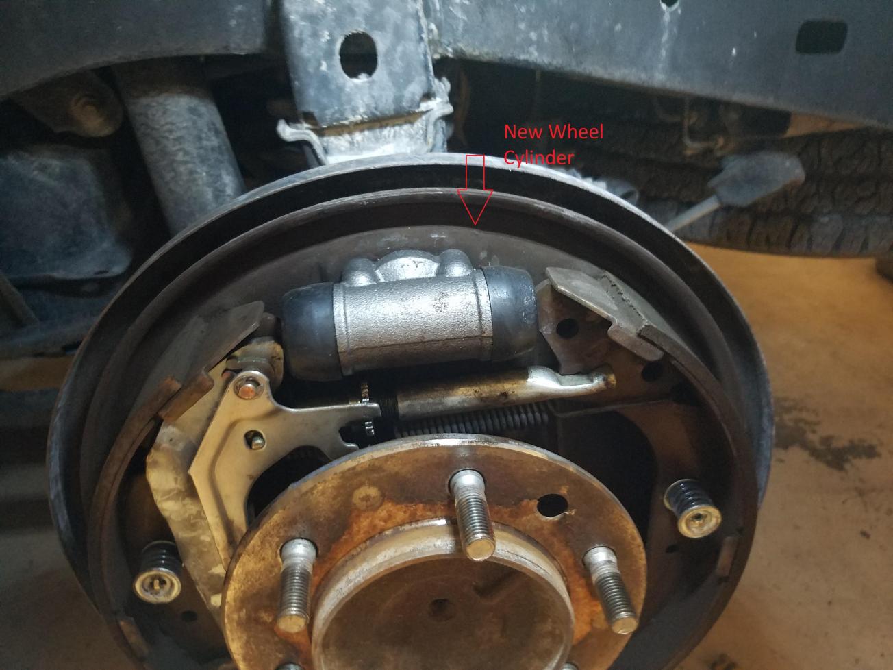

It might take me a bit to get the car jacked up to take pictures, but meanwhile I have pictures of the drivers side drum before I started disassembly. At this point, it is all original parts, except for the wheel cylinder. (had the problem before replacing wheel cylinder too) To replace the wheel cylinder, I popped off the c-clip for the adjuster arm and pulled it off the pin (but didn't remove the spring) to make it easier to turn the adjuster to max so I could slide the cylinder off. I adjusted the shoes after installation.
Some things to note. This problem isn't exclusive to the e-brake, it's just easily reproducible using the e-brake. The old shoes had plenty of meat left, but had more wear on the bottom where all the dust gathered forming a 2''x2'' sticky patch on the shoe facing the rear. Maybe the 1 shoe was getting stuck? I also never adjusted the e-brake as the shoes wore, so it would take 10-11 clicks on the e-brake handleto set. After the new shoes, it takes 5-6 clicks.

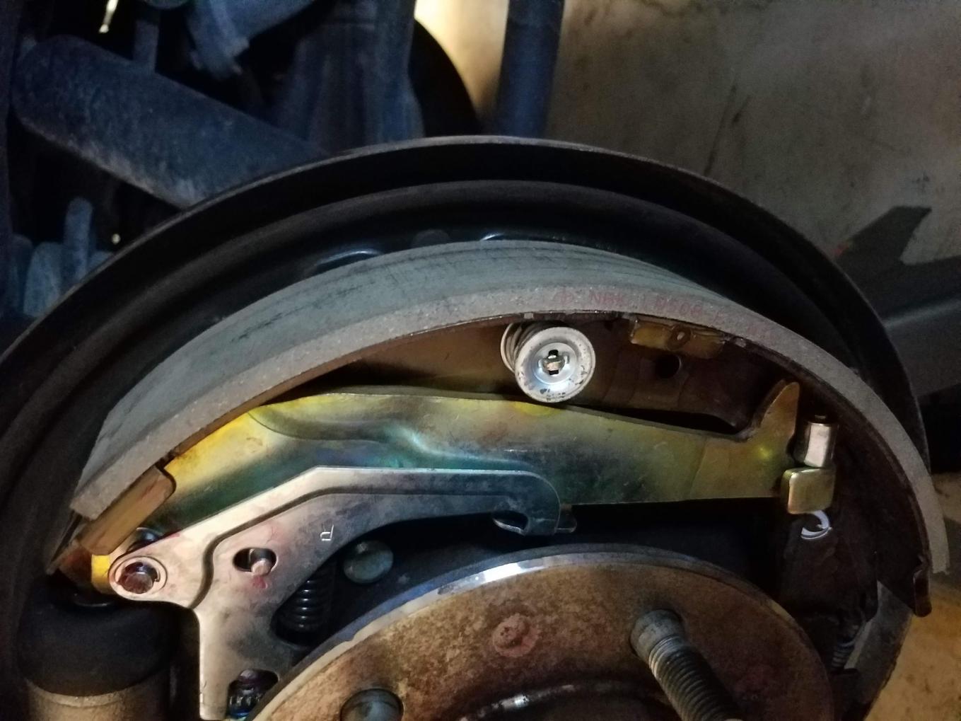

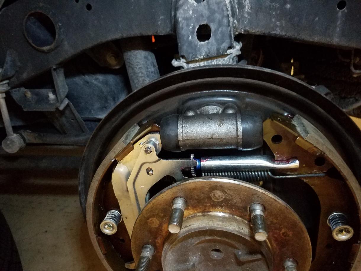

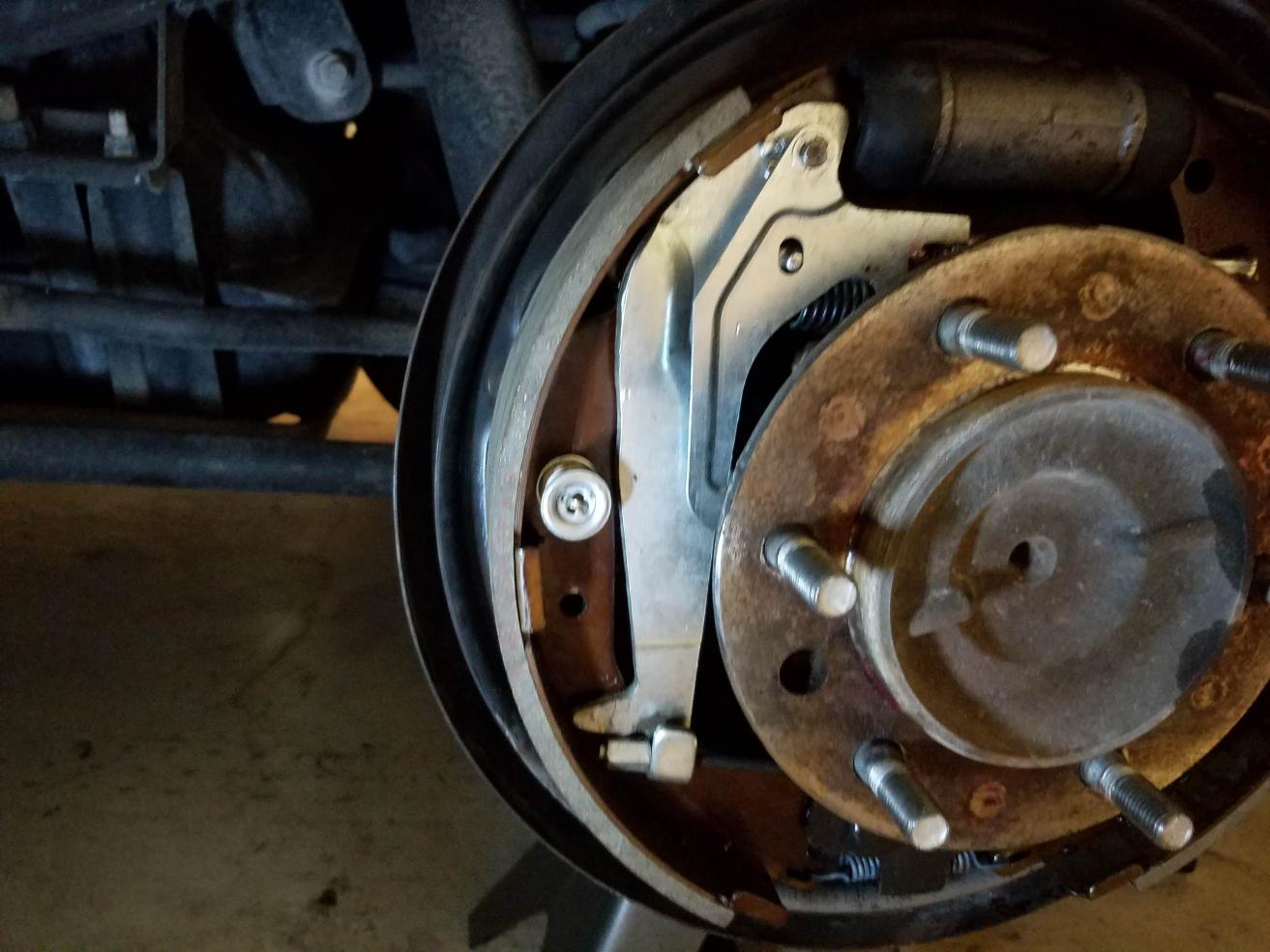

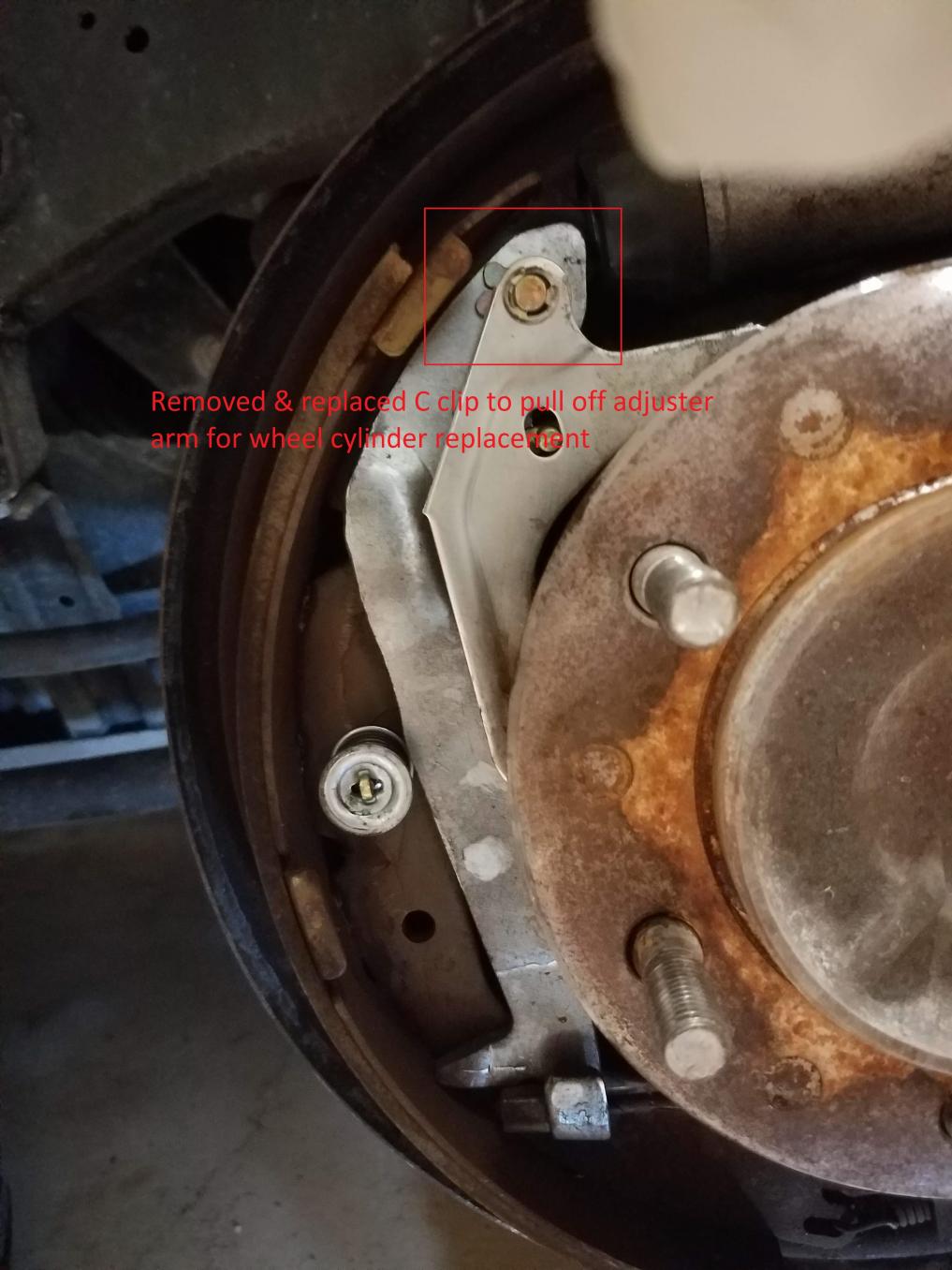

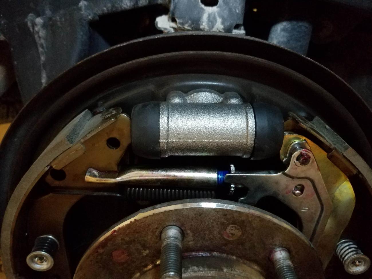

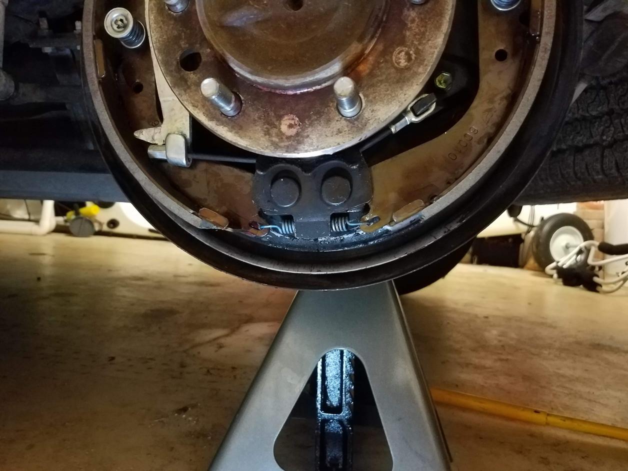

Adjusted the bellcranks tonight so I took some pictures. I didn't see anything out of place, but could use another set of eyes. I also notice my new shoes has some funny wear marks after 30 miles of driving already. I can now feel some light grooves in the drum that I'm not sure were there before. Guess I have to go get new drums or have them turned.
Are those grooves worn in the new brake shoes or just streaks? The hardware looks to be set up properly from what I can see. The way I usually adjust the rear brakes is to turn the adjuster with a flat head screwdriver through the backing plate until there is just the slightest amount of drag on the drums. Assuming the brakes are setup properly, are you getting good fluid flow through the bleeder valves while bleeding?
Those are streaks. I do the same thing on adjusting the drums, then I pump the hand brake until I don't hear the automatic adjuster clicking. I did get decent fluid flow eventually when I bled the drums. I have a brake bleeder hand pump, but we had to try the pump the brake pedal method a few times to get things going. (again a sign of a tripped valve?) I did notice the LSPV bled much easier than the wheels. I feel like the calipers bled easier than the drums too.

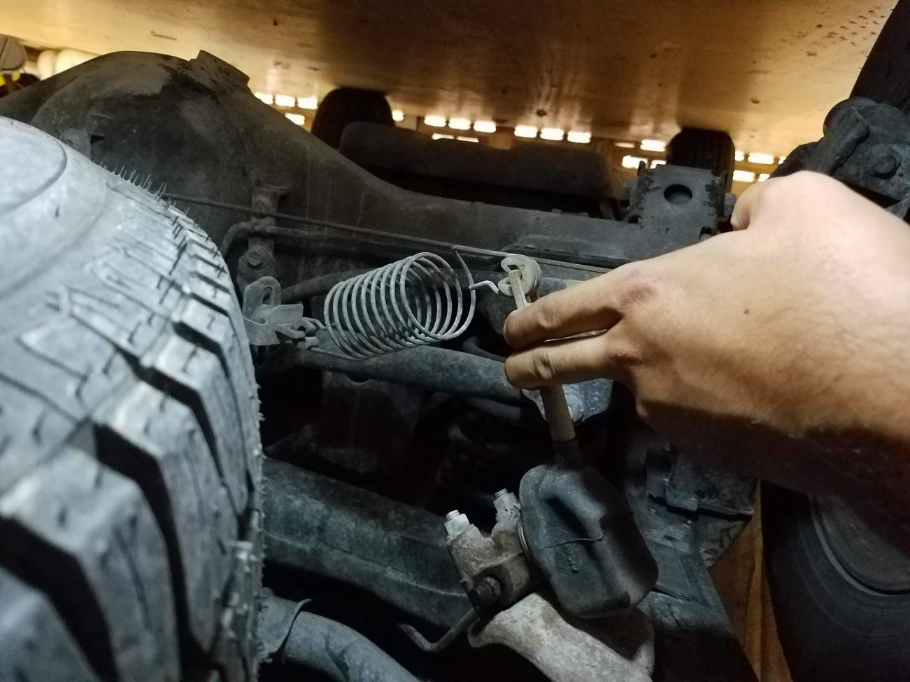

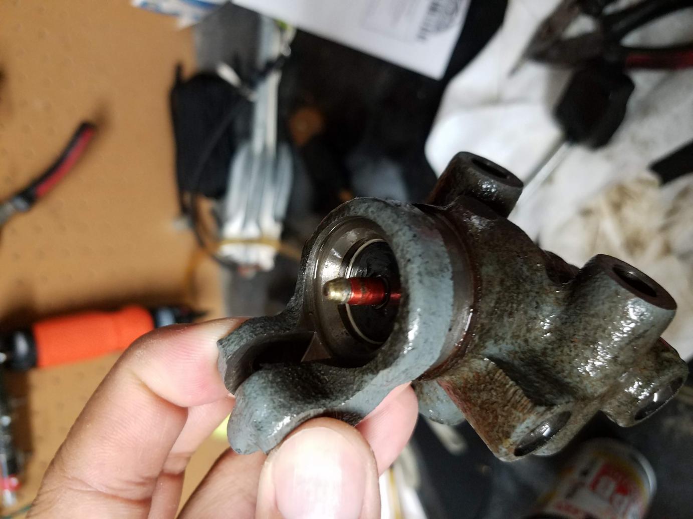

I pulled the LSPV valve off and it appears the piston (red rod thing) is seized. I would assume some type of spring like response from it, since it is connected to a lever with the load spring. There's about 1/8''-1/4'' of play on the piston, but you need to press/pull hard. Once it's in, it stays in, once it's out it stays out. There's also a bypass valve that somehow rides ontop of this piston, so perhaps that part is seized too? Seems like I need to replace it regardless, so hopefully this is my problem.

Final update. Replaced LSPV and problem resolved. I'm still unsure how the system works, because even with a new valve, the lever is in a permanent up state, so I don't understand how it's supposed to adjust load, when a loaded chassis will make the lever go up even more?
Anyhow, for anyone replace theirs, remove the spare tire first or you can't see the brake line coming from the MC. I cross threaded the fitting for that brake line working blind. I had to chase it down with a die cutter. Turned a 20 minute job into a 2 day job.
