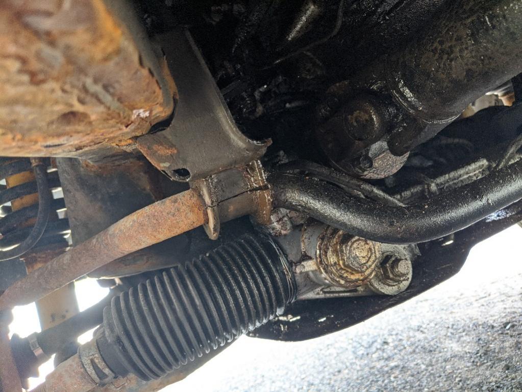

I haven't been under the vehicle to see what's missing. I feel like I've had this off, in my hands, during a previous repair. My first thought was a retainer for one of the sway bars, but they are all in place. I probably won't have a chance to get under the vehicle till tomorrow...

if a sway bar bracket. you will notice some difference in driving and possibly a clunk. From picture thats my vote too.
If a steering mount I would assume you would feel a real difference in driving....danger...I would not drive.....just my 2 cents on that.

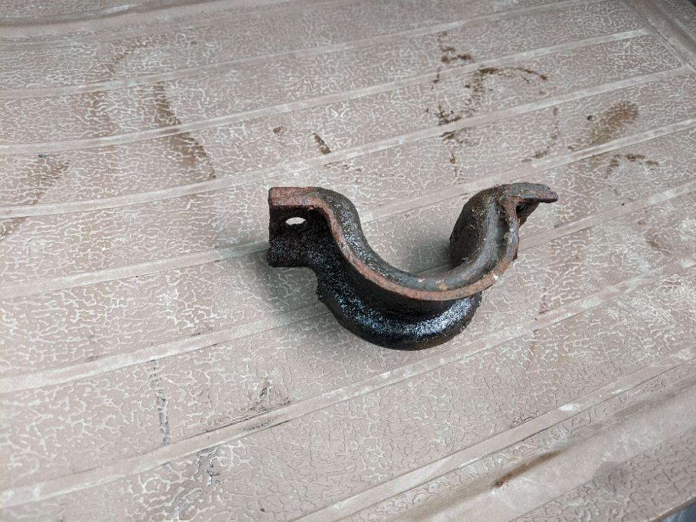

Ok, so my bad, sway bar bracket was my first thought and steering was my second. I had a quick look under the vehicle and and both seemed to be in place. Hence this post...
But have a look at the attached pic, the bracket was missing but the bushing was still in place... Like I said, quick look ;-)

Ha, funny story actually. During a previous repair, due to all the rust, both bolts broke off in the nuts that are welded to the frame. So I drilled them out and used two new bolts with nuts. I guess they had been rattling around for a while without my noticing and eventually rattled right off when I took a big drop into a puddle that was deeper than it looked. I heard the part hit the pavement and actually saw it through the back window. Contemplated leaving it, then u-turned and grabbed it. Glad I stopped, and I will definitely be adding some loc-tite this time.
Funny part is, when I went and had a look this afternoon I actually found the two nuts I used still loose in too if the frame. Guess all the grease held then in place... Structural grease
