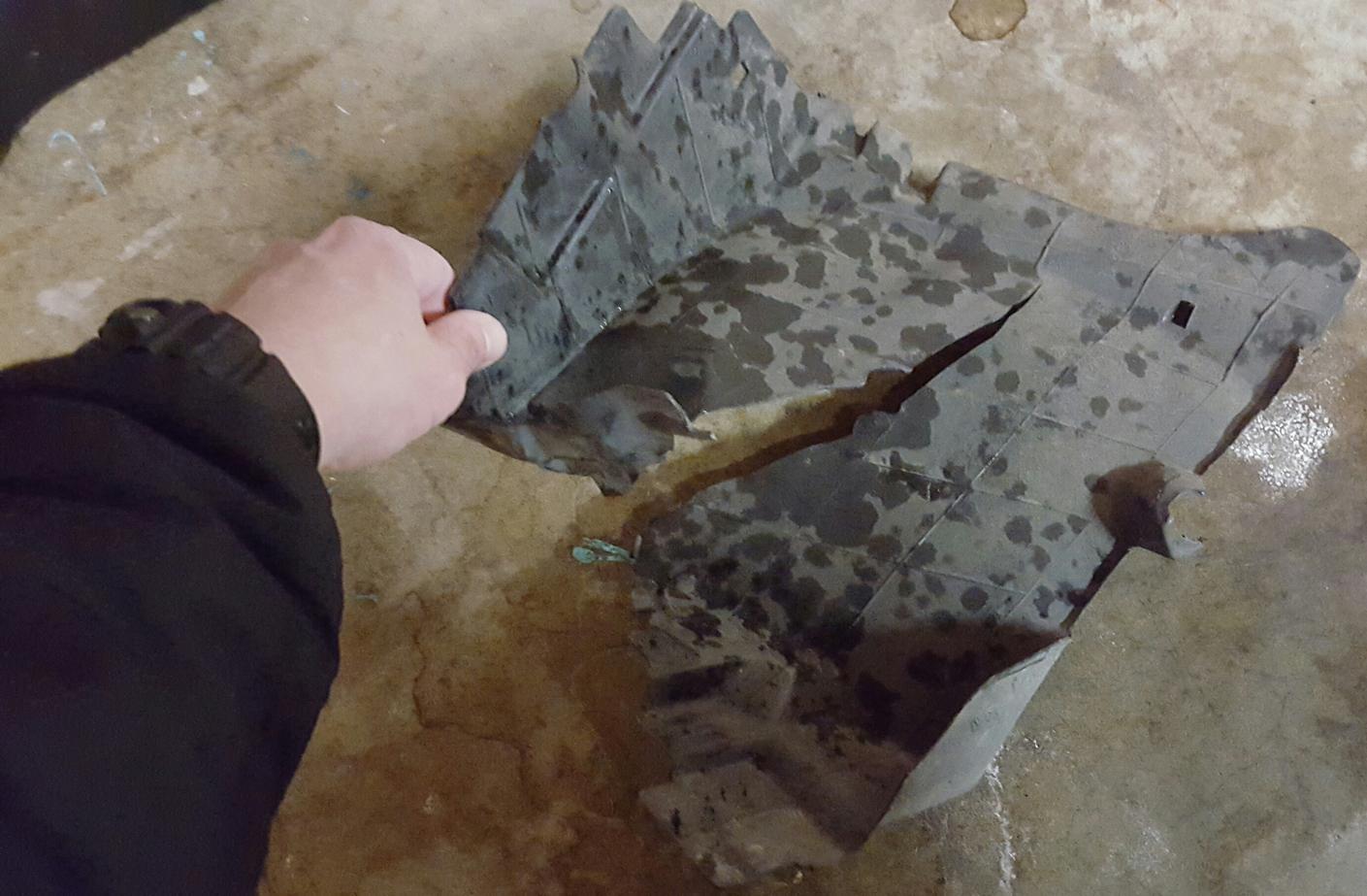

Bit of a newb question:
So after getting my SW front bumper on, I was left with extra wheel well trim that was no longer anchored to anything anymore.
Do you guys trim to suit? Or do you remove the front portions?
I had temporarily secured them out of the way with plastic ties, but they must have gotten loose the other day while driving on the highway. At first I thought it was just the wind blowing real hard, but then realized that the wheel well trim must have gotten loose. I got home and removed the front portion on the passenger side. This leave the some of the well and let's say the washer fluid reservoir unprotected.

I could be mistaken, but I don't remember taking anything off other than the bumper, crossmember and two tiny supports for the corners. If I took any inner fender off, it's cause it was attached to the bumper.
I trimmed mine and left about 3/4" or so around the usable anchor point. I replaced the crappy factory retaining pins with sturdy solid nylon plugs I have.
I also painted everything flat black behind the face of the bumper to blend. Very pleased how it turned out. There is also 2 or 4 brackets you can unbolt (I think it's 4 but I could be wrong) to clean it up some.
yea, The wind blowing the wheel well trim up against my DS tire was getting pretty annoying. LOL
I trimmed mine with the cutting wheel on my Dremel. Remember to wear goggles, those little pieces of hot plastic hurt in the eyeball.
